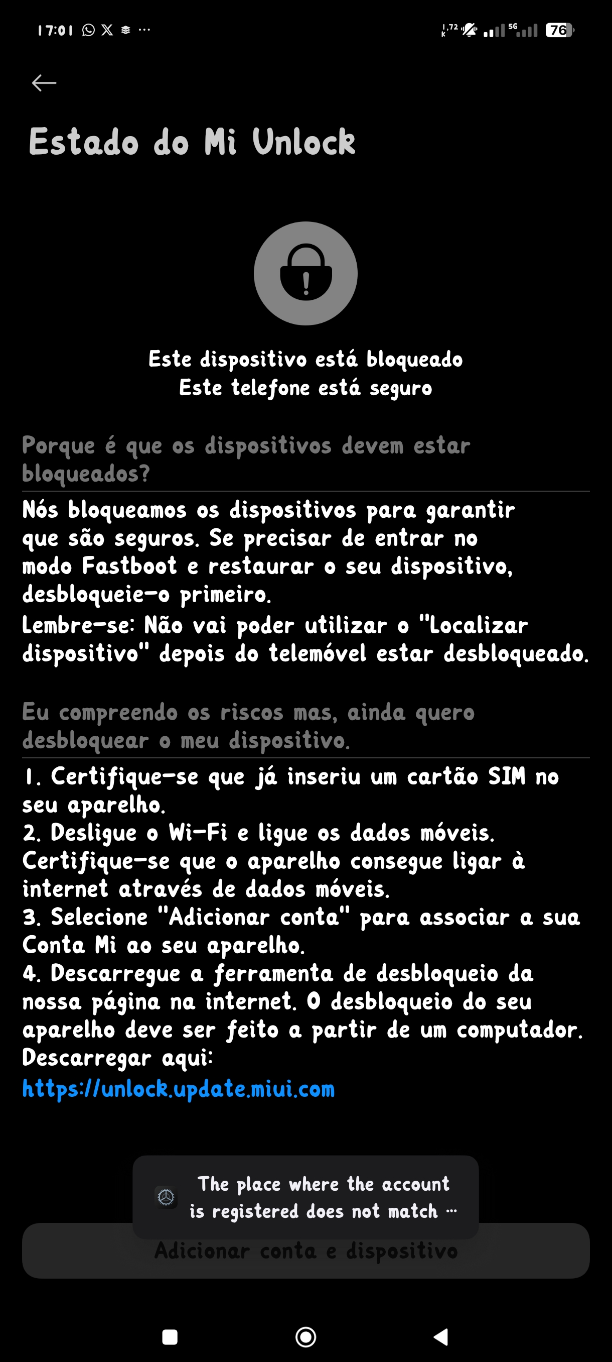

Só, I bought a redmi note 13 pro 5g and I was starting to notice that my phone didn't update then I discovered that the phone is converted from China to global etc normal history, so I was going to install a flash version is the global version 2.0.11.0 but I noticed that I had to unlock the boot loader I tough it was easy but then the problems started, I tried to unlock the bootloader and it was giving this mensage error "the place where the account is registered does not match.." I don't kwon how to get past this error mensage, I tried to create a China account but I need a Chinese number so I can't create a Chinese account. So I need some help how to get past this error bc my phone is starting to have security problems because of the version that is on it, if anyone kwons some way to bypass that please comment

You have no chance to unlock the Chinese version of the device if you are not Chinese. For you, it is now even more complicated. First, you have to install the Chinese ROM, then unlock the bootloader.
Here you have another problem. If you leave the bootloader unlocked, applications that require stronger security (GPay, Revolut, Banking, government, etc.) will not work for you.)
Or you can install the current modified Global ROM. This is done through some paid online service. (You will have to do this every time you want to update)
Bad idea to buy Chinese devices in the current situation.

Thank you ia There any vídeo on YouTube how to só that, and I don't really need any bank app, cuz I'm not that old I'm actually very young but thank you for that reminder it will help others too, but could you send a video how to install the chinese version and unlock the bootloader, I alerdy searched but I didn't find any video, thanks

Wait, to put the chinese rom back I need to unlock the bootloader to install the chinese rom or my phone is getting bricked, right??
You can't do it yourself at home, you don't have a chance. Xiaomi has blocked the unlocking of Chinese devices outside of China.
You have to use some online paid service for this (e.g. NCunlock and similar). It is paid.
You will pay for every step:
- update
- ROM change
- bootloader unlocking (if possible at all)
- update
- ROM change
