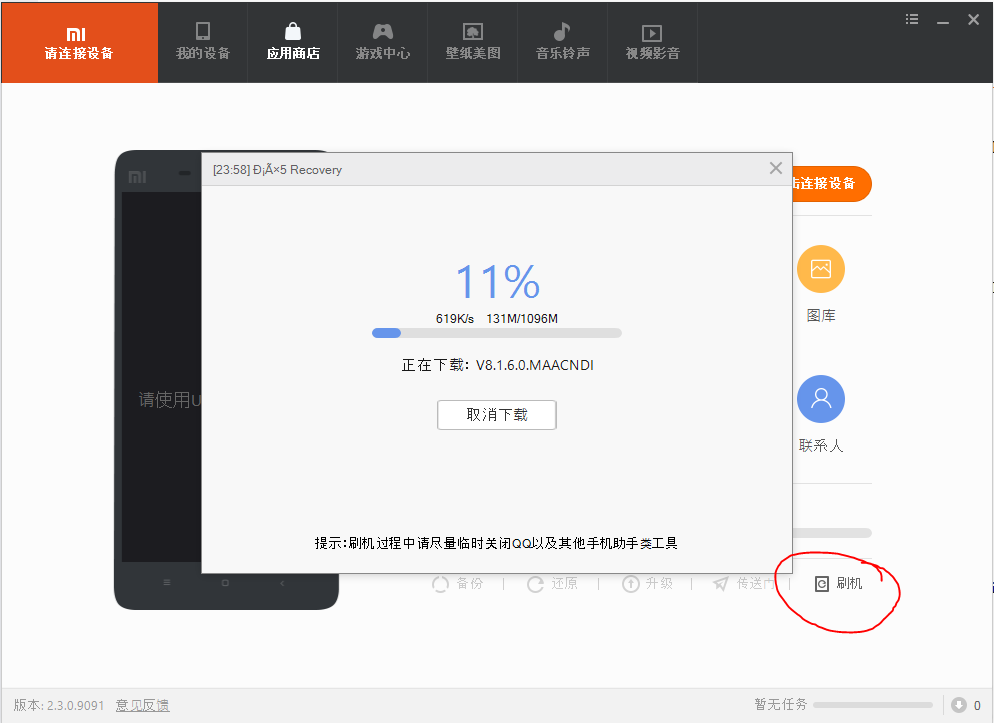

Great guide but I ran into a little problem, the chinese PC suite app auto updated. The button moved and the steps changed. I used OCR and google translate to work it out so am sharing for the rest.
Took a couple of screenshots which are attached to this post.
when you try to shift click it brings up a text box with the following options in order (I put this through google translate ):
联网下载刷机包 Brush package to download the Internet
选择本地刷机包 Select the local Brush package
清除数据 clear data
重启设备 Reboot the device
I tried selecting a local file but it failed, instead if trying to put more through the translator I just chose the first download option because it was easier.
Hope this helps someone. Enjoy!
