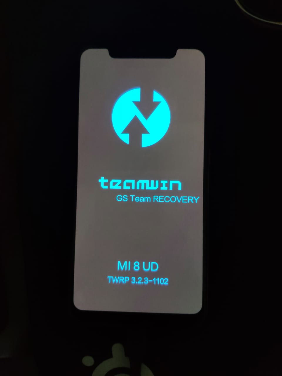

I downloaded this twrp, followed the steps that i mentioned before and occurred the same, I got stuck on twrp image :/. After install, my phone went into recevery and reboot again into recovery, is it normal??
Something interested is that i entered into recovery mode, because i can see my device and reboot it from adb, but it's stuck look the image

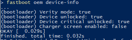

Adding more information about my last reply
fastboot oem device-info
(bootloader) Verity mode: true
(bootloader) Device unlocked: true
(bootloader) Device critical unlocked: true
(bootloader) Charger screen enabled: false
OKAY [ 0.029s]
finished. total time: 0.032s
OKAY [ 0.029s]

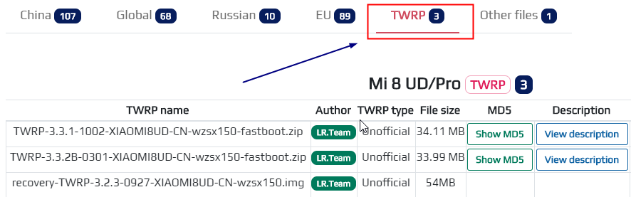

In the video I saw a lot of directories. Please try only one directory "hddc/adb". Put all the needed file in this directory.
Three twrp versions for MI8 Pro. Click on twrp…
31370
For download click on ... after you insert the capture
31371
Type "fastboot flash recovery twrp.img" put the twrp filename in the command and press "enter" (TWRP will be installed)
Disconnect the phone from the PC, hold the Power button as the screen goes blank immediately hold Volume + the TWRP splash screen will appear and disappear still hold the button when the TWRP splash screen appears a second time release Volume +. If Chinese language change to English. If TWRP will ask you the password (this means that there is DATA encryption)click on CANCEL and get to the main screen.
