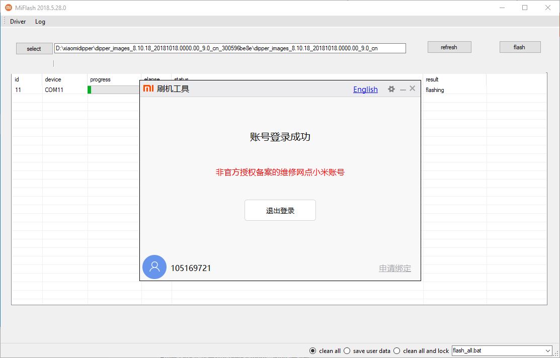

Finally I fixed my mi8 after paid CNY 160 to chinese xiaomi professional to have an official account to flash.
the reason which caused the black brick was that the downloaded file was corrupted (it may cause by the Free Download Manager or the anti-virus program) and the corrupted rom file activated Mi 8's Anti Rollback Mechanism, then black brick (9008 mode) the phone. We wouldn't do anything in this situation without Xiaomi's official intervention.
Since i'm living in Australia and i am a chinese. i had to go to taobao.com and searched and paid a professional by a Xiaomi official maintenance account to remote flash the phone from black brick.

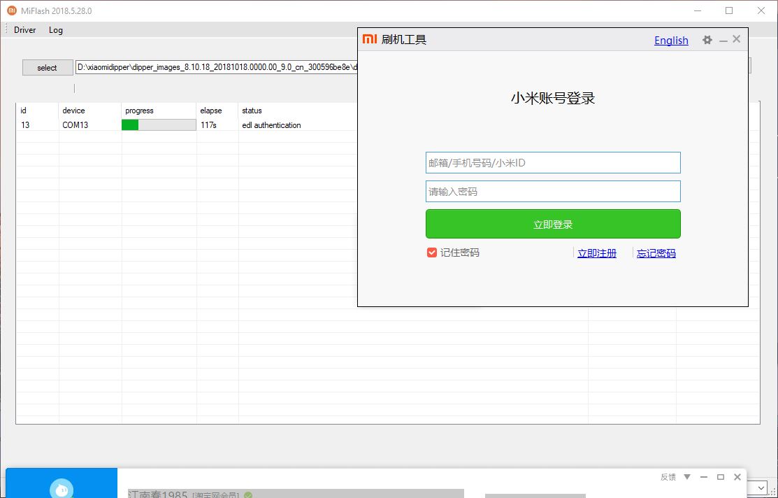

No. i had 8.10.12 xiaomi.eu Mi 8 rom in the phone. i download the 8.10.18 xiaomi.eu rom by Free Download Manager in a widnows PC. Then i copy the corrutped file to a USB-c flash drive. I inserted the flash drive to MI 8, flashed the corrupted rom and flashed magisk 17.2 and wiped cache/dalvik by using TWRP (L.R. TEAM 0908 version). Then the phone screen would not lighted up again, black brick. Phone connected to PC shown in 9008 mode. Miflash tool need an official maintenance account to flash.

Just attached my two screen shots for references.
