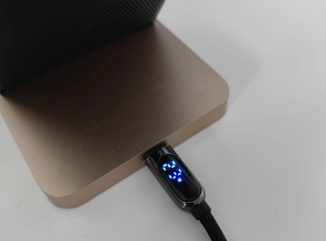

I have cable with power display and it shows maximum 25W when both using USB-C on the phone or Mi Wireless 55W charger...

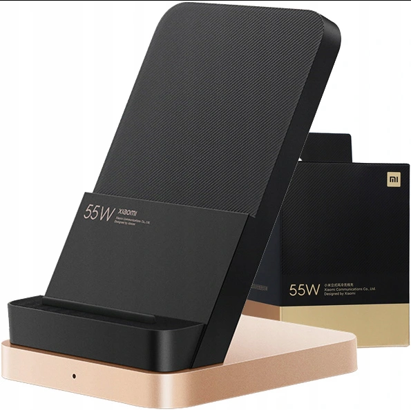

I am using this wireless charger and original 67W power supply...

I have cable with meter connected to the wireless charger and in peak it shows 25W, but this is still much less than 55W saying on the charger...

The charger u show is only 55w..... The new one is 80w comes with 120w power supply.
U try using 67w supply direct to the phone. It should be full speed.
Ok, but still shouldn't it be full 55W at some point and not only ~25W? Or at least 40W as this is what cable specification says:
And if I connect cable directly to my phone I don't get more than 25W too and the Xiaomi Power Supply says 67W...
Also, if I put my older Xiaomi Mi 10 on the wireless it gets ~25W maximum too...
