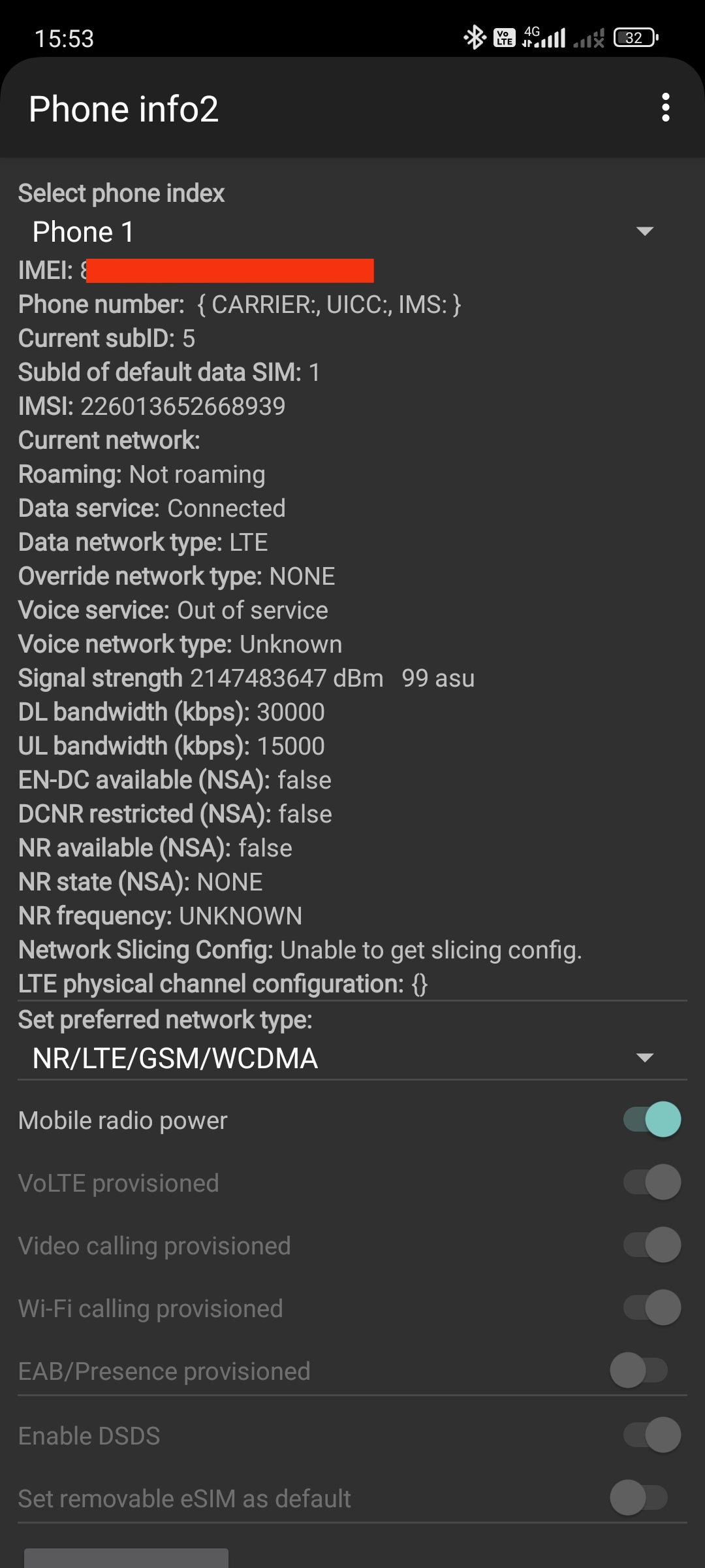

I have a Xiaomi 12x updated to hyperos 1.0.10 stable, since the update I have no signal on second sim. The sim works, tested in other phone. Also my main sim doesn't work in slot 2.
I flashed modem (non-hlos.bin) from global stable with no luck. I reseted network. No luck. Changed network type from settings and from phone info app, no luck. The sim is recognised but can't get a handshake from the network. I tried several working sims in slot 2 with the same result.
On MIUI14 stable I had no probs. The problem apeared when I updated to hyperos.
Her's phone 2 info
Any ideas please?

..unfortunately the same thing happened to me. I had to format and put version 1.09 (previous) and reinstall all the applications again. The worst part is that there was no correction for this version and I don't think it will come....

Sorry about that... I guess for now the only options are format and goback to miu stable or wait for hyperos 2 in January... Thanks for the replay.
I saw on the forums that mi14 devices had sort of the same problem with modem firmware and someone made a fix. I guess it's more than just the modem partition since i flashed that from global official and the problem persist...
