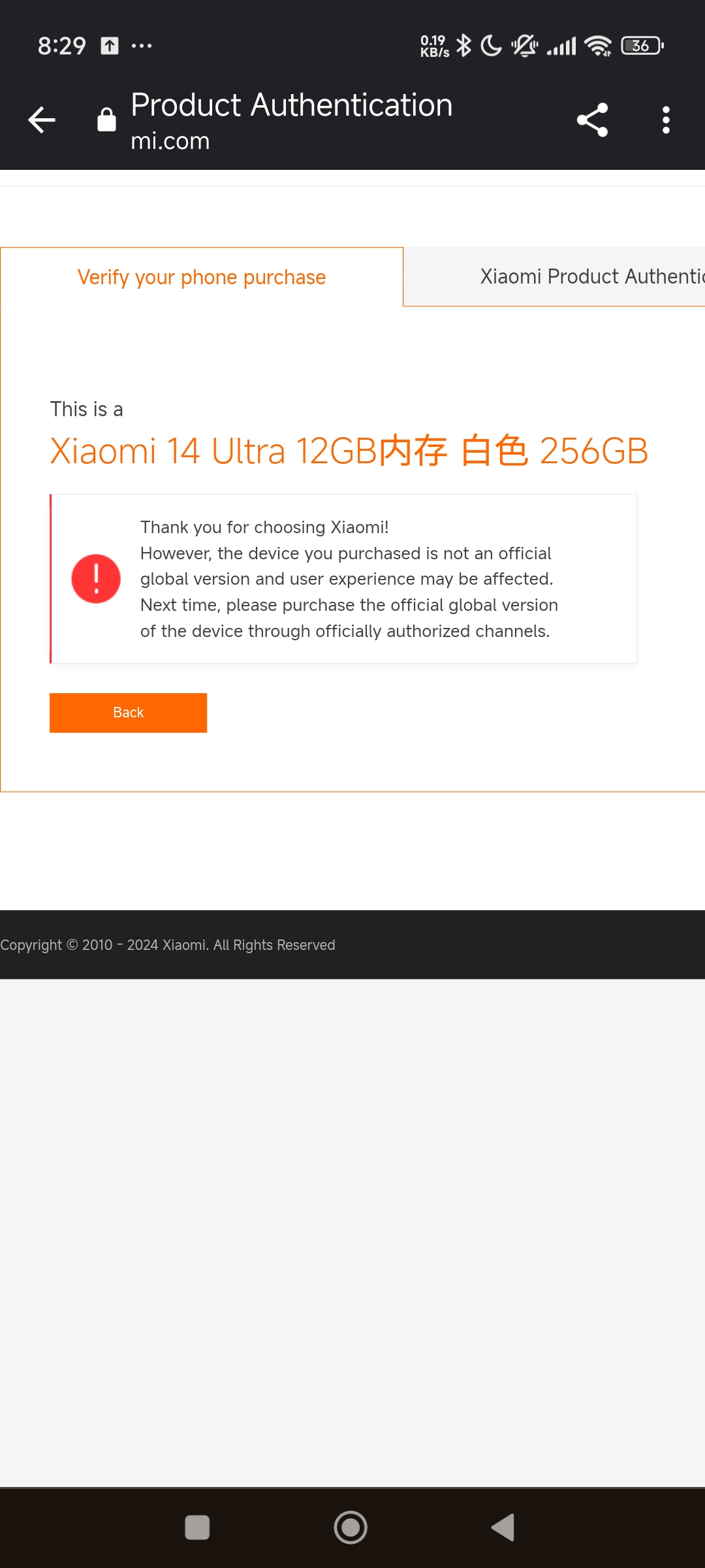

Have I been scammed and this isn't actually a global device? The device is locked/secured so I am not sure how that would be possible?
I would like to have the bootloader locked however would my best bet be unlocking it and installing a fastboot ROM then locking it again? I am just scared that it'll brick if I do it if it's not really a global device.

Welp I guess I am screwed.
How the hell can they install a global rom and lock the boot loader on a CN device?!?
The rom has been modified.
The only solution for you is to flash a Cn rom (edl mode) not free, then use a third party paid service for unlocking.
