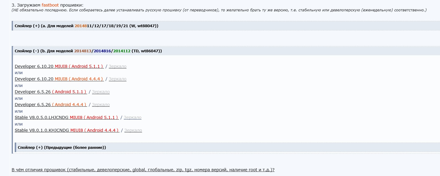

This is what I found on it about "wt86047":
The problem is that my device is an "Enhaced edition" different to the usual ones.
Could somebody confirm that one of the fastboot attached on picture are properly for my device?
. (If there is some doubt about my Redmi 2 device model, please tell me what do you need and I´ll provide it, because this is the origen of my problem)

Bzidroglio
Oct 9, 2016
17
As Krsv80 said, yours is a hm2014803 (as you read under your battery) so you have to use the wt86047 rom.

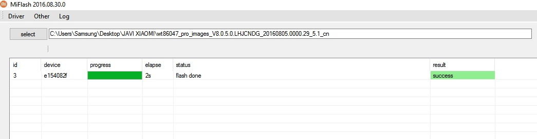

I have just downloaded "Stable V8.0.5.0. LHJCNDG MIUI8 (Android 5.1.1) from my model wt86047" to fastboot my device via Mi Flash.
1 . I put my device in fastboot mode (Vol- + Power on)
2. I have flashed via MI Flash with the fastboot that I downloaded
3. It seems that is ok because of the progress and the result is ok as you can see at picture below:
4. My device is still broken, in the same situation, with the typical fastboot screen
5. I turn off my device and then when I turn on again the MI logo appears twice and then the recovery mode 2.0.1
6. I reboot to system and ..... the same MI logo twice and the recovery mode....
What´s wrong?, I don´t understand
Could you help me?
Thanks in advance
Bzidroglio
Oct 9, 2016
17
It took 2 seconds to flash? Something went wrong.
How big is the file you downloaded?
Download the ROM again and/or try with a different miflash version.
