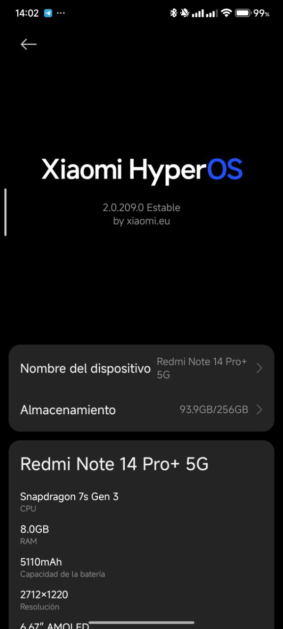

Hello friends,
I have the Redmi Note 14 Pro+ 5G (Amethyst), model 24115RA8EG.
I downloaded and installed the ROM: xiaomi.eu_AMETHYST_OS2.0.11.0.VOPCNXM_15.zip.
First issue: I had no network signal, so I had to download the global stock ROM, find the modem file, and flash it via fastboot.
It seems to have worked, but I haven’t confirmed if I have 5G coverage.

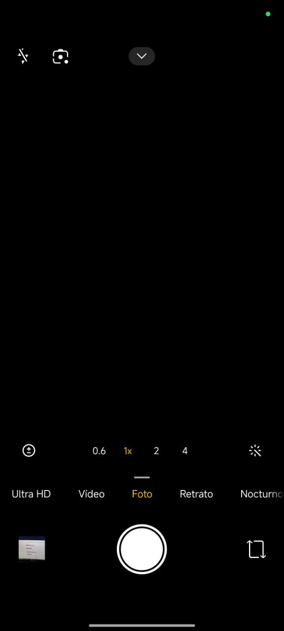

Second issue: The camera app doesn’t work—after granting permissions, it just crashes.
The same thing happens with G_Cam and other alternatives. It seems like something is wrong with the driver. PLEASE HELP.

Ooh, my bad. The available modem is a fairly good fix but it's causing audio skipping in all audio apps and files. Not sure if it's only me experiencing this with the latest update.
You can try the current global modem. I have no idea how it will work. I have no way to test it.
This fixes it all; Network, Camera & Audio all working just fine. Thank you so much for helping out.
