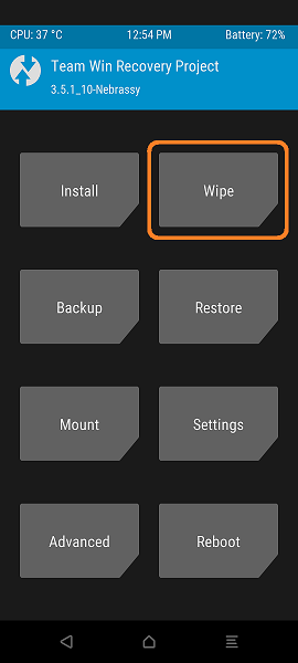

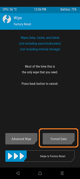

hello all,
I have unlocked my MI 11 Pro (China version) and flashed TWRP 3.5.1-star. Everything went well. When trying to flash the ROM xiaomi.eu_multi_MI11Pro_MI11Ultra_V12.5.20.0.RKACNXM_v12-11 I ended up in the fastboot loop. Nothing works any more.
What else can I try?
Many thanks in advance!

a big thank you to you, i will try this. and I should do it again with every update? in fact I ask because I have more than 60 gigabytes of music each time to put back in the device
Only need to format data after a branch change of ROM. If it's a TWRP update, just Wipe dalvik cache after update. If it's fastboot update, don't worry.
