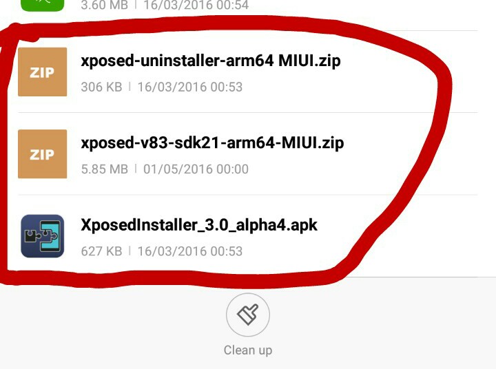

You need flash the framework and install the apk. No need to wipe anything. Reflash the framework everytime you update the rom.
Since I'm in a developer I just need to install the apk right? What about wipe? How it works when updating the rom. Do you need to reinstall every time right?

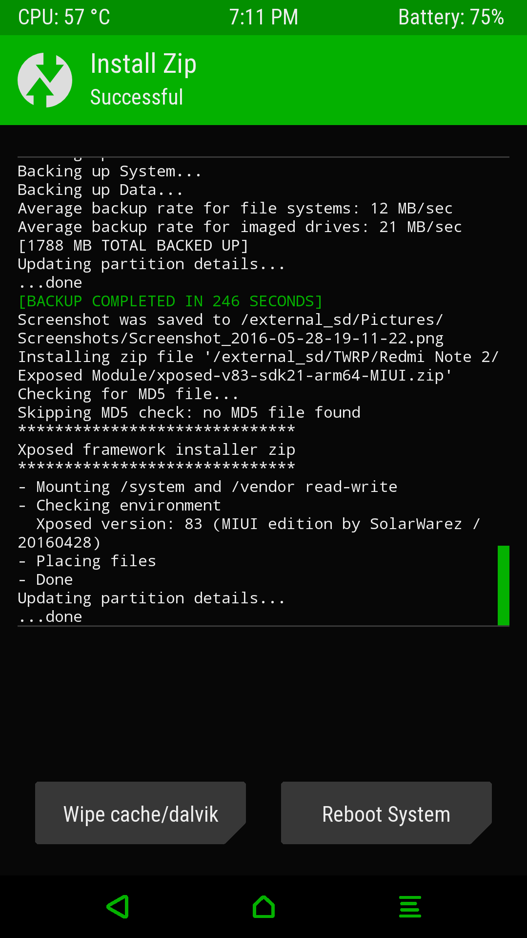

My suggestion, before you flash xposed framework, you need to backup on twrp (boot+system+nvram+data), make sure you also got uninstaller xposed (once you got bootloop, just flash it.) :D
After that you can flash xposed framework, wait untill finish & wipe cache+dalvik then reboot system. Wait the process, make sure you have enough battery. :D

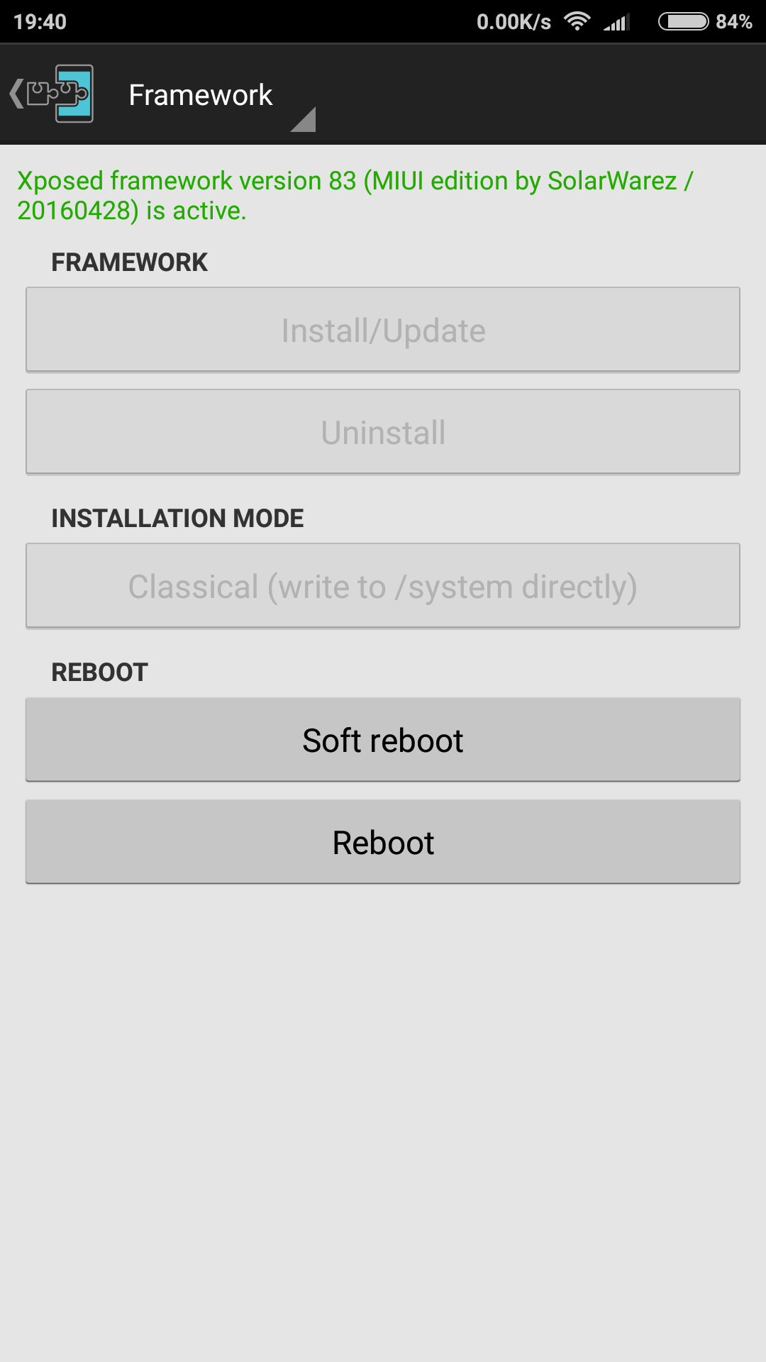

After on main menu, then install apk exposed installer, and bind your module. Done.dwyor

So, recovery flash zip
wipe cache and dalvik
Reboot to system then
Install the .apk

Any recommended modules? I've installed memory leak as seen in the photos and mi desktop tools, thx
Enviado desde mi GT-P3110 mediante Tapatalk
for battery life, install amplify, greenify, power nap. you can look the other modules from xposed installer.
