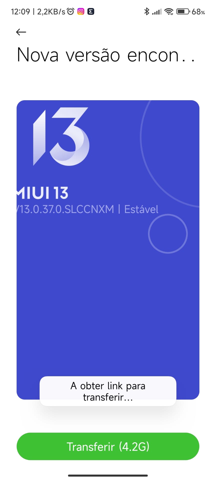

Good afternoon, I installed this ROM .eu and now I have difficulties in the update. How can I do it ?
Error getting the link.

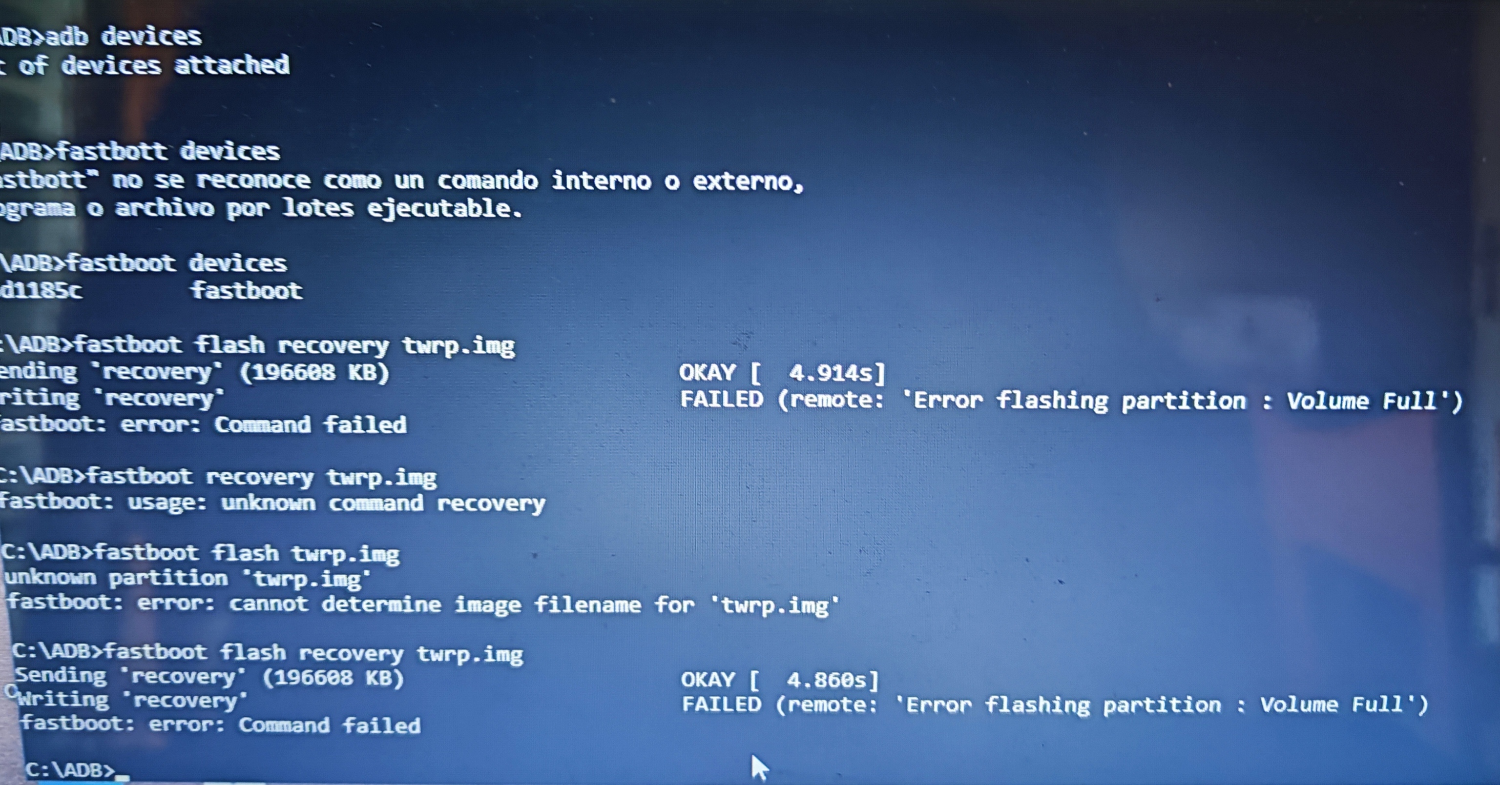

Sorry I couldn't answer until today, I did everything according to the tutorial and I don't know what I'm doing wrong but I always get an error.
Sorry I couldn't answer until today, I did everything according to the tutorial and I don't know what I'm doing wrong but I always get an error.View attachment 43526
which device and which twrp? it seems you have a wrong twrp or A/B device or both :)
Boot and install TWRP / ROM on A/B device
- type "fastboot.exe boot twrp.img" (without "")
BOOT / REC TWRP for some devices
For some devices there are different TWRPs available
1.) BOOT-TWRP -> fastboot boot twrp - boot TWRP only
2.) REC-TWRP -> fastboot flash recovery_ab twrp.img - install TWRP permanent
3.) BOOT-REC-TWRP -> you can use both fastboot commands -> see 1.) & 2.)
