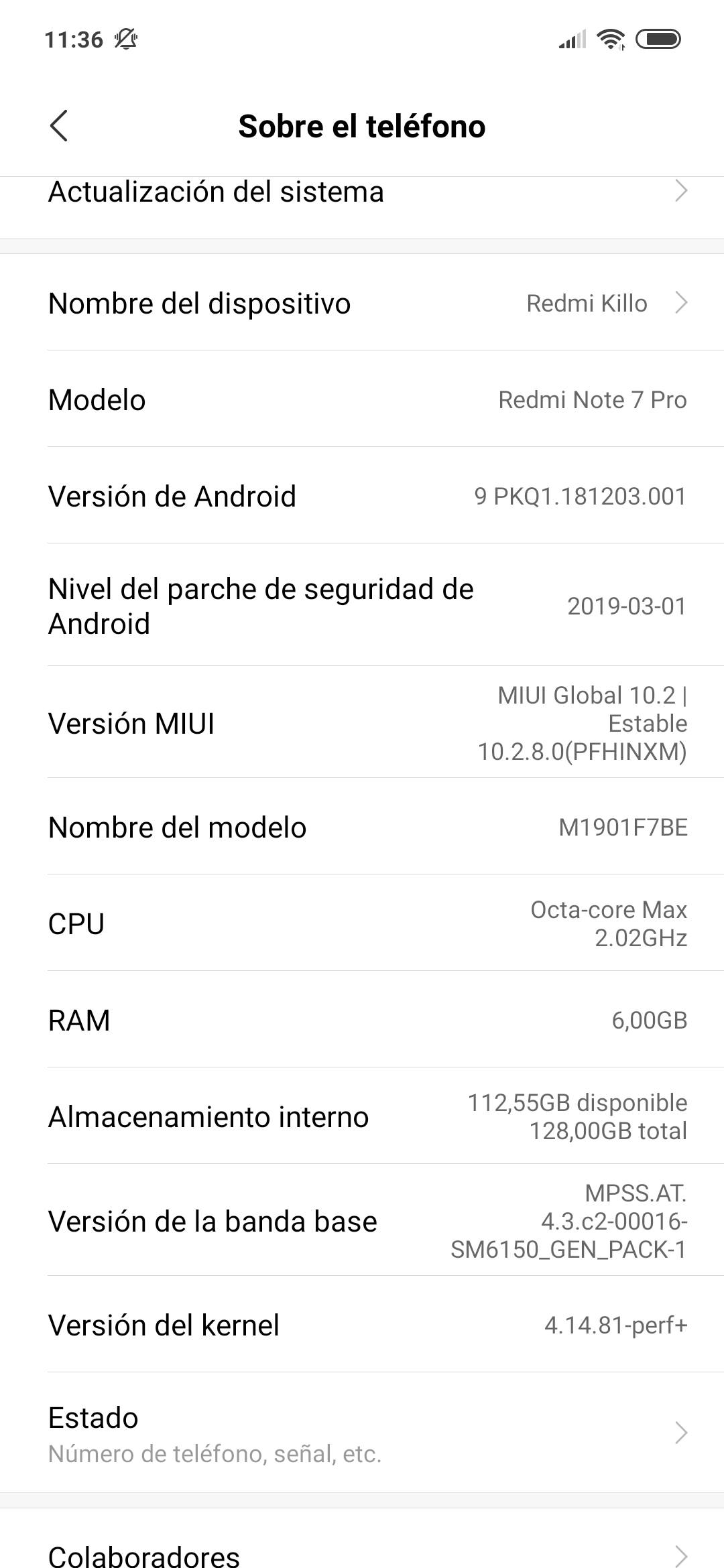

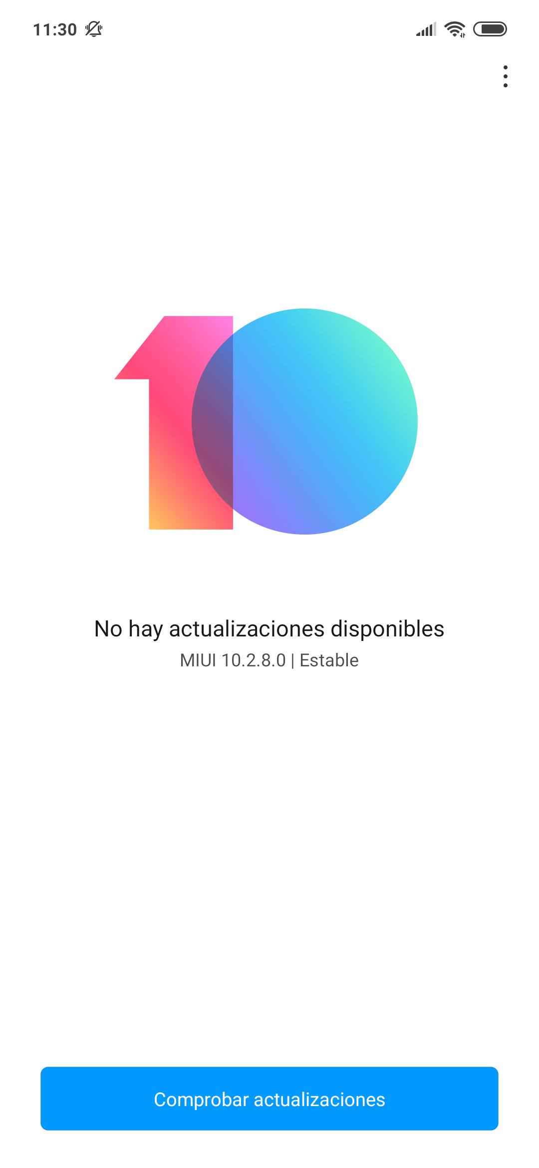

I already did, and installed the global violet rom_indi using the PC and My Flash.exe, everything is perfect, it's fine, but it does not have the dark mode, but everything is perfect and has almost all languages. the perfect coverage and 4G in Spain , has the google and the Play store integrated and running

I had to wait 360 hours and then with the phone in Fastboot mode and on the PC with My Flash.exe, install Rom_in_Global in my Redmi Note 7 Pro Chinese and everything works very well,
since another method failed me in TWRP and doing it could not,
and it worked only with My Flash.exe
I'm sorry for my English, I'm with the Google translator. Sorry
