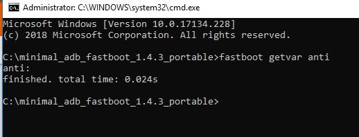

run this command
fastboot getvar anti
If 3 you are safe and can roll back to previous versions of firmware
If 4 that rollback of firmware can lead to "brick"
run this command
How to run this command? any files/tools needed?
Thanks for your help
you have no anti rollback, so you can flash anything but if you flash a xiaomi china firmware you will not be able to downgrade again

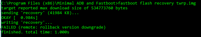

please let me know what twrp did you install? (for Redmi 6 pro)
i install twrp.img (3.2.3) but not yet
(target reported max download size of 534773760 bytes
sending 'recovery' (13028 KB)...
OKAY [ 0.315s]
writing 'recovery'...
FAILED (remote: rollback version downgrade)
finished. total time: 0.340s)
what do i need to install Twrp ( my redmi 6 pro is unlocked)
Thanks.

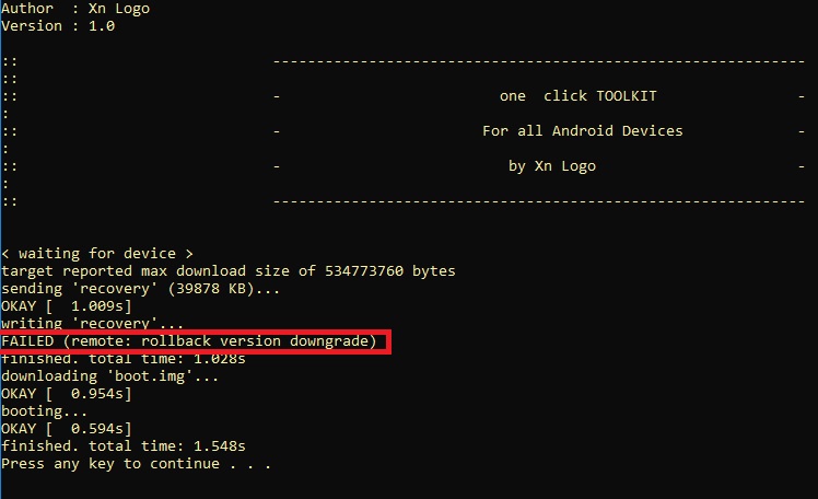

Hi, I've got a Redmi 6 Pro, with the stable ROM from china v.10.2.3, and when I tried to flash the fastboot.
I obtain this :
24189
What ca I do?

Hi, don't flash twrp right away from your pc Try these steps:
1. boot into the twrp directly (fastboot boot twrp.img)
2. Wipe data (do this first)
3. Advanced wipe (wipe all entries except the last two items)
4. Mount the redmi and transfer the twrp onto the phone
5. Flash the .img files directly from within twrp, make sure to choose "recovery"
6. Reboot into twrp
then from there mount the phone again and transfer the ROM.zip of your choice, install and reboot.
