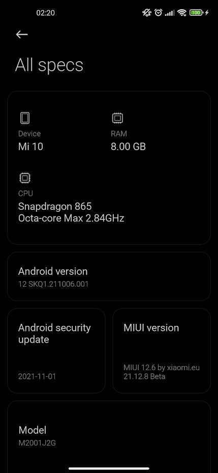

Hello i will try to explane in few lines how to get working twrp on latest dev version on android 12. ONLY TESTED ON MI 10 UMI !!!!

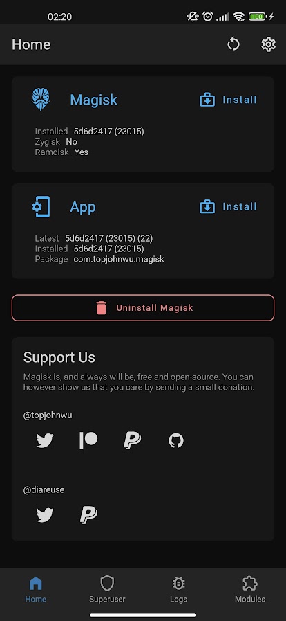

- Go to Advanced and click "Install Magisk Alpha"
- Reboot in normal mode (to system OS)

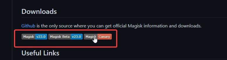

- Download & install magisk canary manager apk DOWNLOAD
- Open new installed apk
- U shoud have now old twrp version show in magisk
- Open magisk options and change to canary update channel
- Go back to main magisk screen
- U shoud have update button for new magisk version. click it
- Choose direct install (Recommended)
