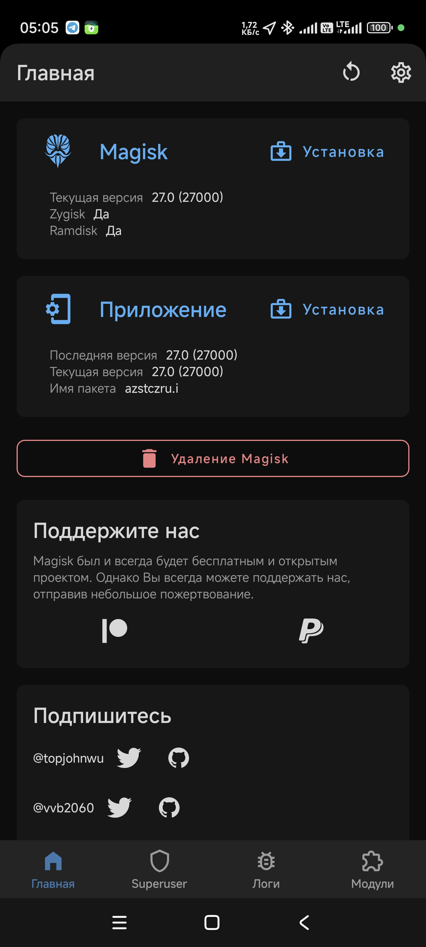

- Next I wanted to root my device
- so I copied over the ROM file to my Mi 14 Pro,
- extracted the boot image and patched it with the latest Magisk canary version
- then copied the patched file back to PC
- Into fastboot and then copied patched boot image onto both Partitions A/B
- Then reboot into system and start Magisk to complete the installation...
- But when I open it, then it doesn't show root on the system, just the installed app.
- So I tried to install the magisk,zip via TWRP and tadaaaaa "ass ****ed" because TRWP doesn't decrypt my partitions..
So I don't have root right now,
because the fastboot method somehow fails
and the TRWP method won't work until the mighty devs have solved the decryption issue
