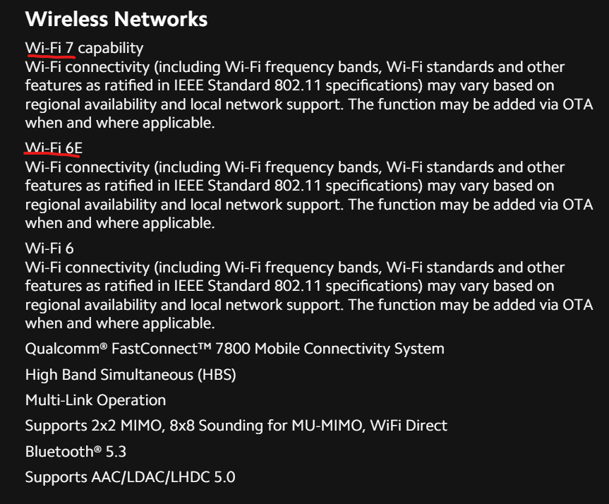

Information available is a bit unclear, on the chinese page you can find references where it states 2.4/5G frequency bands for Wifi, whereas the information for the global device is a you stated above - so without any direct mentioning of frequency bands. But as the global version varies from the CN version in radio bands I wouldn't dismiss the thought that Wifi bands can be different as well.

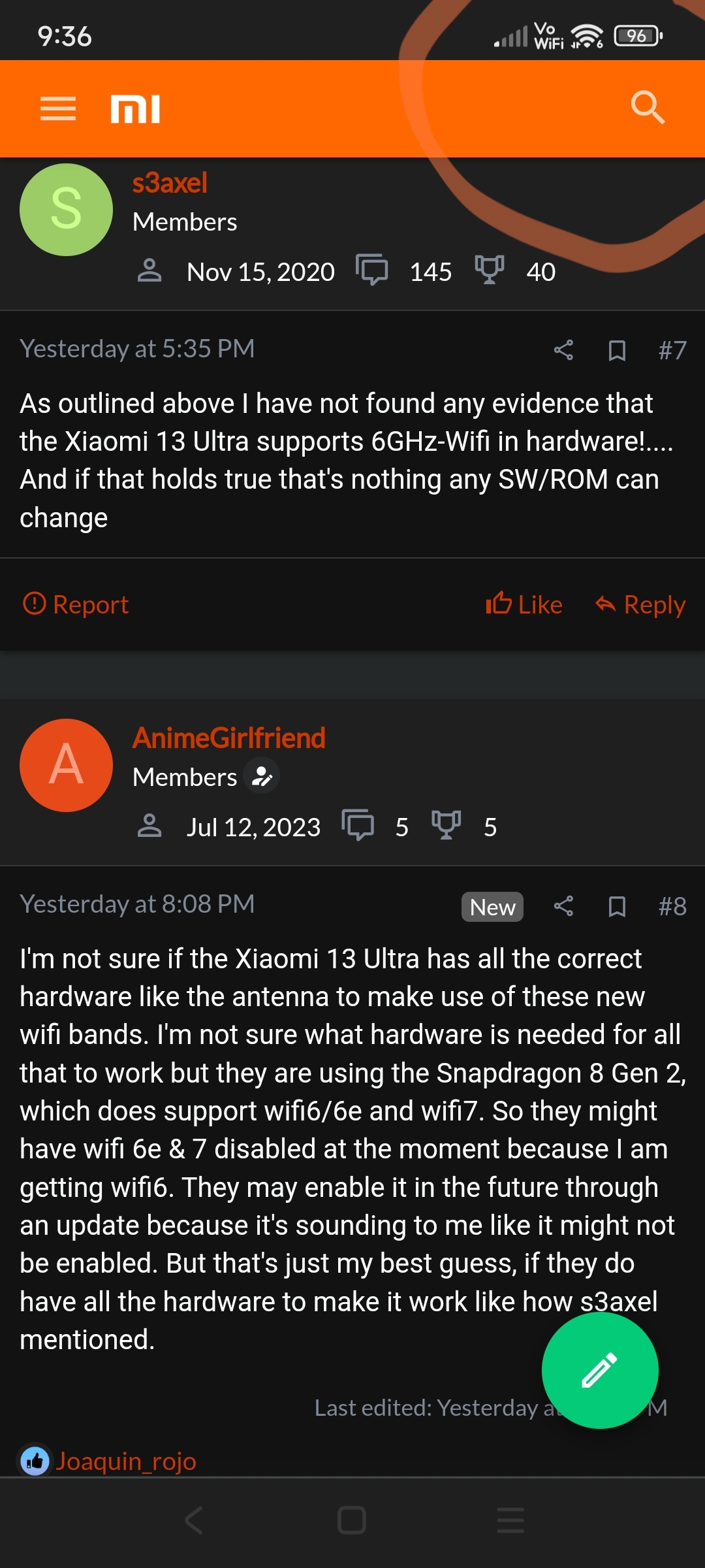

As outlined above I have not found any evidence that the Xiaomi 13 Ultra supports 6GHz-Wifi in hardware!.... And if that holds true that's nothing any SW/ROM can change
I'm not sure if the Xiaomi 13 Ultra has all the correct hardware like the antenna to make use of these new wifi bands. I'm not sure what hardware is needed for all that to work but they are using the Snapdragon 8 Gen 2, which does support wifi6/6e and wifi7. So they might have wifi 6e & 7 disabled at the moment because I am getting wifi6. They may enable it in the future through an update because it's sounding to me like it might not be enabled. But that's just my best guess, if they do have all the hardware to make it work like how s3axel mentioned.
