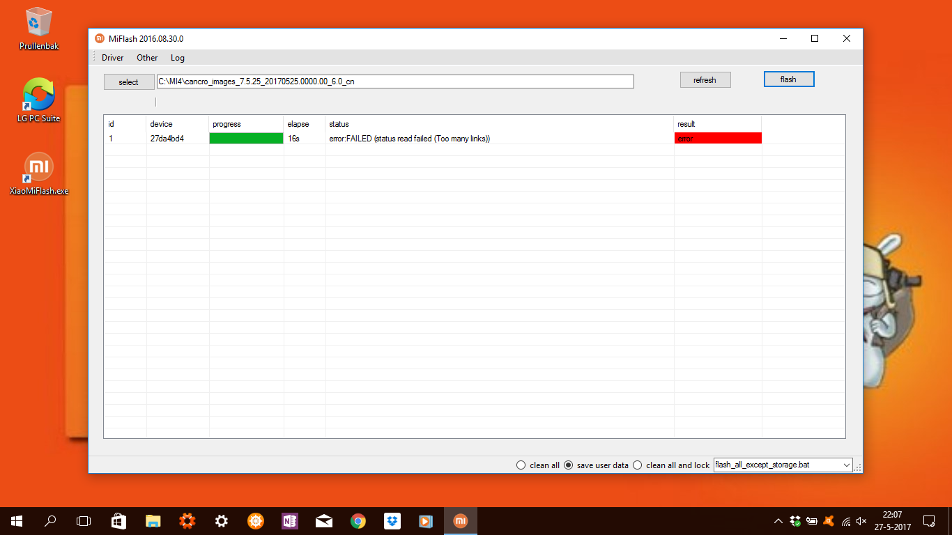

Hello, I also have problems with flashing. Mi4 LTE is in bootloop. Recovery and fastboot are not working. When i try to flash latest fastboot china dev rom i will get error:
Somebody can tell me what to do?

Bad battery can cause weird problems, including flashing errors or flash seems to go ok, but nothing gets written.
I think it' the connection with the battery. I tried a new one. I think it's not charging. The little led down in the middle lights up a few times red. The Mi4 stays in a bootloop. But how can i make this work?
Can you get it to EDL mode?
http://en.miui.com/forum.php?mod=viewthread&tid=194864&page=1#pid4932111
I think it should go EDL with: power and USB cable off, hold down both volumes, connect USB cable and release buttons. Qualcomm port should come to Windows Device Manager under Ports. MiFlash can write fastboot images in EDL mode.
I tried your way and "adb reboot edl".
But no device found in windows command. No edl mode.
Flashing still not succeeded.
What can i do?
Thanks Pertti for your help. I sure will try this too. I hope i can get the device in edl mode. Because the device will not stay in fastboot mode. Everytime it gets out of it because of the loop it's in. The strange thing however is that MiFlash recognize the device, but my laptop does not in windows cmd screen.
The device is in Mi logo loop, does not stay in fastboot mode, nore recovery (twrp) mode and the little led (charger) is flickering in red.
Story continues....
I will let you know again
Alex
If boot loop is about 10 seconds all the time, could be faulty power button.
I had this problem before with a Mi3 after dismantling and putting together again. The powerbutton got stuck somehow.
A screen + frame + backcover were already delivered, so i am going to build this Mi4 up and see what happens. I think you're right. And hope so.
Tomorrow i will start with it. Don't know when it is finisbed, but i will let you know.
Thanks again my friend.
Alex
It was a problem with power button and charger as well. I used this parts from a working Mi4 and then all worked. So i flashed the fastboot rom with succes, installed TWRP and installed latest MUI. It's fine now.
