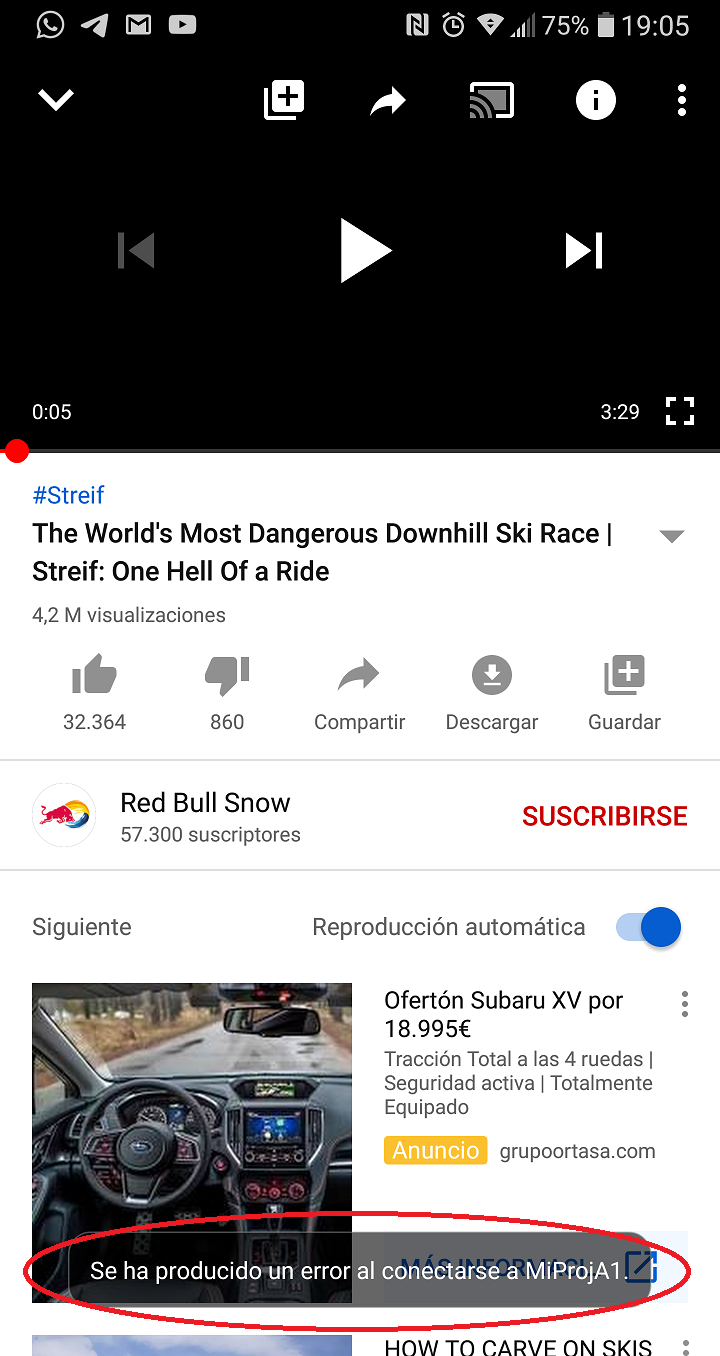

  • I can't send videos to YouTube. Before the update, whenever I was using the projector (regardless of which application I was using), I could send a video that was playing on YouTube through "Send my screen
    i8lMRrK5my6vEqF0C1oCJpypX_i0xKQfseGokF-fKHrsGI46ilohrcPrQC36jcKpoV4=w20
    " from my mobile. Now even beeing in the projector's own YouTube app, I can't send from my mobile. I get an error while trying.

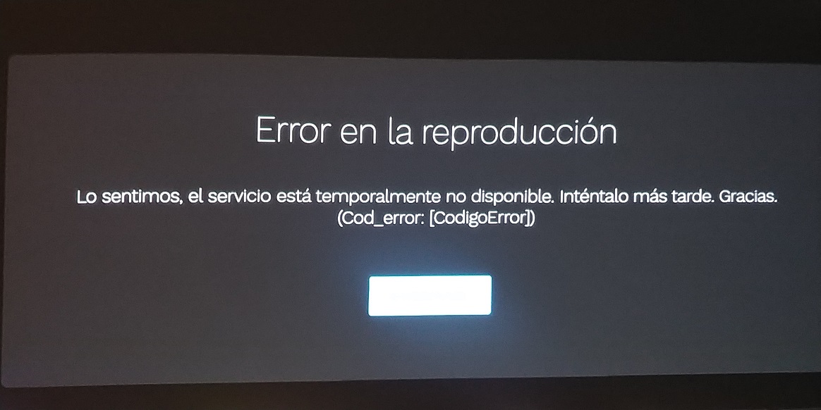

  • The Movistar + app has stopped working correctly. As soon as I try to play any program, I get an error that prevents me. I can navigate through it, without problems, but I can not watch any videos, except advertising.

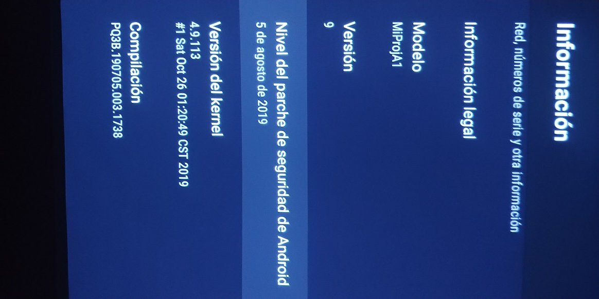

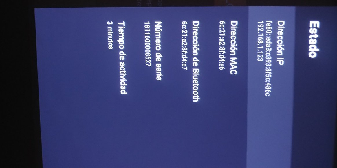

I attach images of the errors that occur in each case and the data of my projector, as well as the current version of the Operating System. Sorry to ignore which one was the previous one.

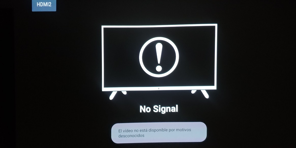

Yesterday, I made a reset and the first problem was solved (youtube), but the second is still happen and another one as critical have occured: Now all the HDMI sources doesn't work.

I have the same problem: HDMI ports stopped working after doing a factory reset with the android 9 firmware.

Patch installed still problems with hdmi

My mi laser global version anglee was automatically updated to Android version 9 buil 2021 on July 15th.
On previous version 8.1 everything was fine. Now but now on v9 I have the issue on hdmi that did not find signal.
It may have been fixed on build 2020 early this year but the new version build 2021 still has the problem.
A lot of other user have the same issue on other forums.
Hello, I was very happy with the Xiaomi mijia alpd 3.0
projector. I watch everything via HDMI input. Since yesterday this is no longer possible. No signal via Hdmi 1 and Hdmi 2. I tried new HDMI cables and again no signal. I need help to fix this because I can't take advantage of this. I bought the projector with a 1 year warranty. I'm asking for help because I don't know what to do now. Greetings from Switzerland and thank you.
