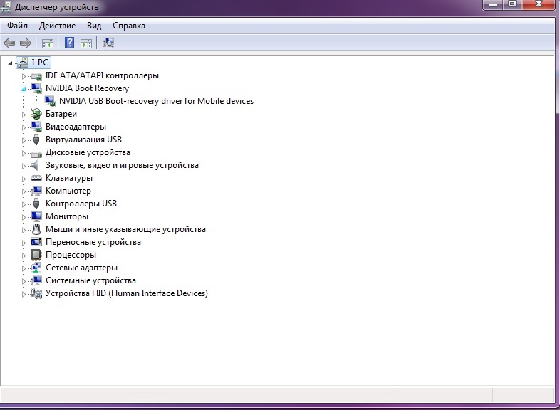

What to do?
Device Manager:
NVIDIA USB Boot-recovery driver for Mobile devices
Nvflash started
uid read failed
on device flash red led.
no recovery, no fastboot...black screen only.
nothing I can do((((((((

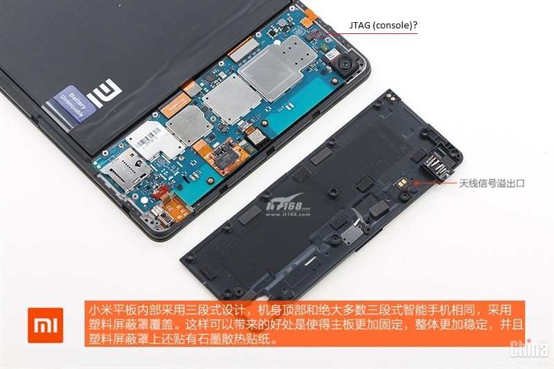

Could you explain what you were trying to do? One does not simply change a bootloader
Did you update the bootloader to a newer version or did you replaced your bootloader by another one (not Xiaomi MiPad)?
If the last one is the case there won't be no way to restore your MiPad without a JTAG.

and as you can dd if=bootloader.bin of=/dev/bus/1/usb/14 ???
there are instructions for JTAG?

If you get any connection with your device dd could be working.
JTAG is a device that can flash your device without a bootloader.
The thing is that getting a JTAG is not easy, Xiaomi will probably use it if you send it for repair.

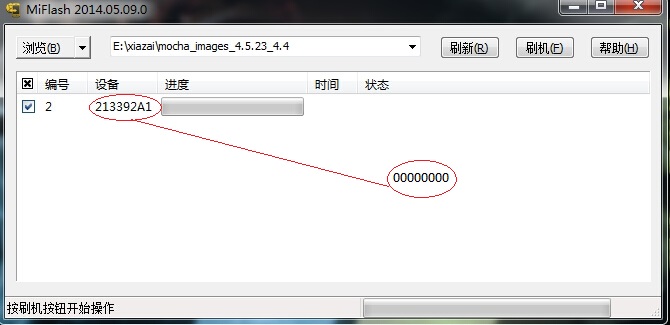

I installed WSM Tools. it was possible to leave everything as usual(/system)...about you cwm something like this, I chose. it was a warning brick, after a reboot it stopped...to enter fastboot, recovery and invisible in the system until charged the battery, if you disable the battery it is seen as NVIDIA USB Boot-recovery driver for Mobile devices(a few seconds) miflash it sees and all 0000000.

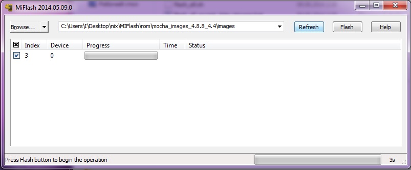

I will try. Thank you. But not sure something will work out . never sets in fastboot mode. but miflash see it , the only cannot nothing to send, writes "device busy")
that is something like

Hurm, maybe similar to me. I tried the Miphone software. It did not recognise my mipad until i change to generic android driver and then it recognised by it cannot flash the rom to the mipad.
What did i do is that boot to fastboot, extract all the fastboot version of the rom, and double click the flash.bat, and the rest..my mipad boot again.
Try to change to generic usb driver if it help...
