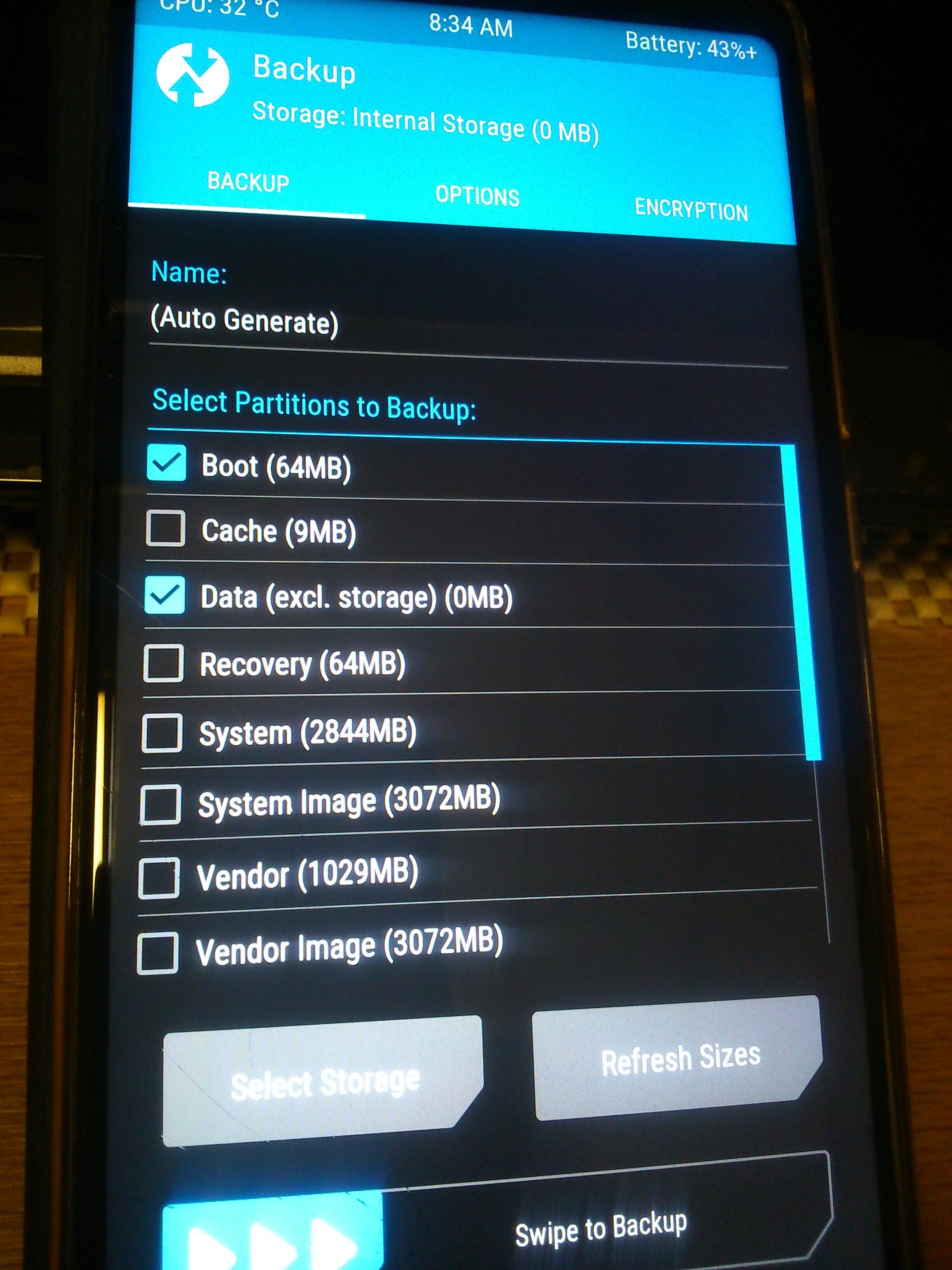

Thx Poney70.i have TWRP on screen.i didnt choose READ ONLY of course..But when i want chose storage internal storage 0mb...Dont see my internal storage unfortunatelly.Pls advice.And what to chose for nandroid backup?thx

You can keep system read-only in TWRP, no issue to install ROMs or create backups. ;)
This choice is not crucial at all. :)
