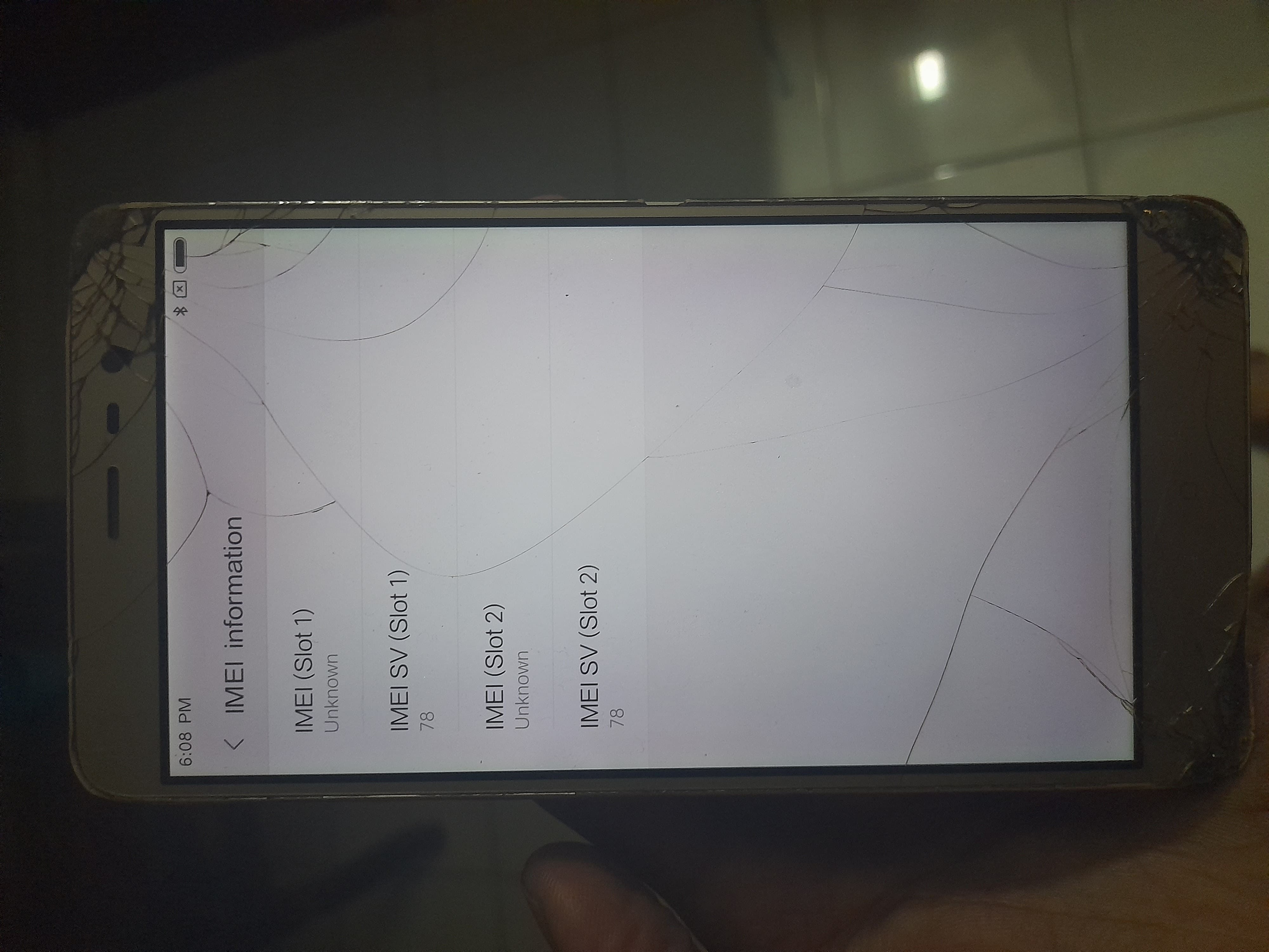

Greetings friend, not to make the story too long, I've been trying to solve the same problem for a little over a month, I don't know what to do anymore.It won't let me unlock the bootloader in the official way, I have tried everything officially. Using the brom method, it doesn't work for me. After a system wipe using TWRP it happened. I lost the IMEI of the 2 ports, as well as a problem of NV RAM on the WiFi, everything else works fine. I hope you can help me, honestly I am about to turn the mobile into a mass of particles against the ground, although I need it.
