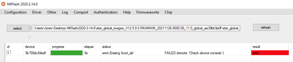

i try to install firmware or rom with miflash butin first i have the error message device missmatch.
I modify the batch file for skip this error and after i have many others errors status error on each step, screenshot under.

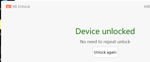

My device is unlocked.

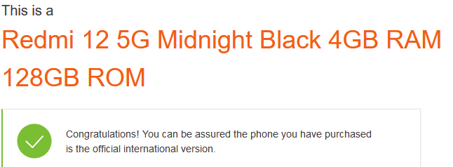

When i search a rom here https://xiaomistockrom.com i see only for sunstone device, but my device is river.

You are trying to install a ROM designed for Xiaomi 11 Ultra (star). You can't do that.
You must use a ROM that is intended for your device!
Show the full name of the MIUI version you have on your device.

my device is a river, i find this information with fastboot instruction fastboot getvar product.
Have you other method to find this ?
I try to flash with other rom because i don't find a rom for river and for the moment i have only the fastboot mode nothing else :(

Works fine with the good ROM, thx
Extract from flash_all_lock.bat : fastboot %* getvar product 2>&1 | findstr /r /c:"^product: *sky" /c:"^product: *river"...
