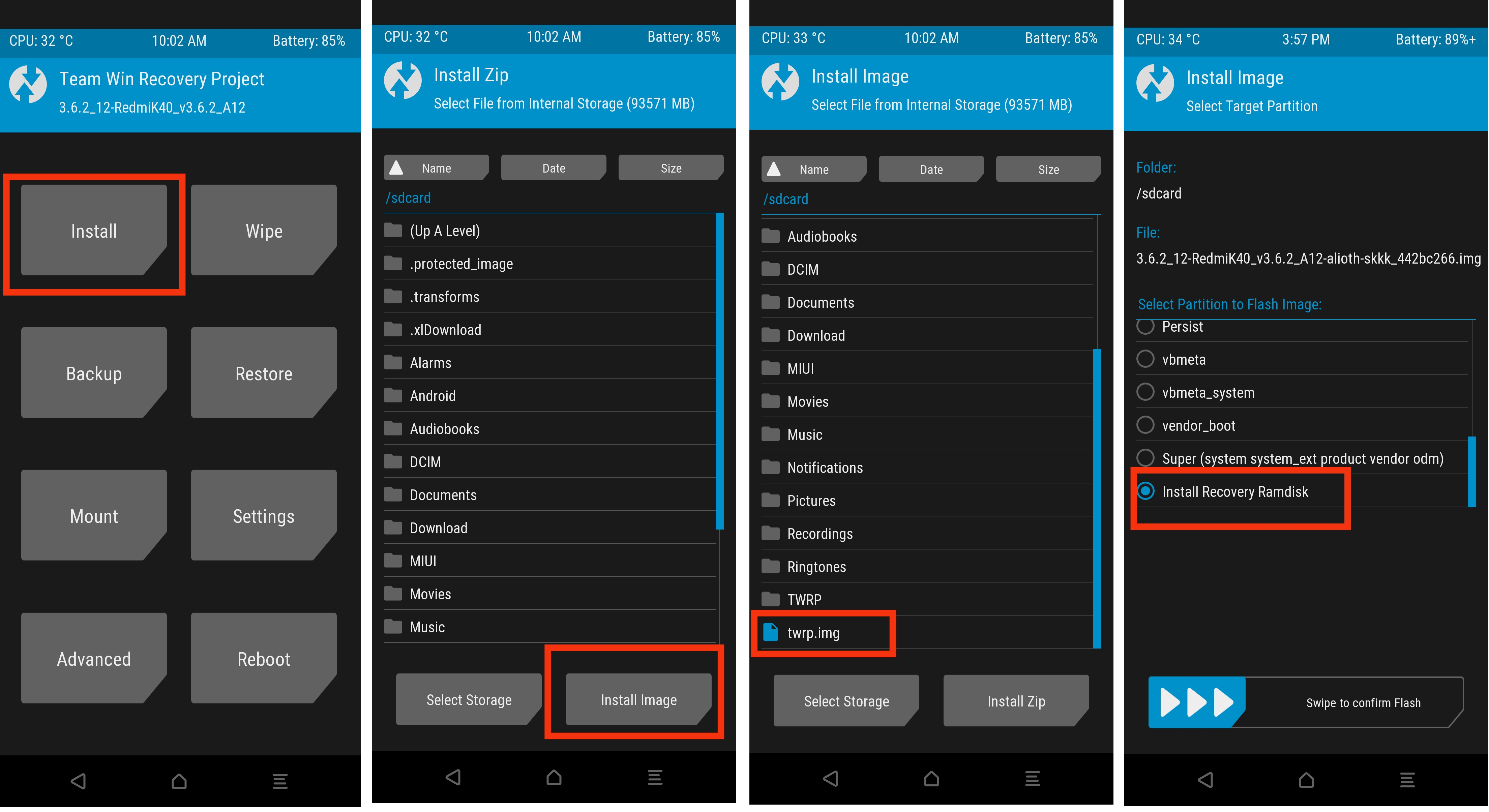

You do not need to Format Data.This procedure only applies to models with A/B partitions.
Rename the downloaded TWRP to twrp.img
1. run TWRP using the fastboot command:
Code:
fastboot boot twrp.img
3. Install
4. Install the image
5. Install Recovery Ramdisk
6. reboot to recovery
7. reboot to systém
