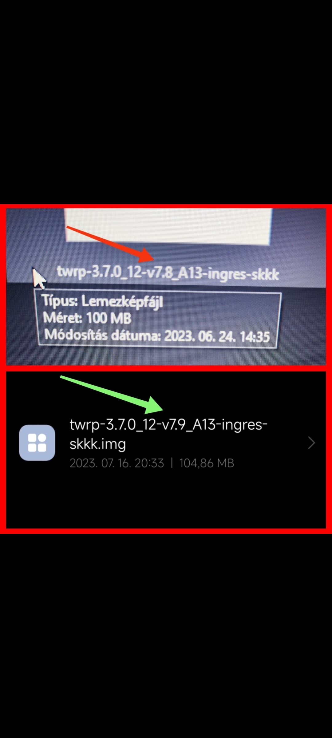

Just realized there's no usb transfer option pops up in latest 2 builds.
Even I manually switch default usb configuration to File transfer still not able to transfer.
EDITED:
The newer TWRP has been released.
Sorry, beginners' mistake
I didn't think there was another TWRP from a few weeks ago. 7.8 - > 7.9.
I will check more often in the future before writing.
So, what was the problem with TWRP in the first place? i did not understand ..

The problem is me. I updated TWRP on 06/24/2023.
I thought there was no newer. 23.7.10 Weekly dev. It was seemingly successfully recovered using TWRP-3.7.0_12-v7.8_A13-ingres-skkkk.
Unfortunately, it got terribly hot, so I reinstalled it in fastboot mode.
I totally believed there was no new TWRP.
Last night I checked why TWRP was not successful.
That's when I noticed I had another TWRP:
TWRP-3.7.0_12-v7.9_A13-ingres-skkk. Update after fastboot mode, wery good...
The fault was my inattention.
