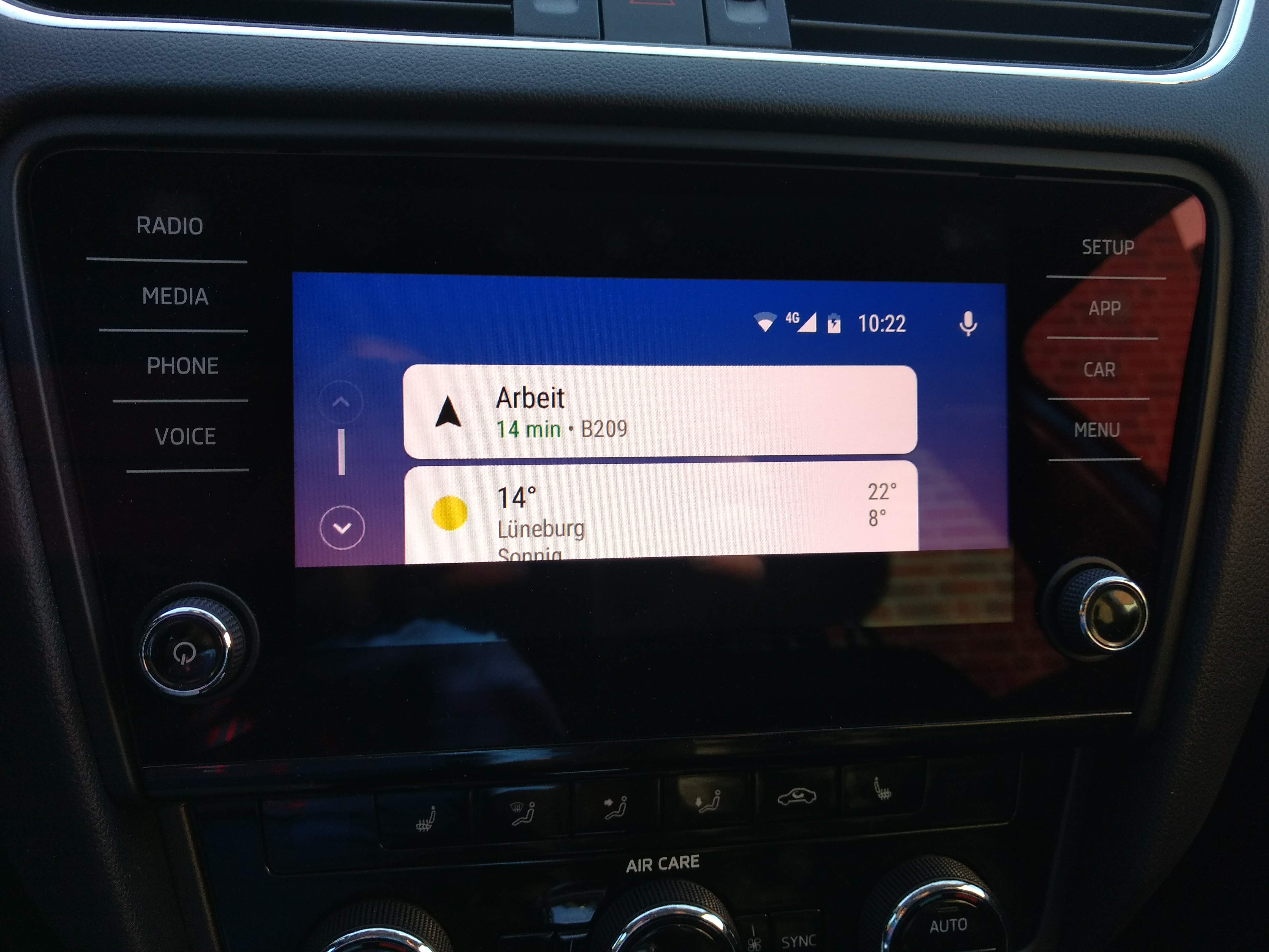

When connecting the A2 Lite with my Skoda Octavia, Android Auto launches easily. However, the screen is cut off after startup, top and bottom with two wide black bars. It lacks the buttons to use AA and only half of the screen is used. Every time you try to connect again, the problem exists.

It is Android 8.x issue on devices with notch.. will be fixed in Android 9.0 update...
