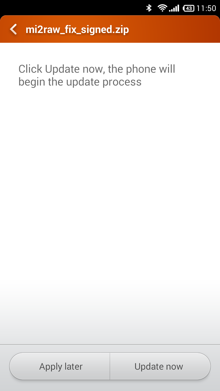

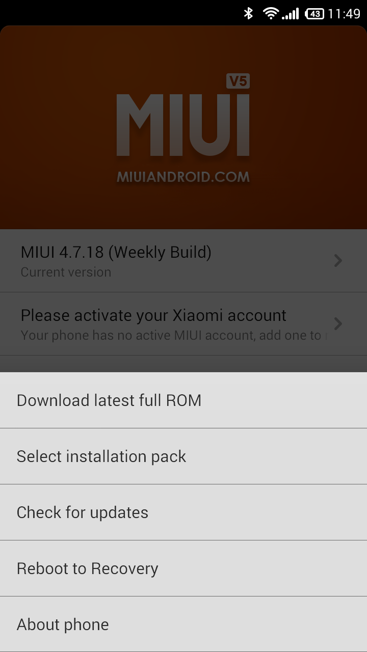

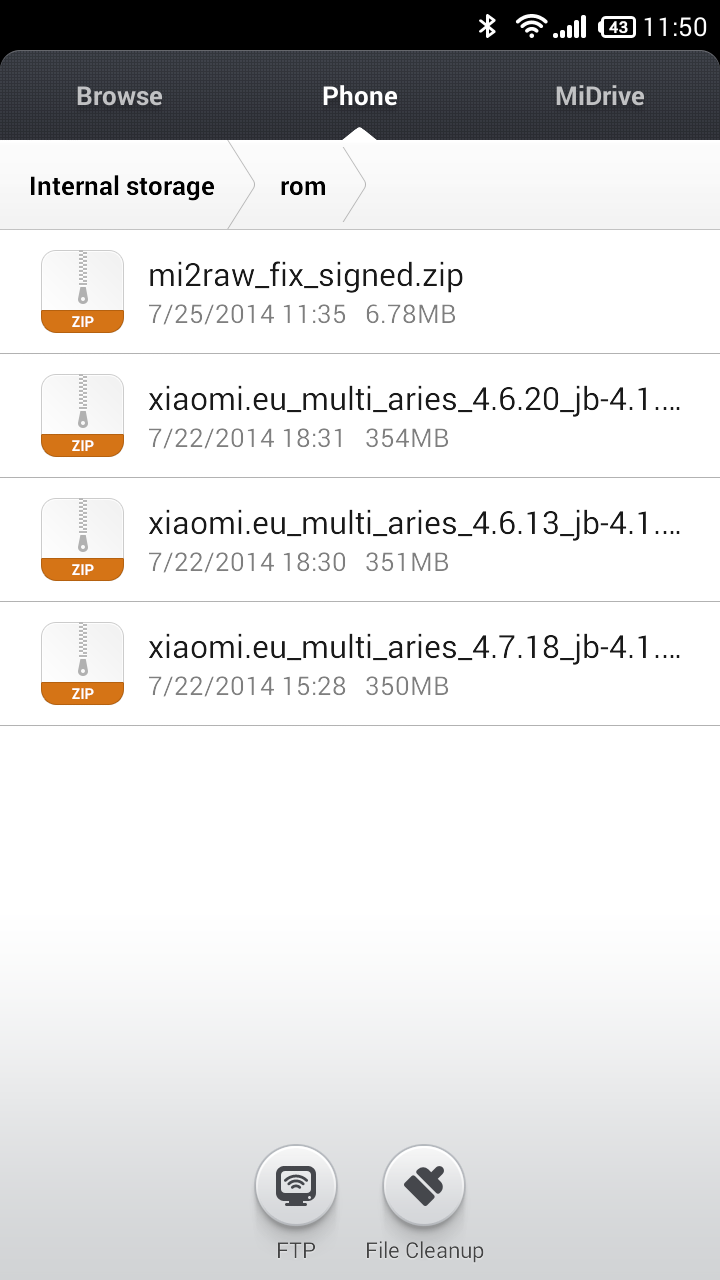

hey! first i'd like to thank you guys for ur efforts, i rly appreciate it! the camera app finally works now!
unfortunately since i updated my phone with the mi2raw zip above some of the apps keep crashing like gallery, updater etc. i can't even update from 4.7.18 to 4.7.25.
as much as i like to use mi2raw, but i prefer to have a stable phone - is there a way to "undo" the mi2raw update? even my 2nd partition keeps crashing :(
Don't worry, seems like a not wiped cache issue. So you should just wipe cache :)
More comprehensive approach:
(0. back up just in case....)
1. In recovery (power & vol+), go to wipe and perform "wipe cache" (harmless, you can read here: http://forums.androidcentral.com/droid-razr/343560-what-exactly-wipe-cache-partition.html)
2. install again 4.7.25
3. reboot
4. repeat step 1
5. install mi2raw_fix_signed
6. reboot
7. repeat step 1
Regards
