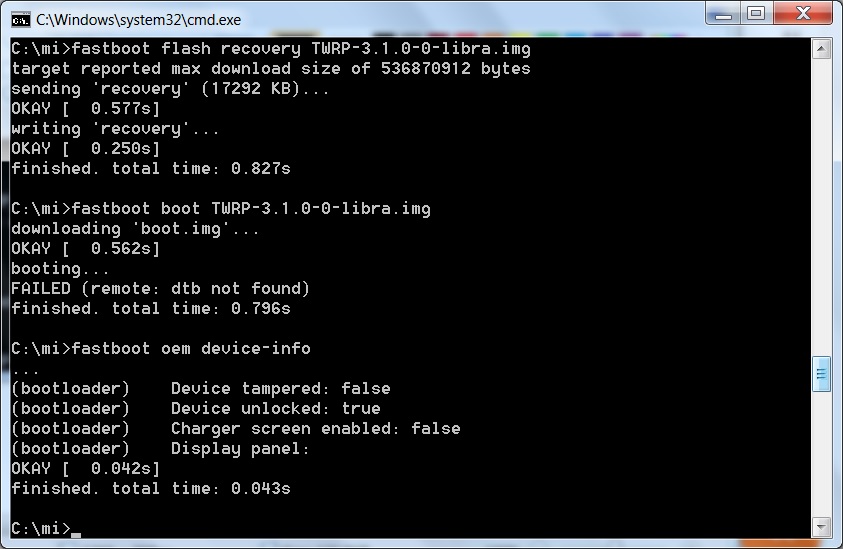

i try all latest version and still meet dtb error :(
