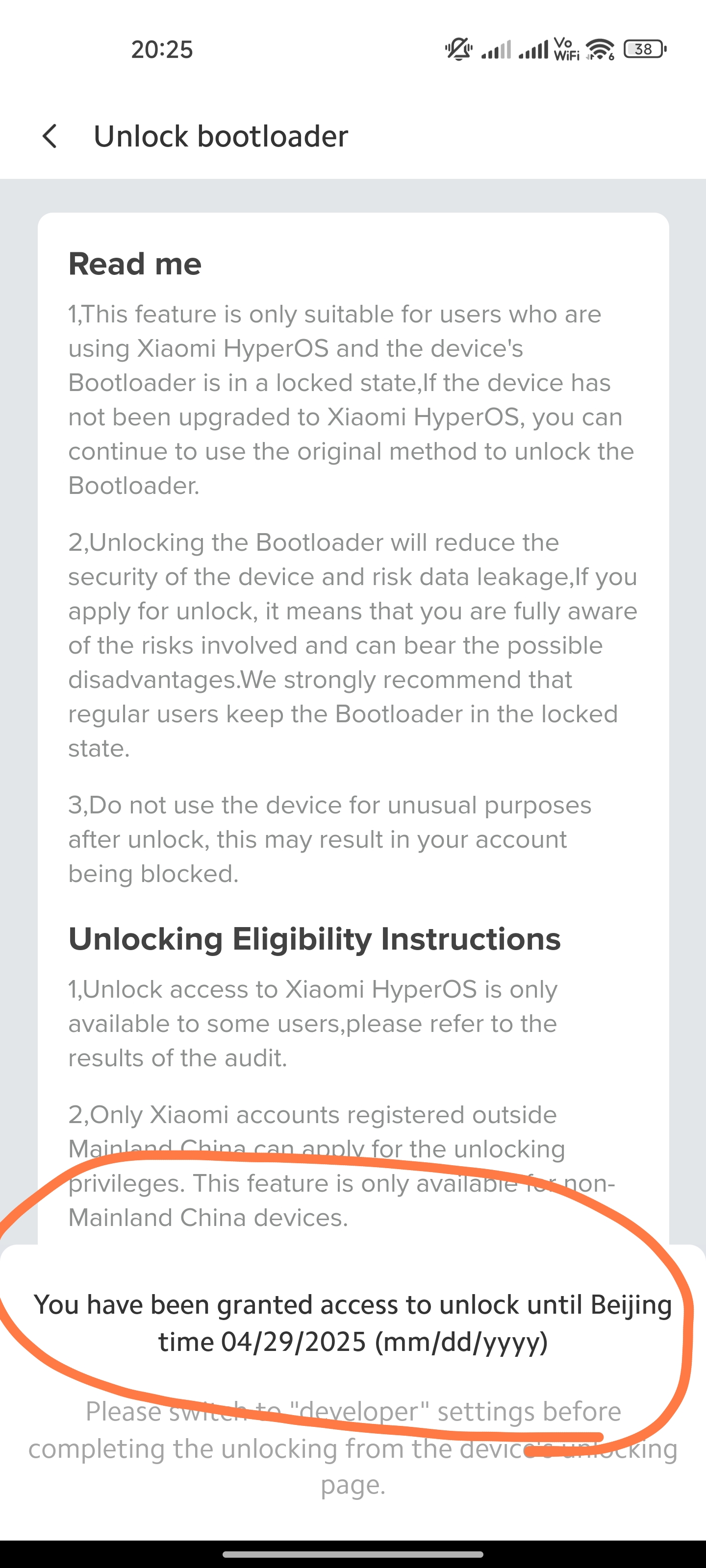

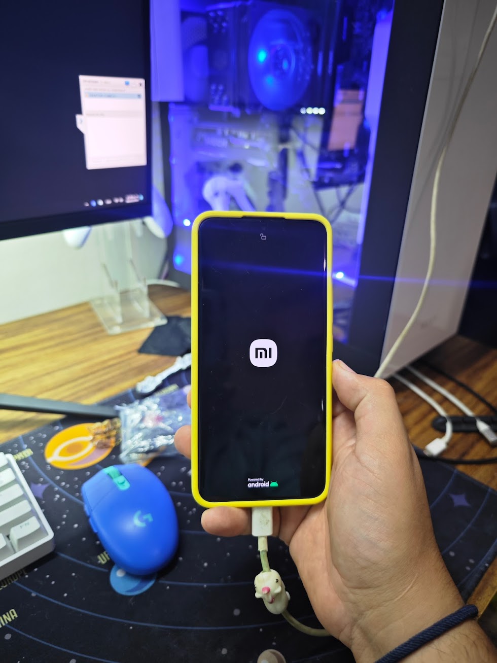

At last! After looking for several unlockers and having problems with one, I finally managed to get them to unlock (ncunlock) the bootloader of the Chinese Xiaomi 14 Pro, now install the EU rom and try

I did it through an unlocker, I paid 80 dollars for the service, very expensive by the way, but seeing that it is very likely the only way to do it for Chinese phones, which was slow since the servers were down

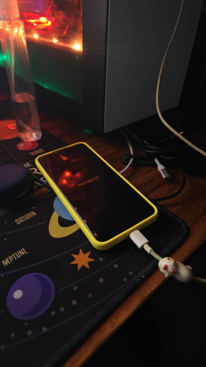

I got a Mi Pad 6 Pro von China and installed HyperOS.
I managed to apply for unlocking in 168 h
What I did:
Checked that video:
Downloaded this: https://drive.google.com/file/d/1R3zOXxRyYRY72o694XcwQWQnRXlpxzN4/view
Extracted to c:\php\ (be sure that you have all files and directories in c:\php and not c:\php\php)
Signin on MiPad with Xiaomi Account
Enable DeveloperMode and ADB as shown
Downloaded MiFlash from https://dosya.co/zq1jej7lylai/miflash_unlock_en_7.6.727.43.zip.html
Extract and run MiUsbDriver.exe
Connect Pad to PC
Allow connection on Pad
Disconnect Pad
Start bypass.cmd in c:\php
Connect Pad
In developer options on pad click on Mi Unlock Status and Apply for unlock
If the command window of the script throws no errors->
Open MiFlash and sign in with same account as on Pad
Reboot Tab to Fastboot as explained
Unlock
It should stait you need to wait for 168 h
After 1 Week, start MiFlash again
Unlock should work now

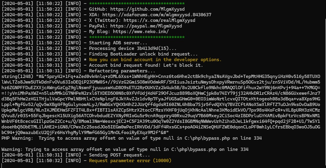

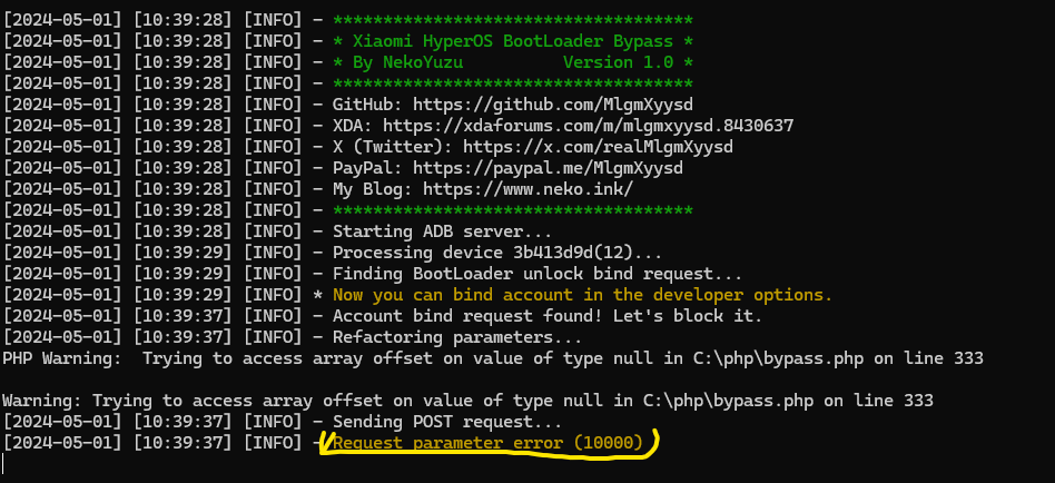

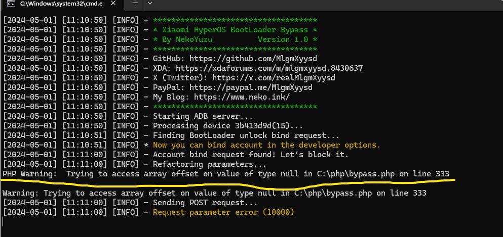

Hi ! I tried this method but it gave me « Request parameter error (10000) » at the end of the process. Do you know something that could help me ? I have a Xiaomi 14 Ultra

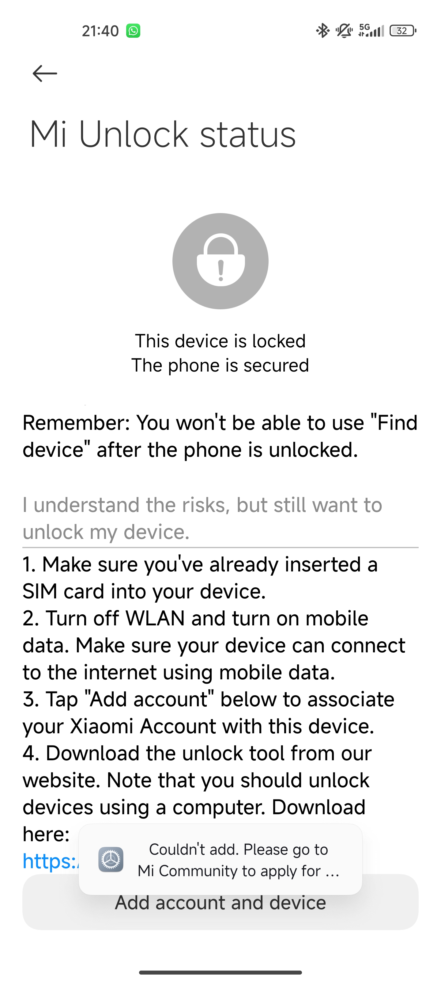

What can I do to unlock my bootloader ? I have Mi 11 Ultra Global version with China HyperOS (1.02.0UKACNXM). I want to change it back to Global MIUI.
I tried all variants to unlock bootloader but still have same message: Please add your account in Setting > Developer Options....

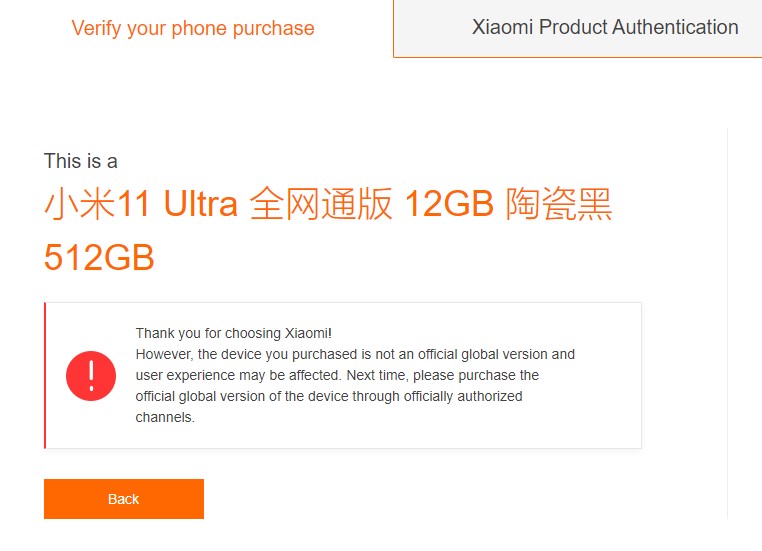

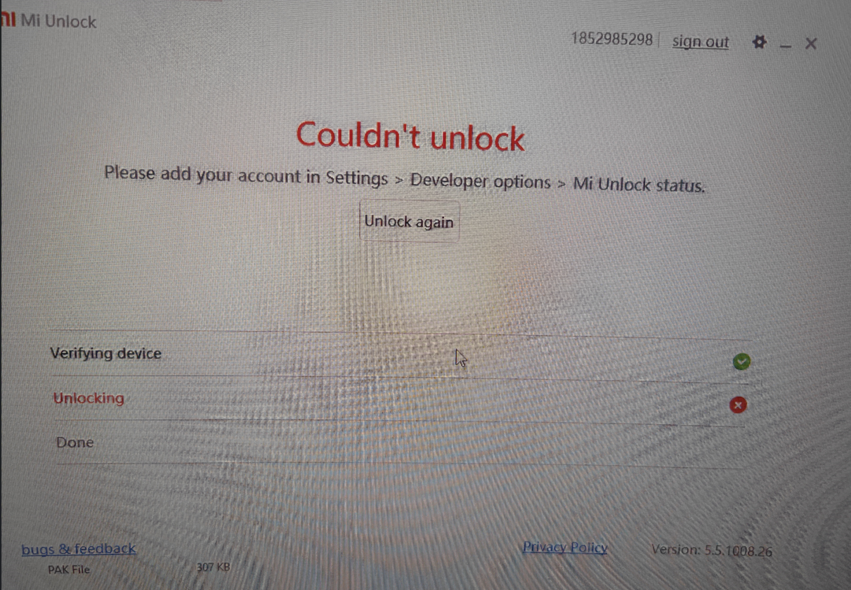

Hello.
It is not possible to have a global version device with a Chinese ROM and a locked bootloader. You do not have the Global version of Mi 11 Ultra but the Chinese version.
1, you have Global devices with Chinese ROM = unlocked bootloader
2, you have a Chinese device with a Chinese ROM = locked bootloader
Of course it's possible, many posts over the last 6 months on this subject for CN devices.
Here for the redmi note 12 turbo:
Yes, it is Global version. Was unlocked bootloader but was bricked after locked bootloader and write the last MIUI Global. After unbricked in EDL mode, was writed a wrong ROM and now I have to suffer :(
You may have been confused ever since you bought the device.
You bought a CN device with Global ROM and unlocked bootloader.
What can I do to put it back the Global version like it was ?
This model is released with MIUI, this method should work:
