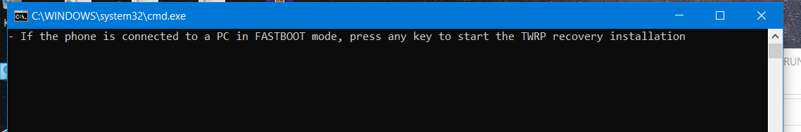

You have to connect in fasboot mode, not in the system.
Or do you mean PC system? cmd not responding? Did you click on any button on the PC? Do you use USB 2.0 or USB 3.0?

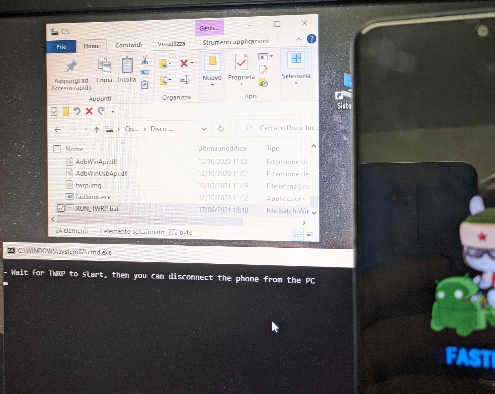

system ?
I click on any button on the PC but on my Poco F3 ( connected in fastboot mode ) it doesn't start.
I have just update new weekly. Previous i had installed twrp nebrassy on ramdisk partition and now i have normally reboot in recovery after downloaded update and clic on reboot in recovery after i have installed new update rom and reboot system.
