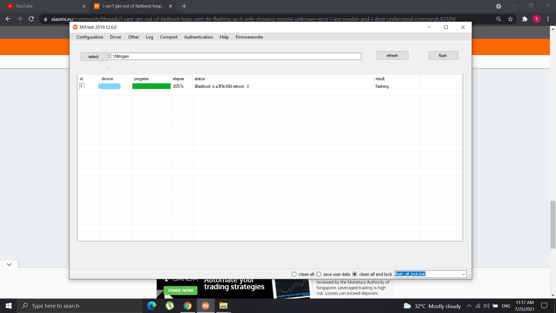

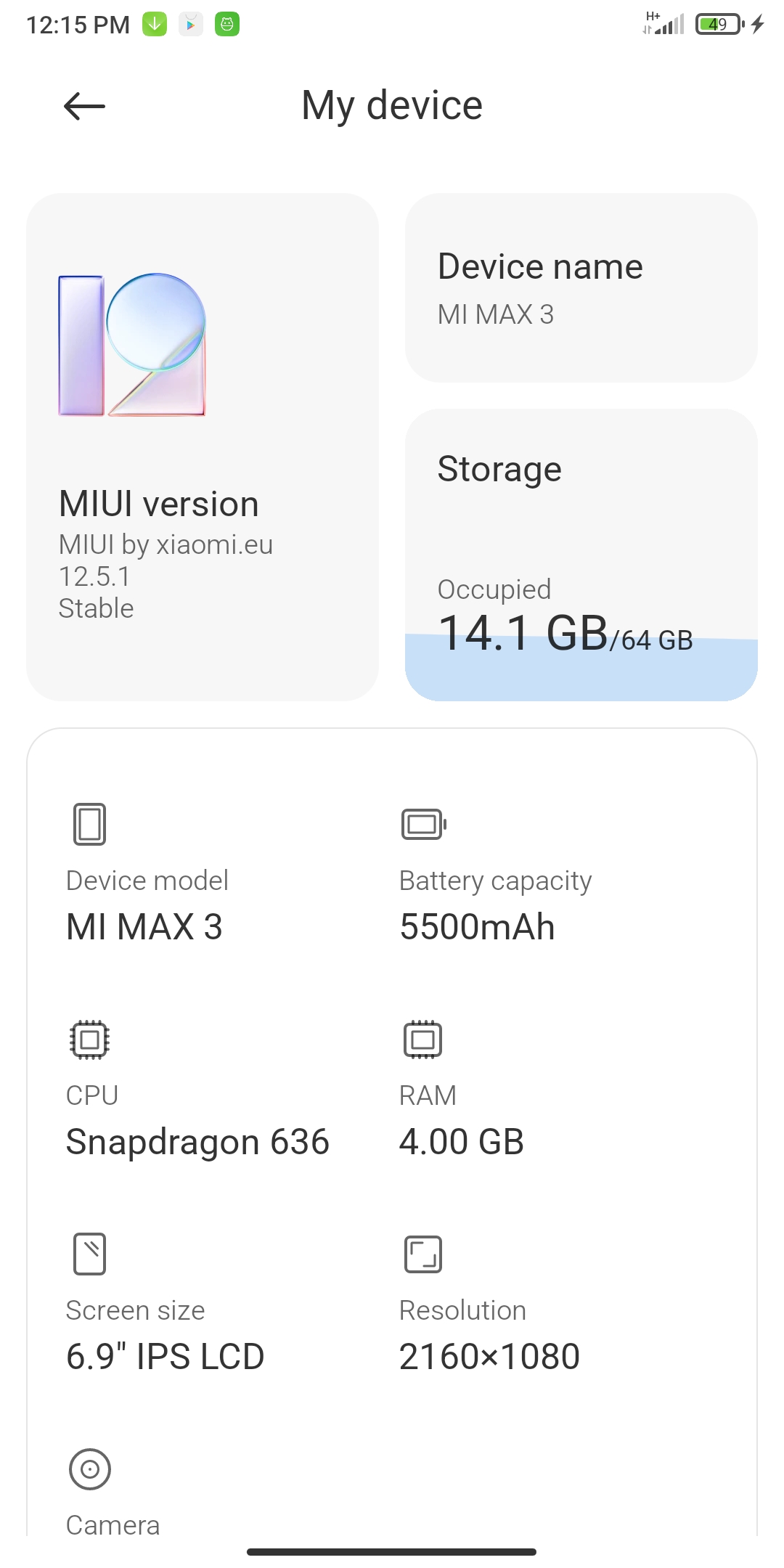

Replying myself
So the problem is folder name eh? ([9:55:12 AM *******]:info2:error: cannot load 'C:\nitogen': No such file or directory )
all good for now
edit: stuck at this but the phone is running now
