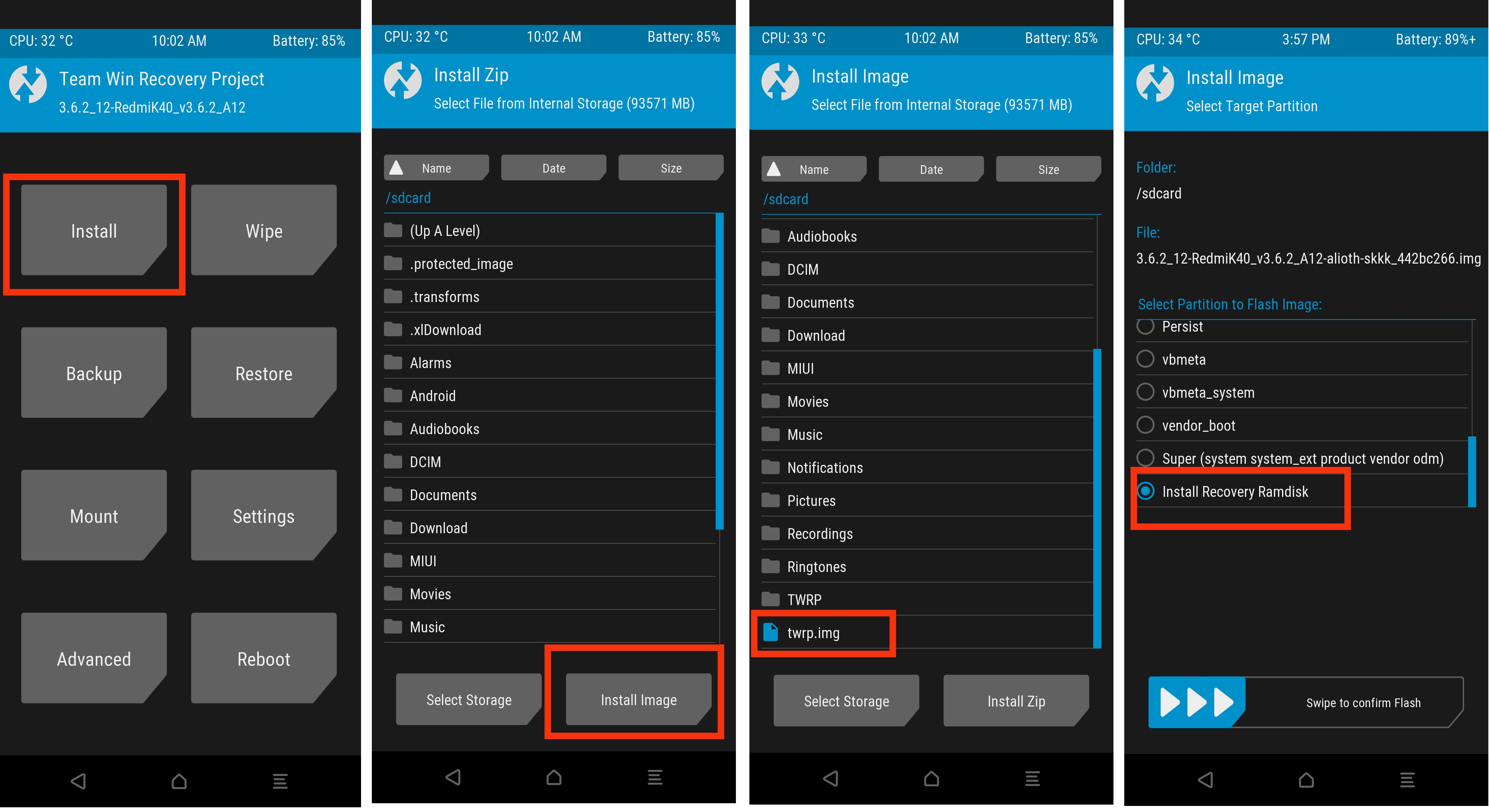

For Mi 11 Pro install TWRP to Ramdisk.

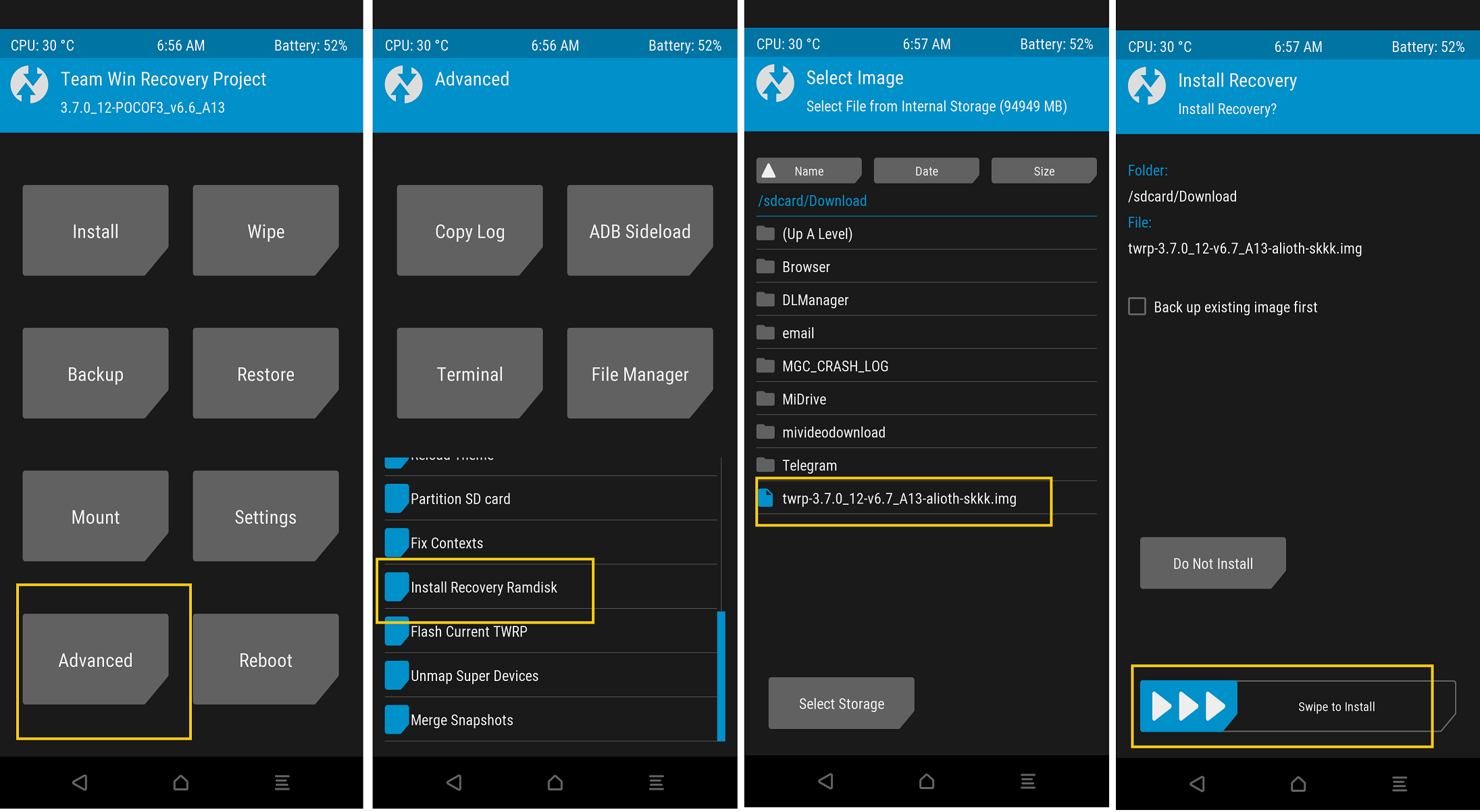

At least the grey boxes on top part of screen are identical
Is this procedure possible for you?
