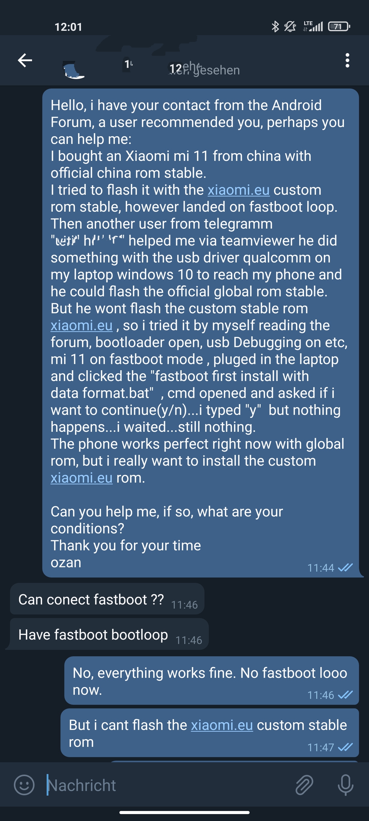

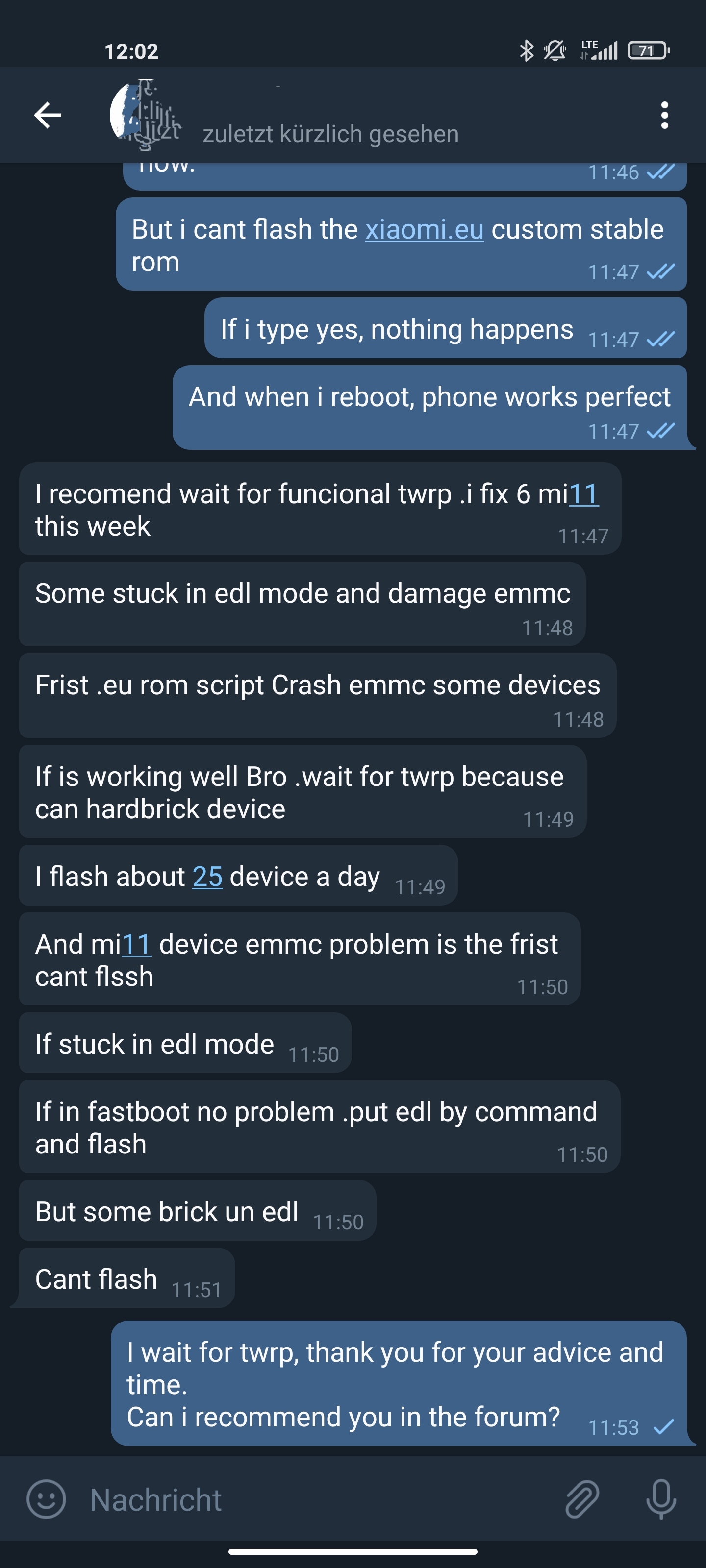

I just had a conversation with someone recommended to me here from the forum via telegramm.
He says if everything is working for me, i should wait for twrp.
He told me that he had to unbrick many many phones this week...
I post the screenshots of the conversation, i didnt understand everything quite well because my english ist echt mies:)
So, what should i do?...i want the xiaomi.eu stable rom so sehr...menno Edit: he says: if in fastboot rom no problem, put edl by command and flash.
How do i do that? It is zum Haare raufen

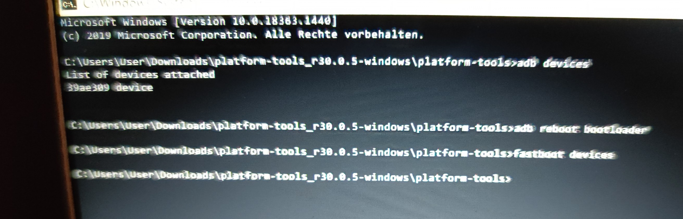

So, i wont give up. Today i reinstalled windows 10 on my laptop because allthough i can go on fastboot on my phone, the first install flash bat script doesnt work and the fastboot device isnt recognized by my laptop, allthough i hear the connect sound. And later i will try to flash the xiaomi.eu stable rom again. Bootloader is open, i do everything like explained.

what does your device manager show, if your Mi11 is connected in fastboot
there should be a entry with : android bootloader interface
Reactions: ozan1000
No such " android bootloader device" ...nothing. My guess the unbrick guy changed Something in the windows settings. Although it shows my mi 11 when i plug in my phone without fastboot as xiaomi 11.
But i did install windows 10 new and will check later today when i am back home.
Thanks mate, i hope i will soon post the successful instalation.

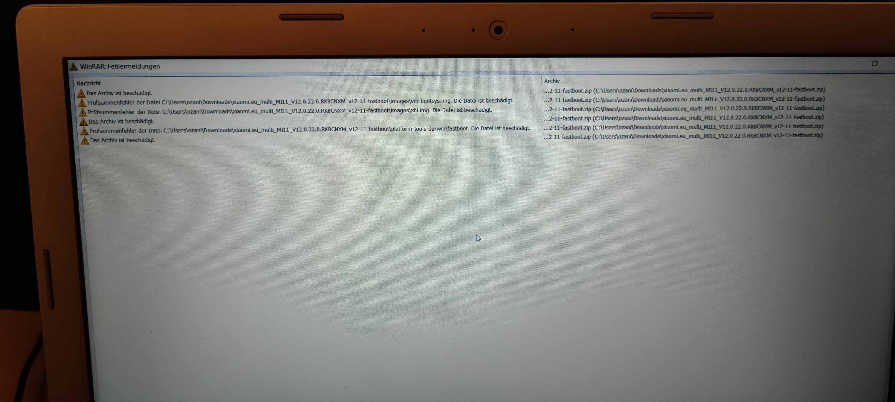

Edit: so i wanted to unzio the xiaomi.eu rom, but the archive is corrupted/beschädigt?...i downloaded it from the link here in the forum

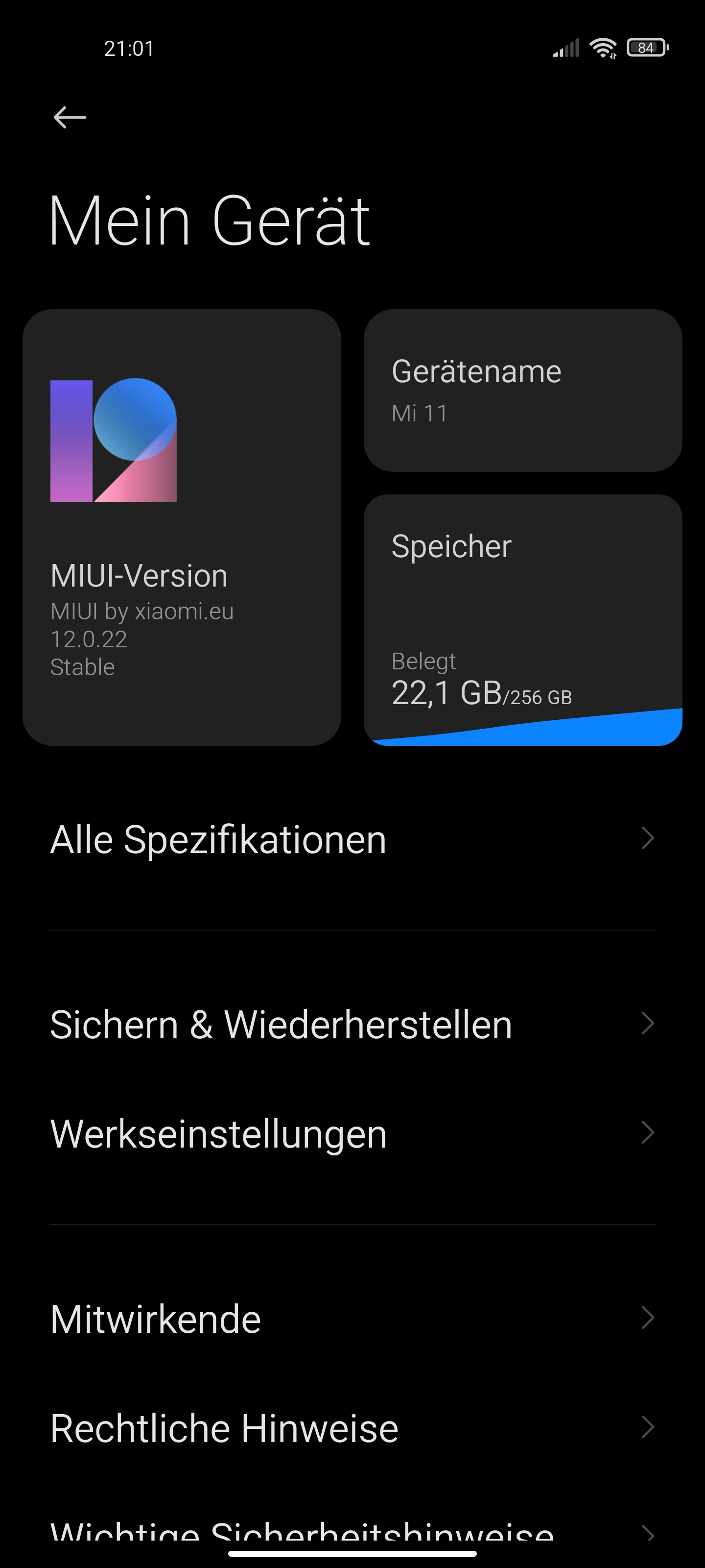

Guys, hallelujaa, i did it. Never gave up and never going back from xiaomi.eu.
Thanks y'all!
