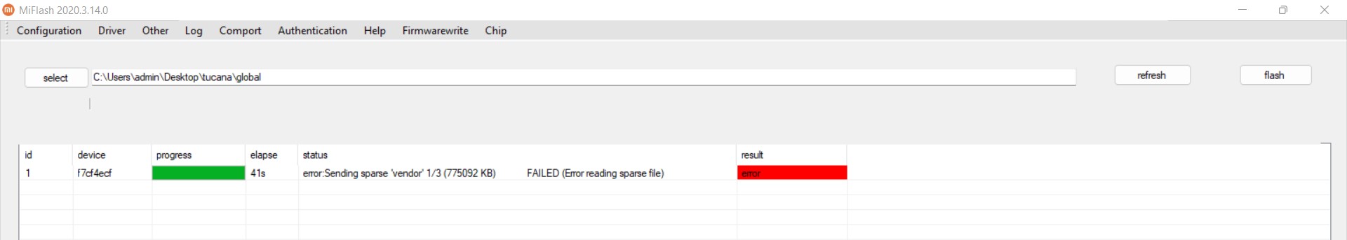

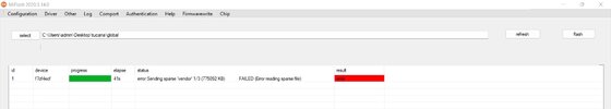

after hours, I'm not able to flash with fastboot method through MI Flash 2020 3.14 :(
No matter what I do, always get a error after few second : "error sending sparse vendor"

Always the same error at "vendor" step flash in Mi flash.
Version I tried :
- tucana_global_images_V13.0.1.0.RFDMIXM_20220412.0000.00_11.0_global
- tucana_eea_global_images_V13.0.1.0.RFDEUXM_20220412.0000.00_11.0_eea

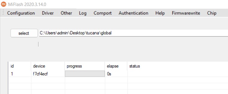

- run Miflash
- connect the phone to the PC in fastboot mode
- Click on "select" to enter the path to the ROM.
- click on "refresh"
- mark clean all / flash_all.bat
- click on "flash"
Reactions: katerpanne
- run Miflash
- click on "flash"
Sorry but it doesn't work at all :(

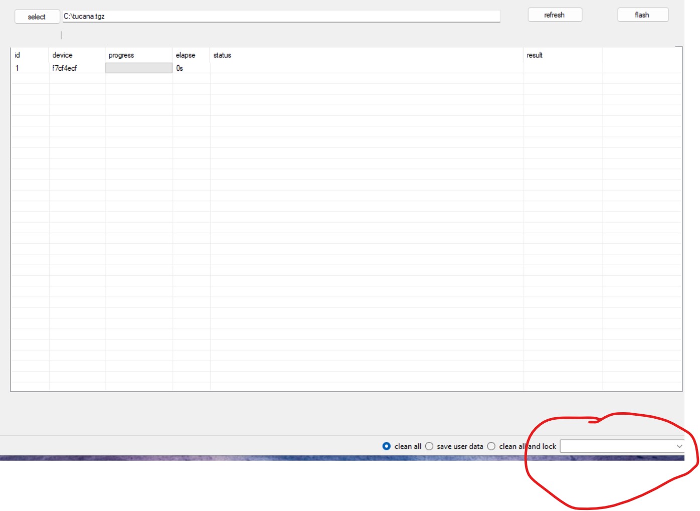

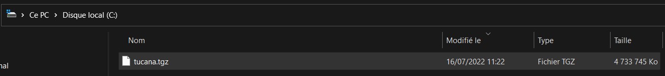

Can't understand this LOG :'(
Code:
[12:55:42  f7cf4ecf]:info1:$fastboot -s devicename flash vendor C:\tucana_global_STOCK\images\vendor.img   ||
[12:56:10  f7cf4ecf]:info2:Sending sparse 'vendor' 1/3 (775092 KB)            FAILED (Error reading sparse file)
[12:56:10  f7cf4ecf]:info2:fastboot: error: Command failed
[12:56:10  f7cf4ecf]:info1:"Flash vendor error"
[12:56:10  f7cf4ecf]:begin FlashDone
[12:56:10  f7cf4ecf]:error:Sending sparse 'vendor' 1/3 (775092 KB)            FAILED (Error reading sparse file)
[12:56:10  f7cf4ecf]process exit.
[12:56:14  f7cf4ecf]:flashSuccess False
[12:56:14  f7cf4ecf]:isFactory False CheckCPUID False
[12:56:14  f7cf4ecf]:before:flashSuccess is False set IsUpdate:True set IsDone True
[12:56:14  f7cf4ecf]:after:flashSuccess is False set IsUpdate:false set IsDone true
