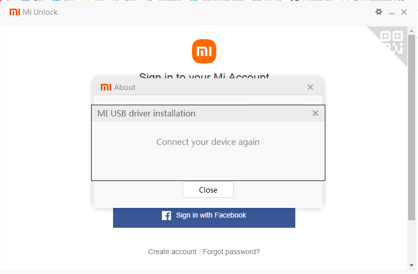

I installed Mi Unlock. SS is attached sayying no device found on clicking install drivers. Phone was connected in fastboot
