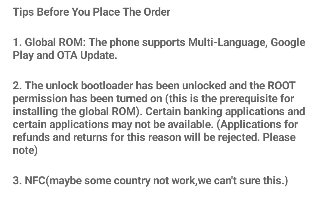

I want to buy the Xiaomi 13 ultra global rom on Aliexpress but the sellers aren't giving me straight forward answer. I'm aware they'll unlock bootloader and flash the global rom but then I asked. When an update to the rom comes will I have to manually flash it or is it something that will update over the air. They said it accepts ota. Also what games don't play on the global rom of Xiaomi 13 Ultra?

Chinese devices with Global ROM:
- bootloader must remain unlocked = non-functional payments via NFC (GPay), non-functional banking applications.
On Chinese device, it is better for you to use xiaomi.eu ROM.

I think that's what the sellers on Aliexpress are flashing after unlocking bootloader. But hope once using the xiaomi.eu Global Rom. I don't need to flash another once MIUI 15 is out. It will be updated via ota without me having to use a pc to do anything cuz that's definitely beyond me. I have a pc but I dunno how.

I guess we don't understand each other. Global ROM and xiaomi.eu ROM are different worlds.
- Global ROM je oficiální ROM - if it is installed on the Chinese version of the device, the services I described in the previous post will not work for you.
- xiaomi.eu ROM is a modified MIUI for use in the EU by a group of enthusiasts that is built on a Chinese ROM - the services I described in the previous post will work for you.

I think I understand you. So if I get the global rom version asides those stuffs not working any other concerns. Is the Global rom Google play certified.
If you're a gamer what games don't work on the global rom or xiaomi.eu rom from your experience.
Thanks for your prompt replies always.
Sadly I'm not a king in root neither do I even understand this as I could end up bricking my device beyond recovery assuming I buy the Global ROM and choose to switch to the Xiaomi.eu Rom.
Also does the Xiaomi.eu and the Global ROM allows OTA updates? Without having to use pc to flash a new patch update?
