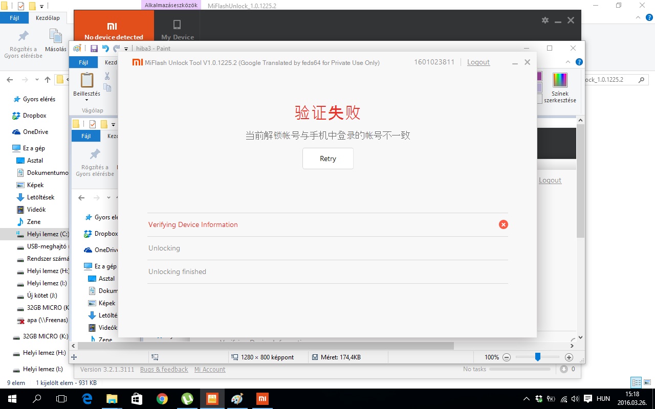

I've a problem during the bootloader workaround, see attached image.
What it means? I've tried with the tools but it seems not working.
The version is 7.6.2.18 beta and full working with mi account.
Pls Help
The screen looks like your phone is not connected to the site ie. As if you did not recognize the phone

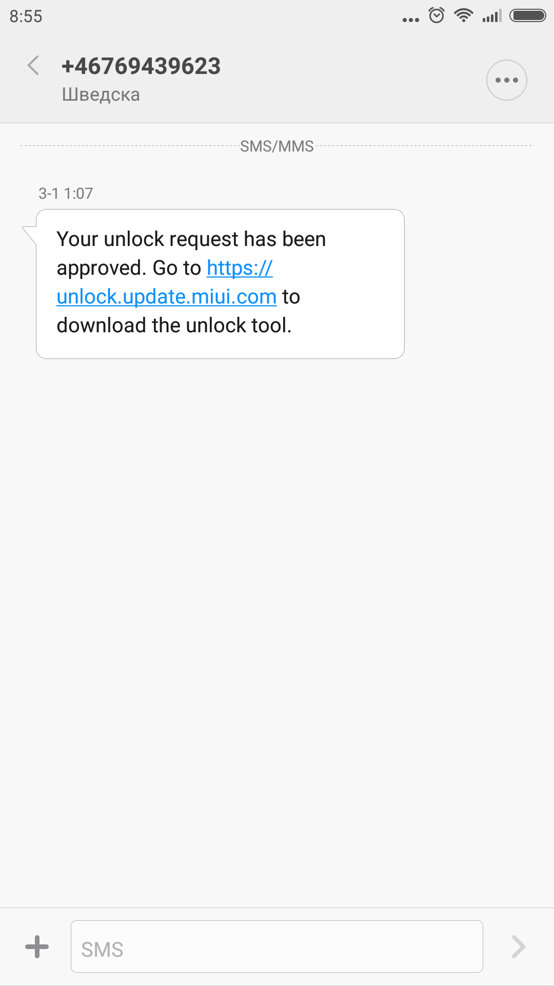

I received a SMS with a link to download the tools to unlock.
I do not understand now what's next? when I tried to download a tool that's impossible. The first thing is all the text in Chinese and when I manage to find where I should enter user name opens the next panel, which is also very fast close and I back to the beginning.
What this is about, anyone know?
P.S. whether this is the SMS to be obtained for unlocking !?

Yes, your request was approved. Now, download the Miunlock tool English version for better understanding. Or I can share it with you through one drive. ;)
Write me PM.
After that I installed TWRP through SP FLASH TOOL (I read it on Russian forums) and installed xiaomi.eu ROM 6.1.14. All take 15 minutes to install. Don't worry

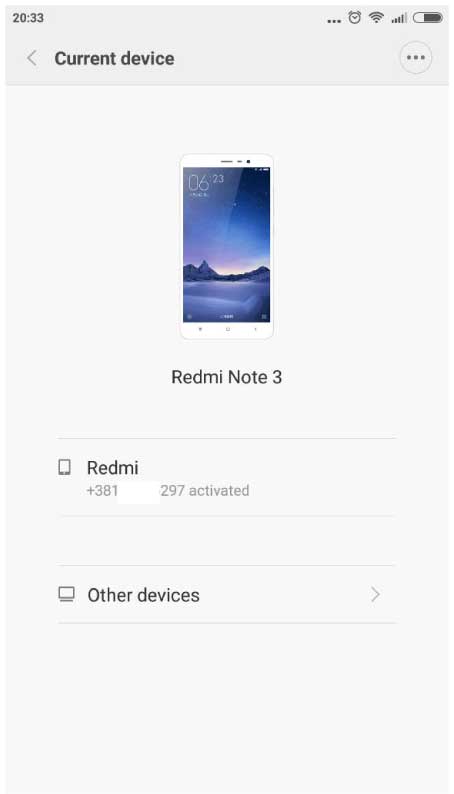

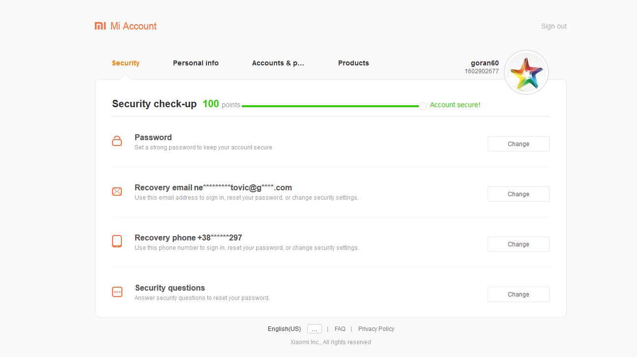

Do you have activated Mi account? Try to do again the steps written on the 1 page.

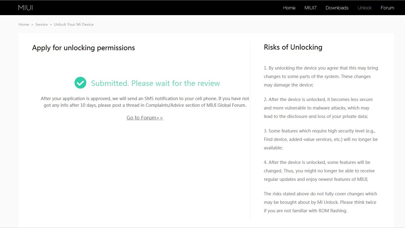

When you repeat all the steps from post 1 come to the window, where it says that I have "successfully submitted a request to unlock" and that's the end.

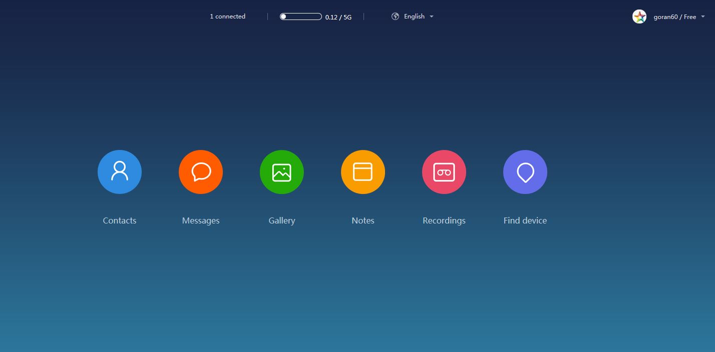

I have all activated (OK vidijeli attached).

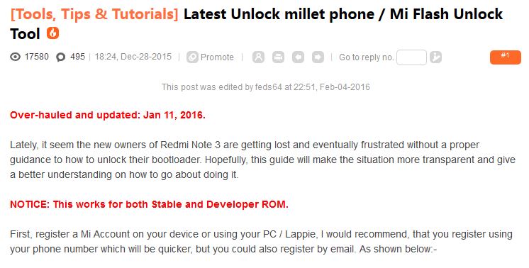

whether it is now possible to unlock and stable rom. as I understand it here's what it says. I'd ask someone to comment or confirm this

Smartbz, it works on Rn3 but I don't know if it works on Rn3pro. Does any1 know of it works on pro version and actually tried to unlock?
fpozar, tried on RN3 but it did not work. The unlock tool directed to the miui unlock site to request for a code. So basically without the code it does not work.

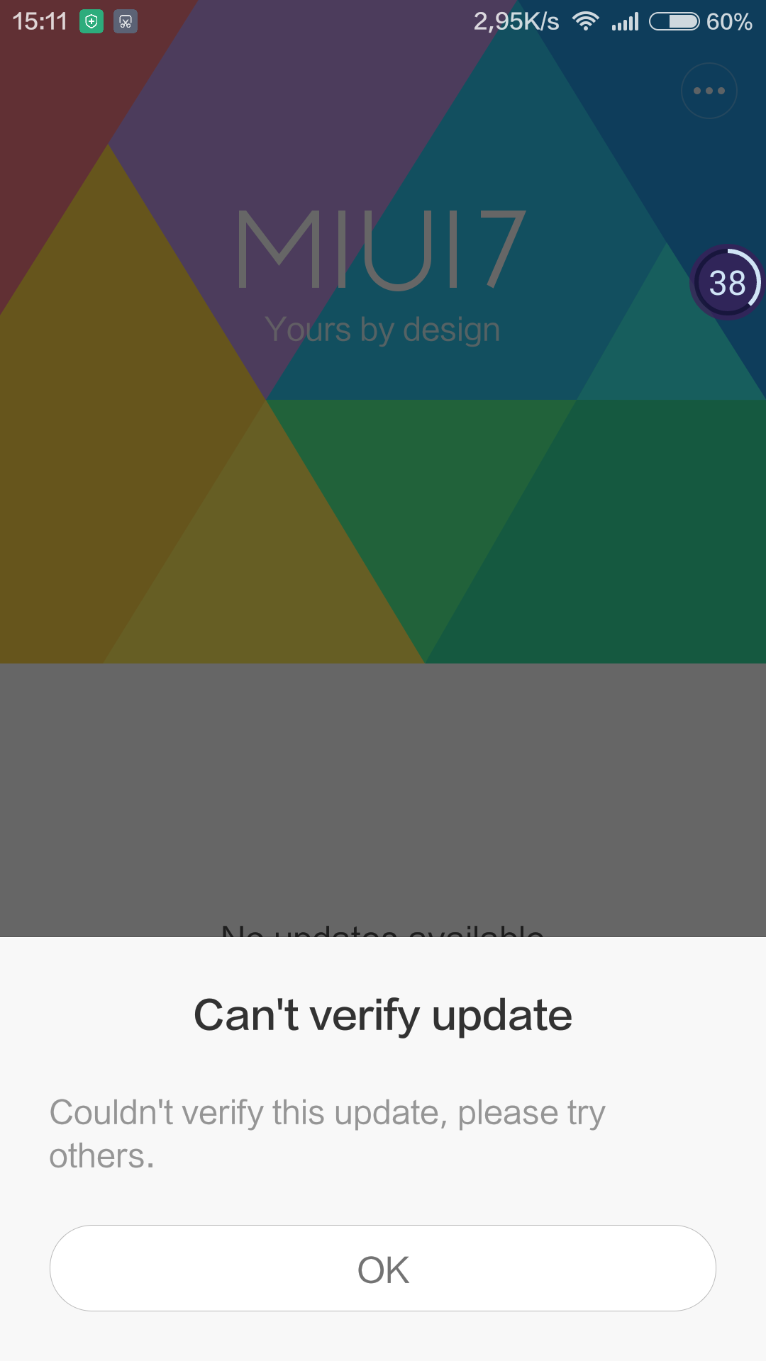

Please help me, well to be precise, my father. :) I bought a Redmi Note 3 (Hennessy) for him, however we need the multilanguage ROM, because the ROM it shipped with is half English, half Hungarian (I donw't know how). It's on 7.0.919.0 Stable, but even through the Updater app, it won't flash the DEV ROM (miui_HMNote3_6.3.24_41002e2ea6_5.0.zip) donwloaded from the official site, I get this message:
After this, I read thet the MiFlashUnlock can now unlock even being on Stable ROM, so I tried that as well, but at 50%, it says it can't verify the phone (I don't have the English screenshot atm).
ADB drivers seem to be OK as it lists it after adb devices, however, when I reboot to fastboot, the RMN3 vanishes. Is this normal?
I am totaly out of ideas, any suggestions how I can unlock the bootloader to be able to flash the multi rom? Maybe I can flash the DEV ROM with MiFlash?
