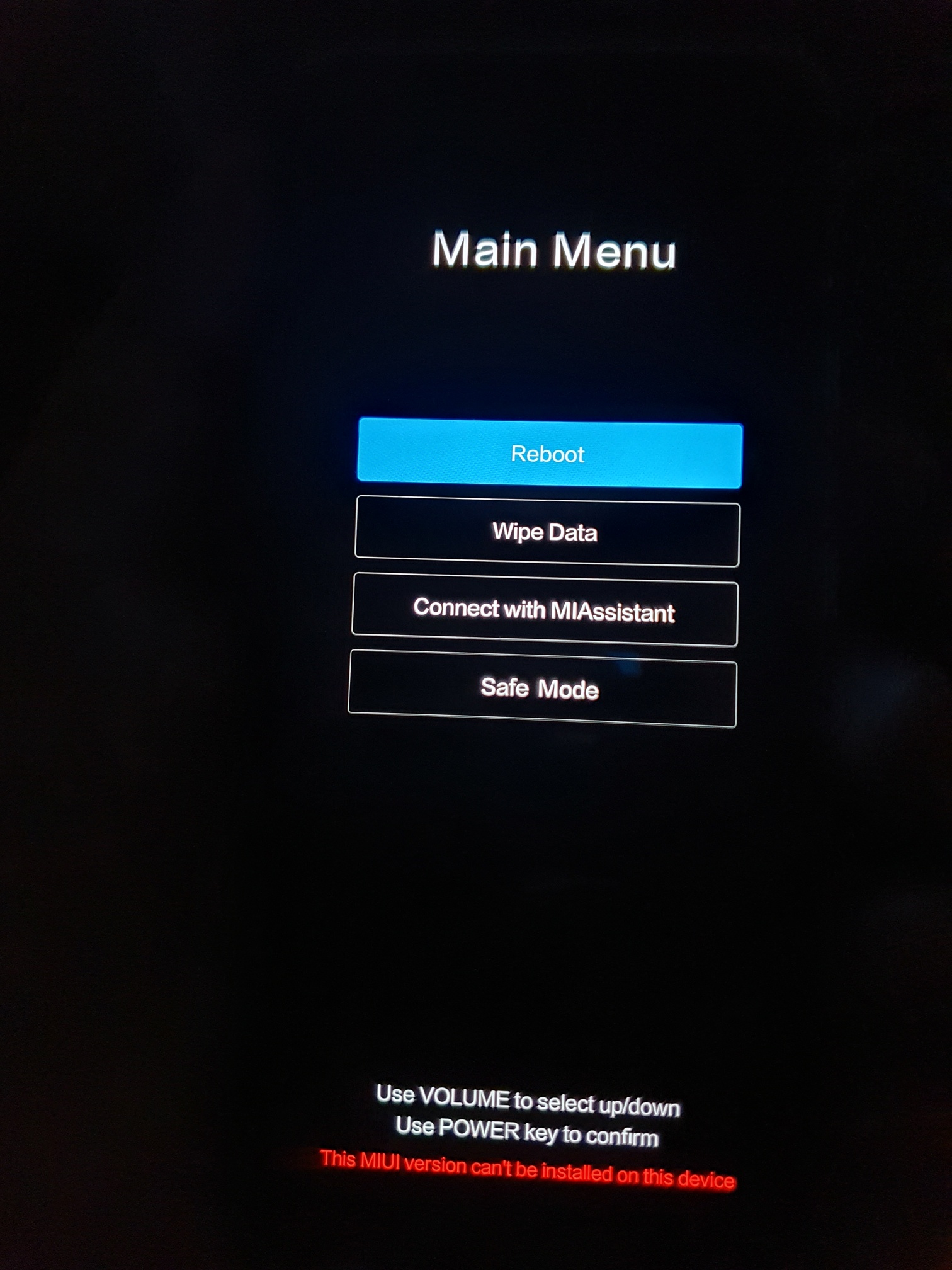

Hello guys,
I have a 13 Pro originally China ROM and after i installed Global ROM and locked the bootloader after the restart i got the following message: with red The MIUI version can't be installed on this device (please see the attached picture as well) after this i unlocked the bootloader and i'm able to start the OS.
My question is that i can't use on this phone the Global ROM with locked bootloader? because if not locked i can't get security updates at all.
Thanks!

If you install a Global ROM on a Chinese device and try to lock the bootloader, the result will becihla.png
For next time, before you start doing something, study the issue first.
I recommend installing xiaomi.eu ROM.

If you install a Global ROM on a Chinese device and try to lock the bootloader, the result will beView attachment 51298
