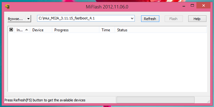

Sounds like you need to get your device back to stock. I had a problem with mine and I used this method to return it to stock and after that all was well.
Review this page: http://xiaomi.eu/community/threads/guide-flashing-rom-using-miflash.19287/
Just be sure you get an Mi2A fastboot package!
As far as i know there is no WIU rom for the MI2A. Ik think you flashed a MI2S rom. That's a totally different device.
Thank you for your guide, But MiFlash cannot recognize my phone, because I can't go to fastboot. My phone totally shutdown, cannot display charging when I plug to computer. By the way, what is the fastboot mode blindly in your post meaning?
What I meant by "fastboot mode blindly" was I managed to get the phone into what seemed like fastboot mode without a display by just normally doing it by pressing the power+vol down buttons as if the phone was working as it should.
My phone did have a line in that window saying COM1 (or similar). I said what the hell and pressed the Flash button and it took a few minutes then it finally said Successful and it booted up.
Other than drivers, I'm not sure how to go about getting the phone to show up in that box at all.

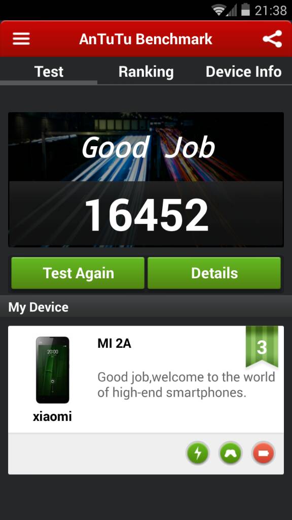

This Rom crashed on Wi-Fi settings. After 3 reboots I lost my Wi-Fi and could not enable it. Phone freezed on it, had to remove battery to restart.
Also very low scores in antutu of only 16000
For the moment i'll stick to 4.3.1 rom. Untill now that's the best working rom for me.
