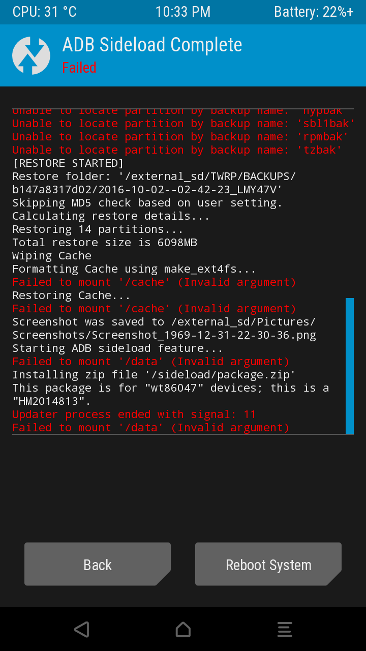

attached are the prt screen and screen shot of the devices
another try with this zip
same thing but says on the adb console (phone) it's a 88047 image and you have HM20148013
another try.....
same

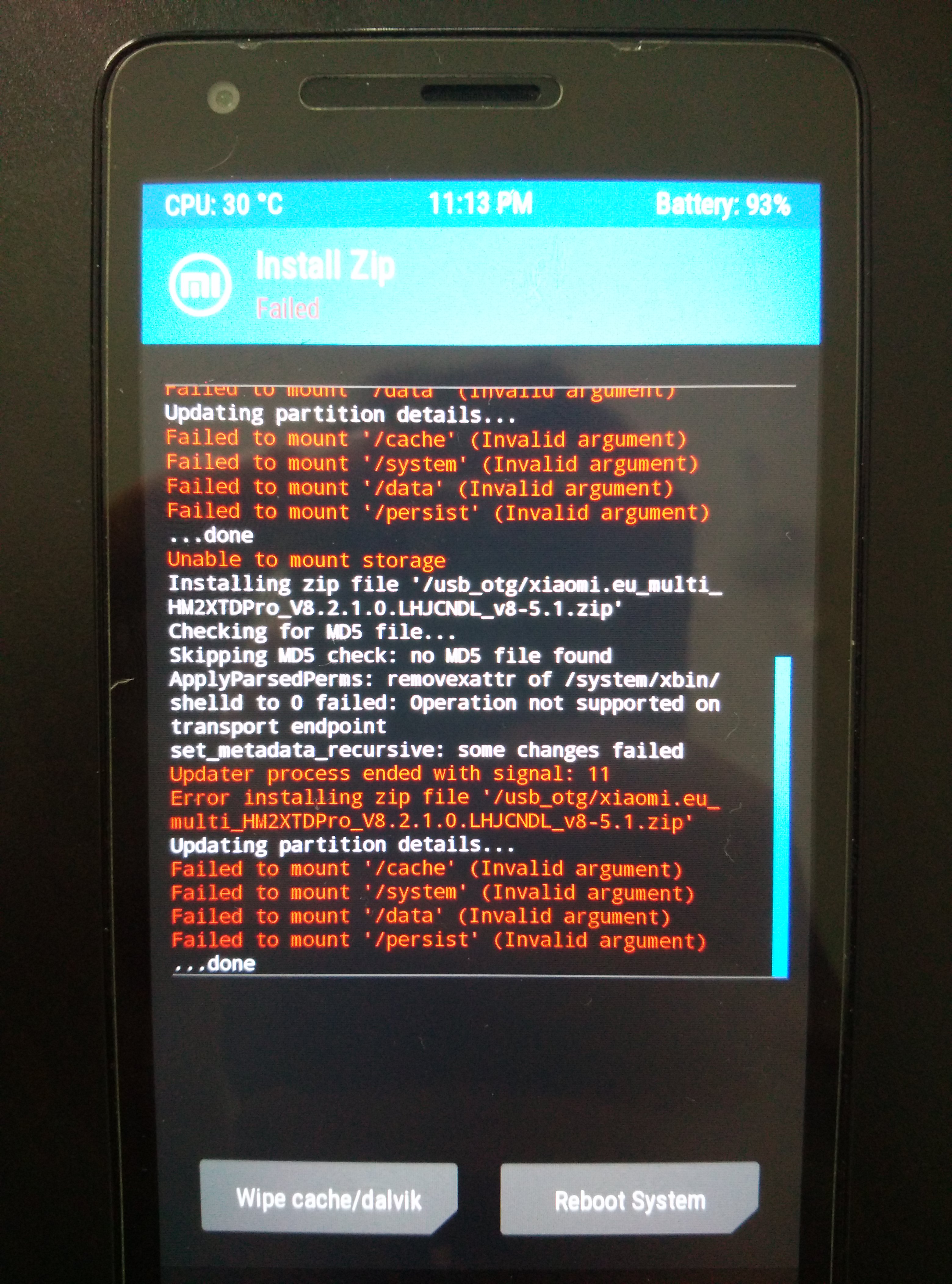

Hey guys,
Today my phone was acting super weird so I restarted it. Now is stuck in the MI logo loading screen. I managed to boot TWRP and got the same errors like you when trying to flash the same ROM again (xiaomi.eu_multi_HM2XTDPro_V8.2.1.0.LHJCNDL_v8-5.1).
Any ideas how to fix it?
PS: i attached a pic with the errors
Hey guys,
I haven't heard about anyone fixing it for sure (here or in any other forum). I tried many things by myself (and a friend of mine as well), and never got it back to life. AFAIK, xiaomi is replacing them in China, but apparently there's nothing to do. I simply got a new one, too much time waste on that.
