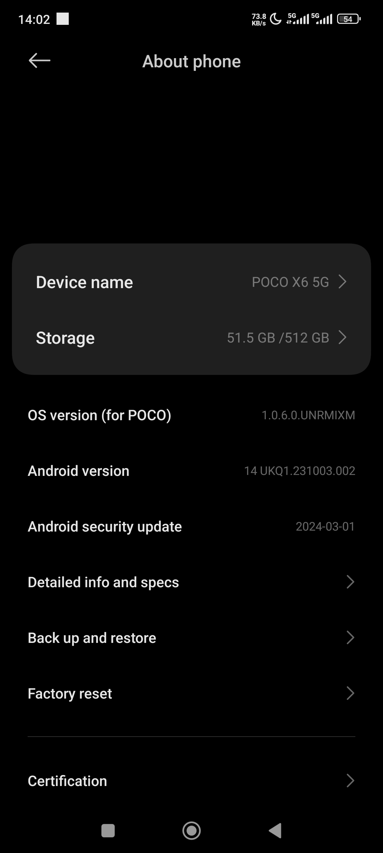

14.0.6.0 TNRMIXM GLOBAL
In the box appears EID and with the code *#06# appears ICCID1.
Supposedly on the internet it says I have and the app ESIM COMPATIBILITY CHECKER indicates that I have

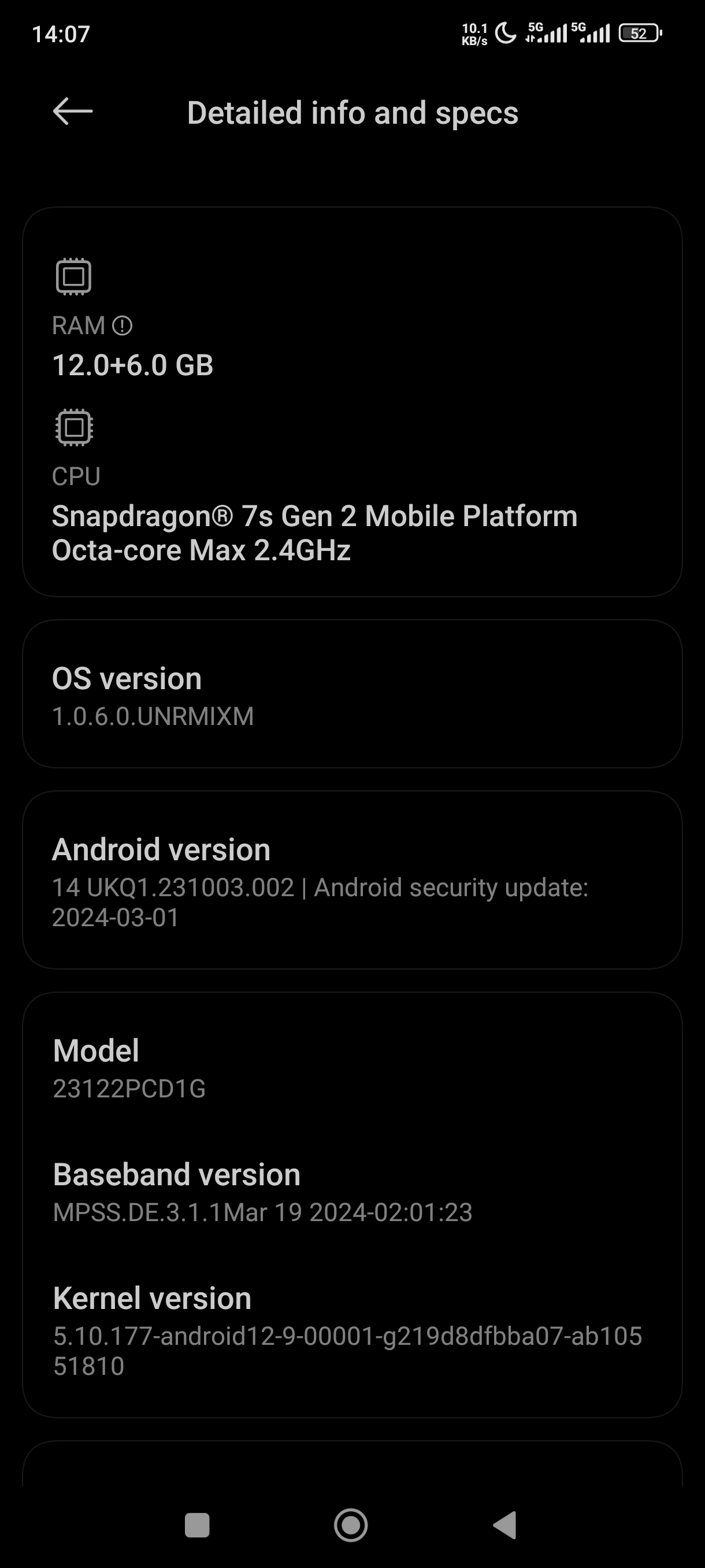

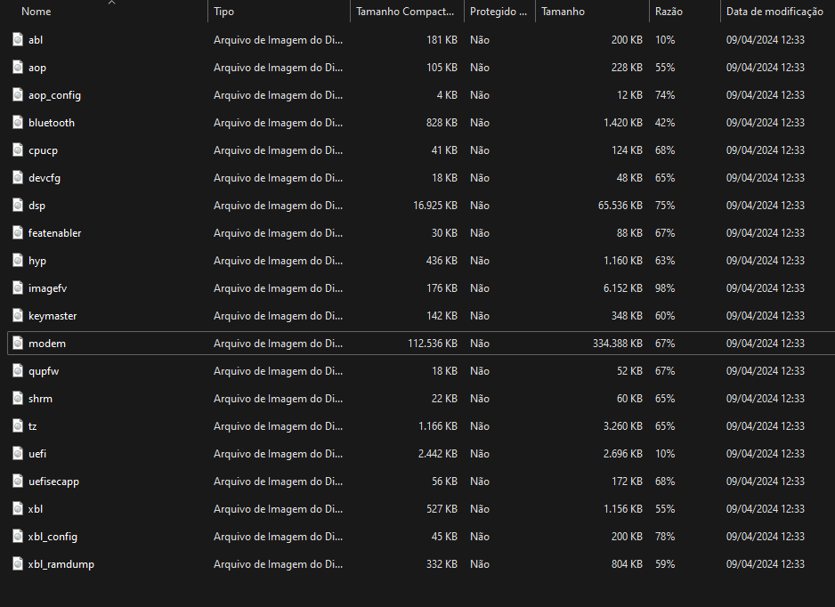

This is my installed version, today it's stock, I downloaded the rom from the link above version OS1.0.6.0.UNRMIXM, but inside the folder there is only modem.img modemfirmware.img does not have
