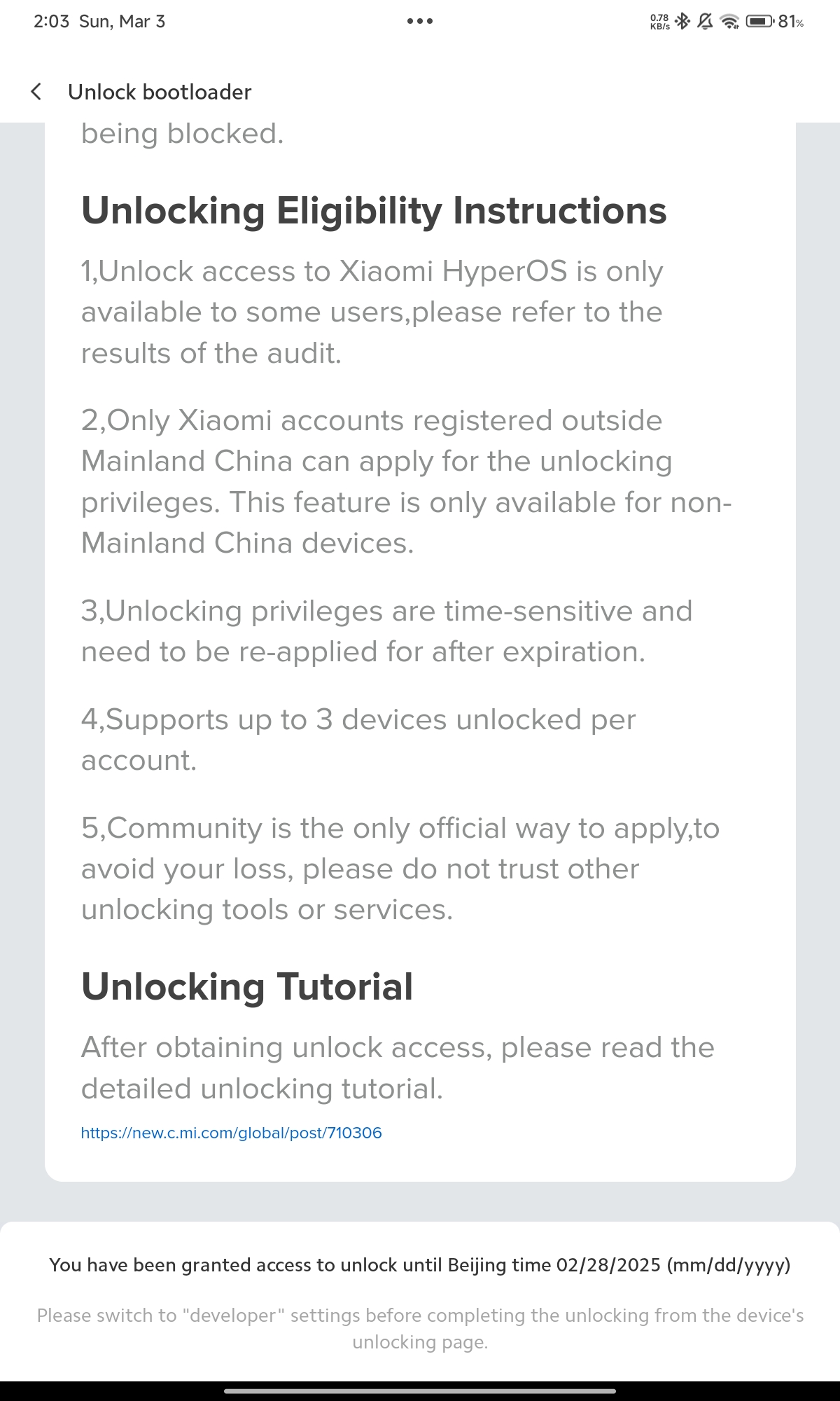

Because that's what the instructions say to do. Here is a screenshot and the url to the instructions.

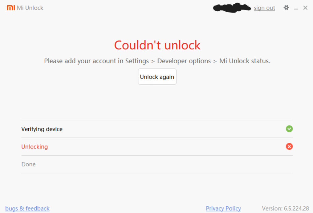

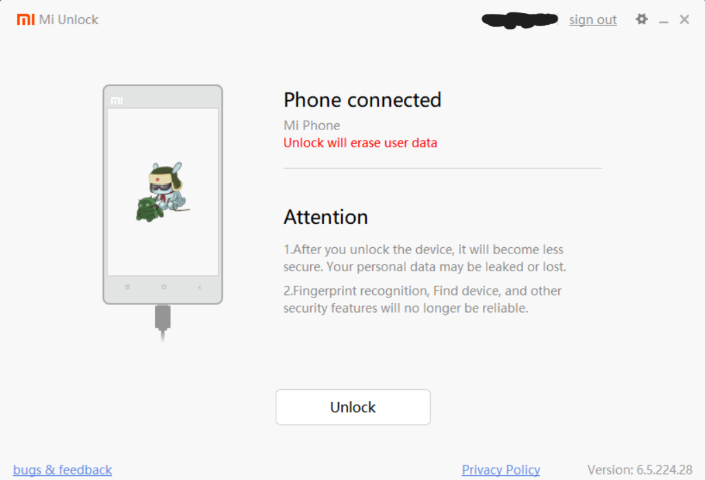

Let's take it from the top on what steps i took until this point:
1. Apply for authorization from the Xiaomi Community App with the same account that i was using on my tablet and get approved.
2. Follow the guide on what to do after that (which is the same as when unlocking on MIUI)
3. Reach the point where i have to bind my account from the developer options (I get "Couldn't add. Please go to MI Community for authorization and try again")
4. Try to use the unlock tool from xiaomi to see what it says (i attached screenshots of the result)
P.S. The account (the one i use with the tablet) is definetlly older than 30 days as i made it when i bought the device which was on Christmas.
So what gives?

If you use newer version of Mi Unlock tool, do you see this?
"This device is not activated, please activate it and try to unlock it again"
Than I think you have the problem many other users report aswell on reddit, XDA etc. For some it works after 7-10 days, for others it doesn't work for months.
I have the same problem. On friday the 72 hours countdown was over but unlock didn't work. I got this error. Today the Unlock tool suddenly says 32 hours to wait. Hope it will work tomorrow.
