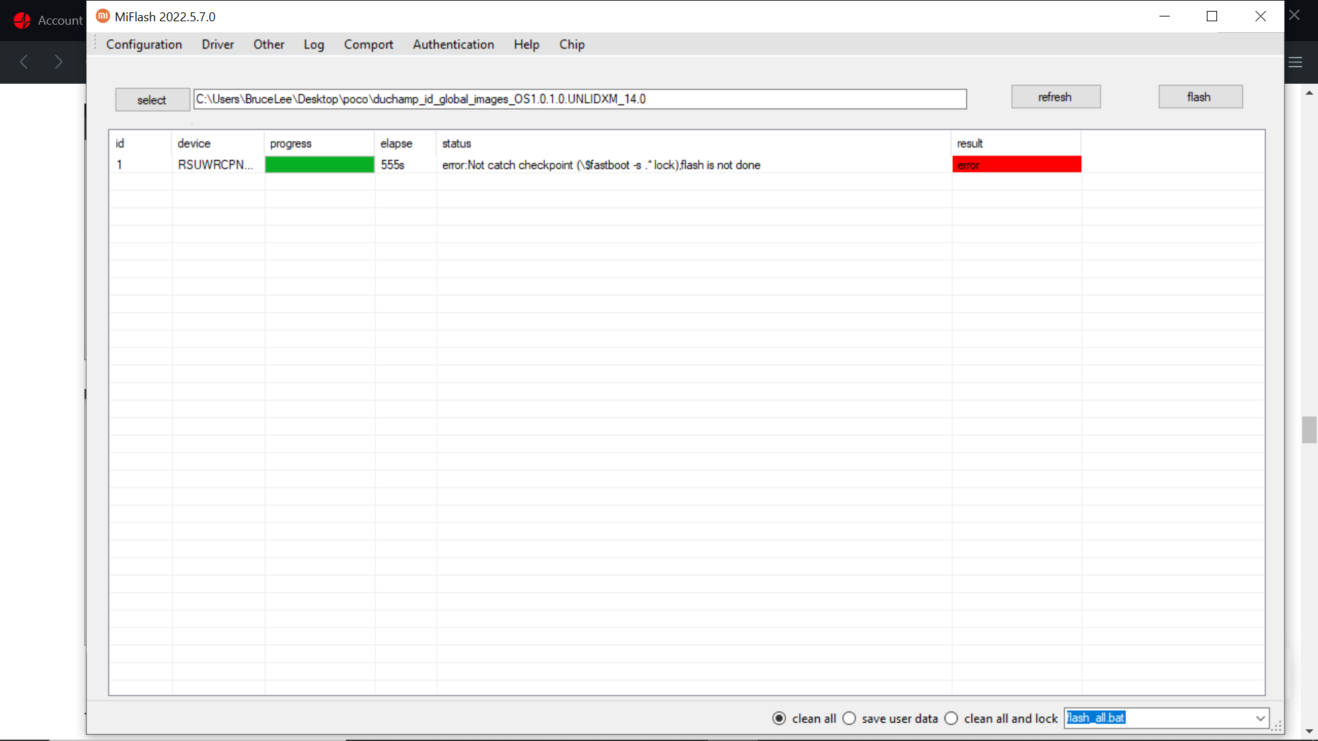

here I installed the Indonesia rom!!!
now i have call recording! and so far everything looks fine!?
I downloaded the rom from https://miuirom.org/phones/poco-x6-pro-5g#Indonesia
i installed it with mi flash https://miuirom.org/updates/mi-flash-pro
I got an error at the end, the mobile phone restarted itself and when it started everything looked fine!? I didn't do anything anymore,
I set Indonesia region, and croatia language, and that's it, everything looks good for now...

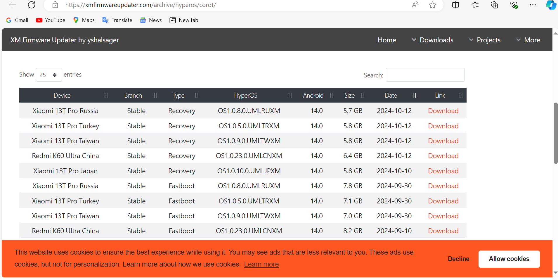

does it have the same result with both methods? I want to do it with the simpler one so that I don't have a problem with the stepsYou choose recovery ROM if you install with TWRP or Fastboot if want to install withMi flash tool
from what they told me if I do it with fastboot I have to use mi flash. which rom should i download?? the global or Indonesia. because I want to have the Greek with the recording. I entered here but I don't know which one to use https://miuirom.org/phones/poco-x6-pro-5g#IndonesiaRecovery rom for an update and Fastboot rom for a change of region.
In the past, when we did the same process, everyone told me to use the global one. to make sure it's good and will have the recording. should i not use it?does it have all the languages?On certain devices with hyperOS Indonesian rom, the call recorder has been removed but is still present with Taiwanese.
Version1.0.5.0.UNLTWXM with Miflash.
Only Taiwanese and Indonesian rom have the MIUI dialer, the others have the Google dialer.In the past, when we did the same process, everyone told me to use the global one. to make sure it's good and will have the recording. should i not use it?does it have all the languages?
I hope I can find the Greek mediaOnly Taiwanese and Indonesian rom have the MIUI dialer, the others have the Google dialer.
after downloading the fastboot rom what do we do? what are the next steps?Only Taiwanese and Indonesian rom have the MIUI dialer, the others have the Google dialer.
I suppose that you can change to any language without any problem, better install the Taiwan ROM cause I ve seen in some forums that people prefer it over the Indonesian.Dont forget to decompress the ROM file you download before installing
