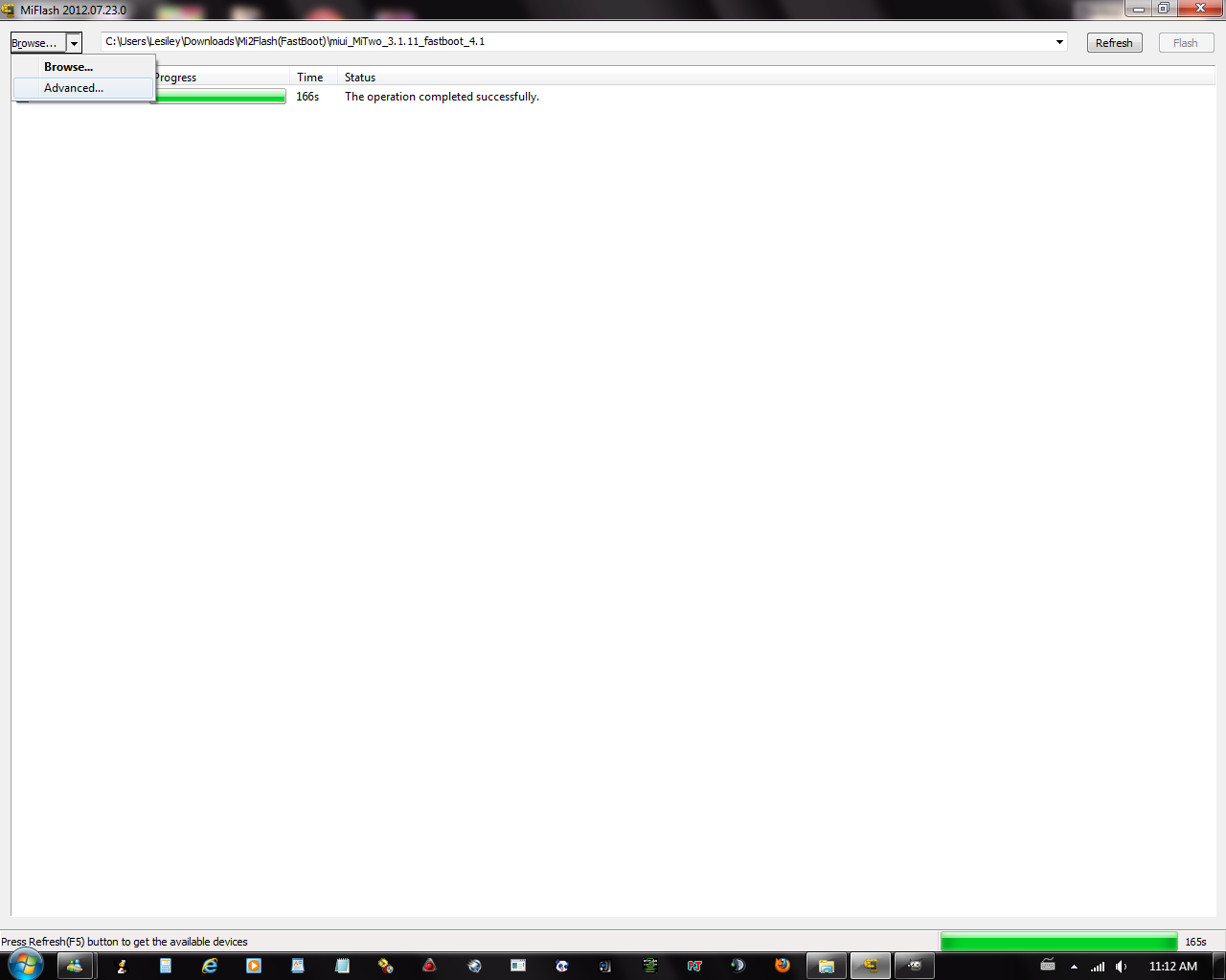

Perhaps it's useful to note down in your guide how to make MiFlash restore the partition table as well?
By default, MiFlash just formats the partitions and flashes everything again (radio, recovery, rom, ...). If your partition table is somehow ****ed up, MiFlash will fail to recover your phone, unless you put your phone in "dload" mode. To do so, boot into fastboot mode, then in CMD type "fastboot reboot dload". Now, MiFlash will recognize your device differently and will restore the partition table as well. (Your device will show up as unrecognized under Windows, don't worry about that. MiFlash will be able to communicate with it when it shows up in the list).
This saved my device after the script to change the partition table failed, leaving my device without system partitions.
I'm glad I could help. When my device was ****ed up, pretty much nobody was able to help me out. I'm glad I found a way to restore my device, and I'm happy to share that method.you saved my day.
this was exactly what I was looking for.
thanks mate!
