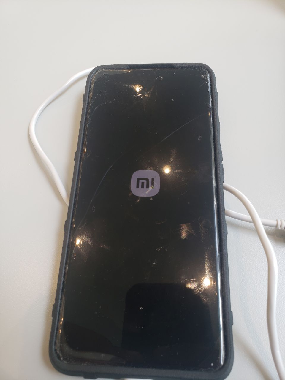

This case is hard to identify for me as this happened during watching YouTube (no updates, no interference in system files, nothing). I was just using my phone as usual, and it randomly turned itself off. Now I have no option to do anything. In a boot loop, there are no signs of loading the system or anything. It stays on the Mi logo for quite a while and then restarts itself.

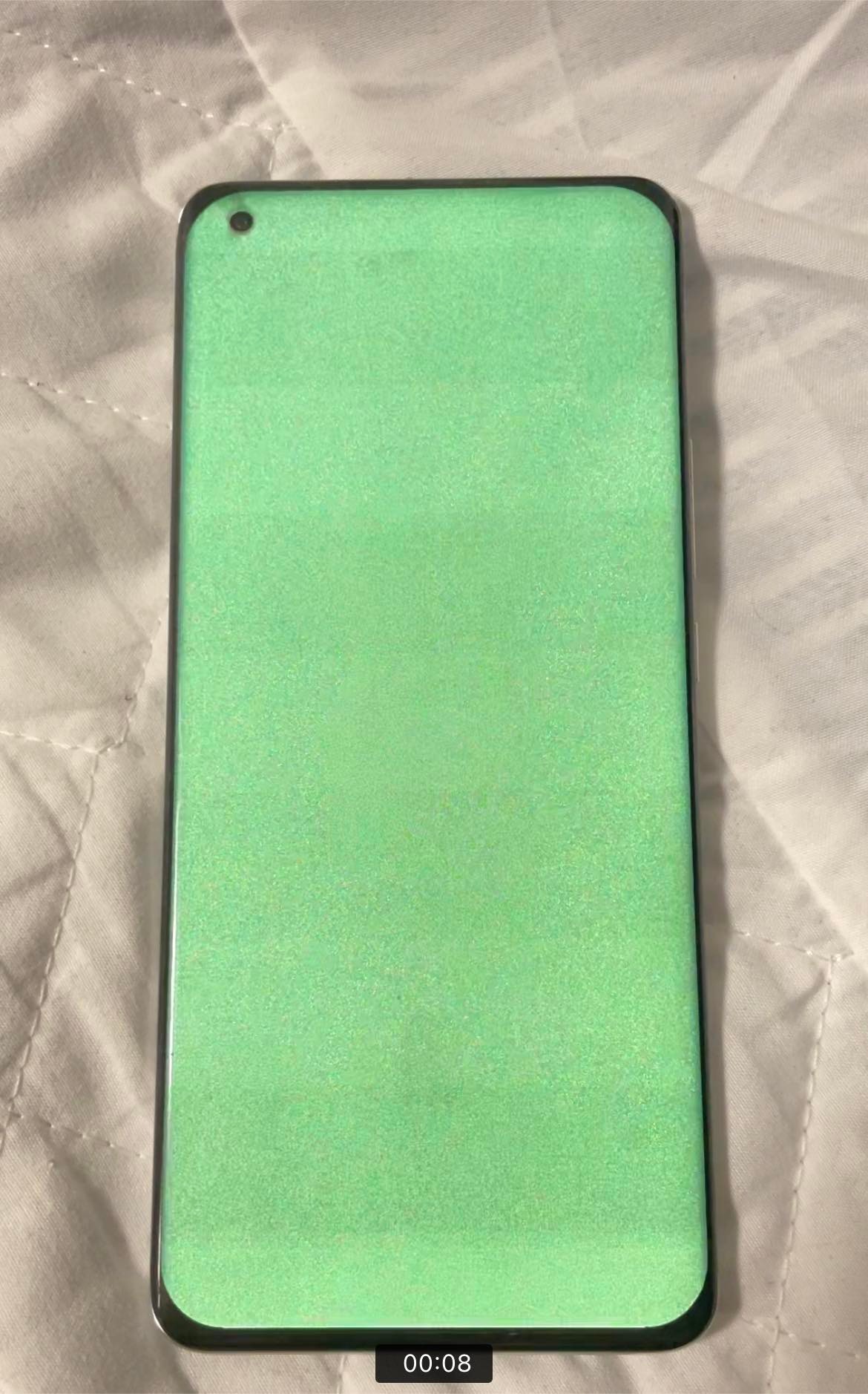

Every single time, no matter if it's on the Mi logo, in TWRP, or literally anywhere, the moment that when the phone crashes (restarts) whole screen blinks with a glitchy green pattern, for literally a split second. I'll attach the photo.

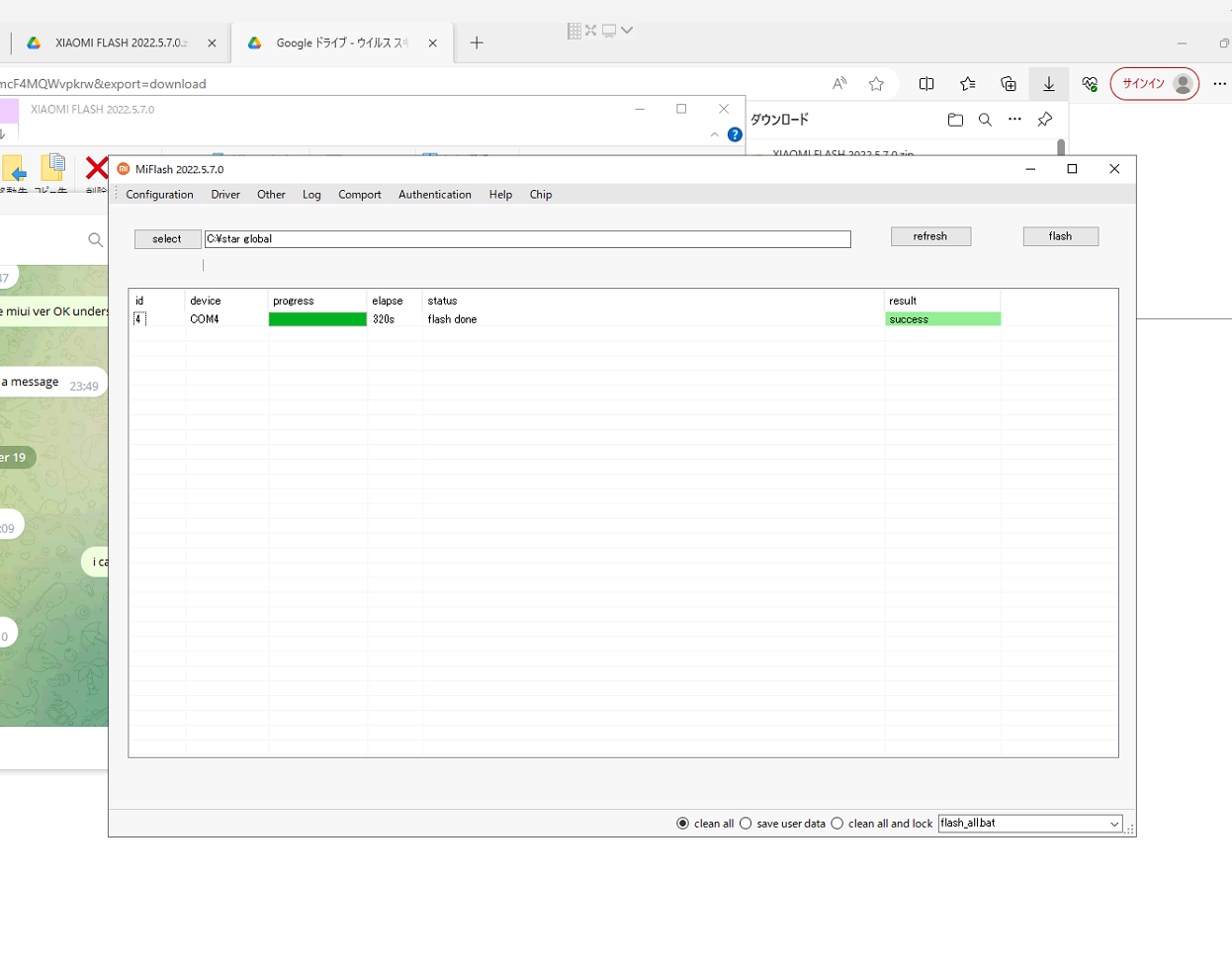

My mi 11 ultra was bricked it was completely dead and only detects to pc as edl mode.. i tried all over the internet to flash it . finally one person i met in telegram fixed my mi 11 ultra now it is back in life again . telegram username:- @@xiaomiauthorizedflashing
