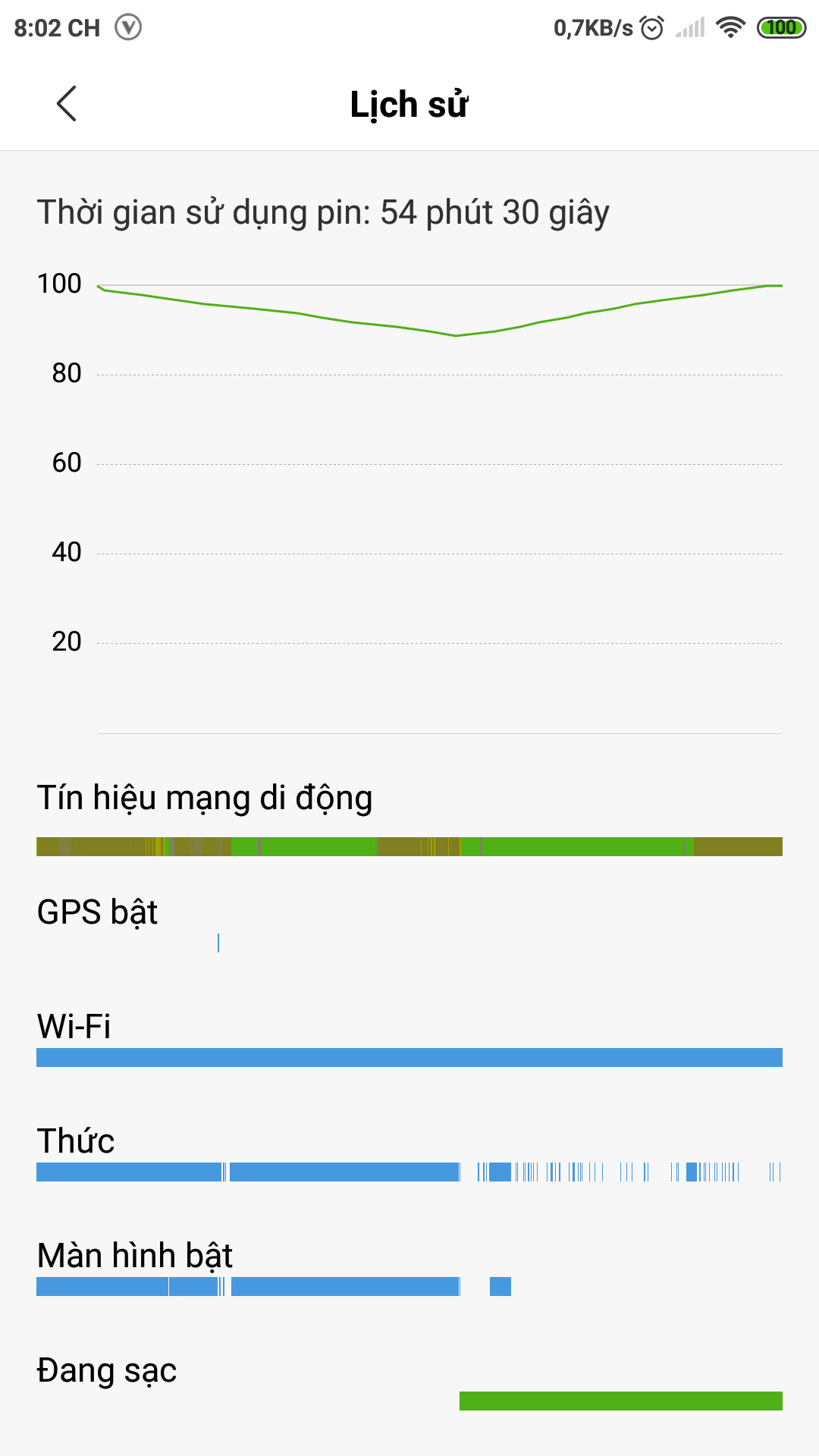

Miui 10.2 no deep sleep when I charged the device
Generate a bugreport, download the zip from the phone to a PC, open Battery Historian https://bathist.ef.lc or https://historian.ivkos.com/ on a PC browser and upload your bugreport, analyse the diagram, look for kernel wakelocks, userspace wakelocks, top apps, foreground apps.. etc.. Probably sounds difficult but trust me it is not.

What kind of modifications did you make on the ROM? Any flashed mods or Magisk moduls in use?
When detach the charger.. is your CPU stuck at 1.6GHz? Is it enabling VDD restriction by itself?
Hope this helps..
Hope this helps..
Thanks but it no stuck 1.6ghz .
So yes, it is not stuck, great news. VDD is just one kind of problem.
Then check the other 4 things because your phone is actually awake a lot of times..
