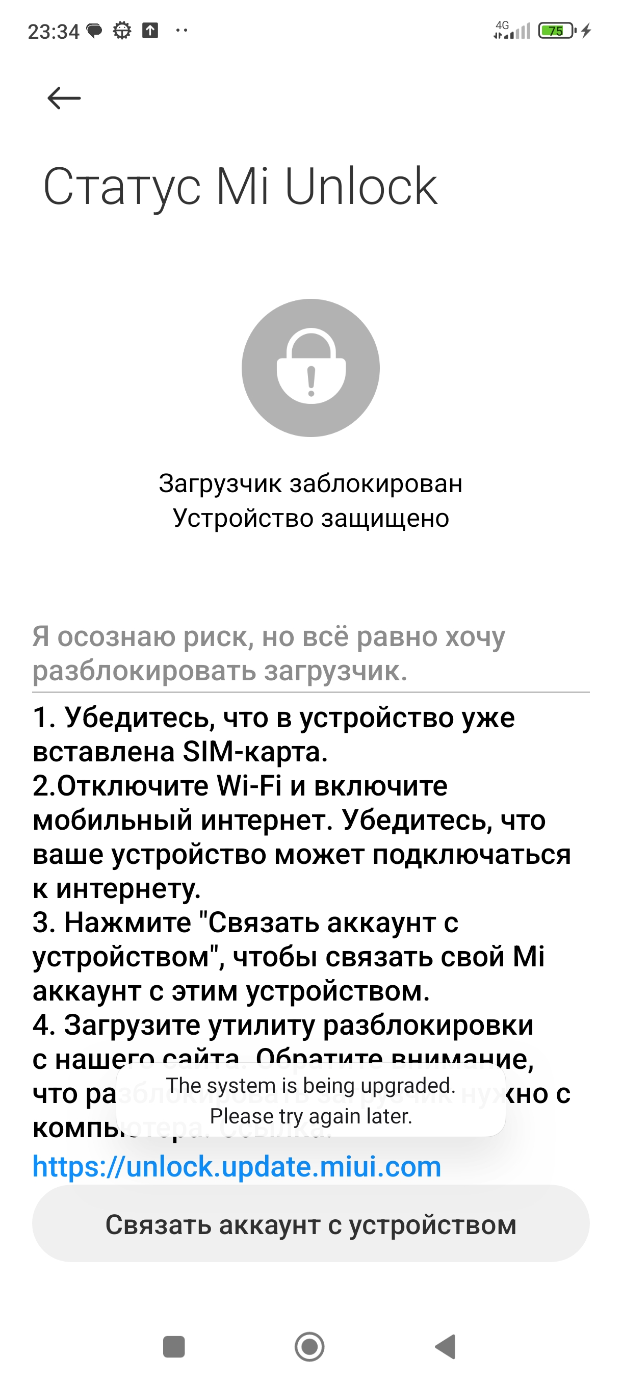

Not allow to unlock Bootloader of Note 13 Pro+
P is me
Nov 9, 2019
28
Note 13 pro+ miui 14.08 still not allow to determine account say the system is being upgraded please try again later, so cant unlock the bootloader, any solution other way to paid? thanks
Not enough detail about your problem, but, if you update the system after applying for a bootloader unlock the timer in the Mi Unlock Tool will double or at least increase.
Unlocking the bootloader of the redmi note 13 pro Chinese version is not possible since Xiaomi does not allow it. I have looked for quite a few alternative methods to unlock it and the only option I see possible is to wait for hyper os to come out and try to unlock it somehow there
If it is the Chinese version then Xiaomi has recently restricted access to bootloader unlocking under a much stricter policy (require you to have a certain level in the Xiaomi community app and pass a quiz). Usual method had probably stopped working for quite a long time.
I think I found solution. You have to perform all steps like for HyperOS, propably for any Redmi Note 13 series. You have to apply for unlocking in Xiaomi Community app (version minimum 5.3.31). If it says that limit has been reached, try again next day at midnight at local time for Beijin, China. It worked for me. Cheers

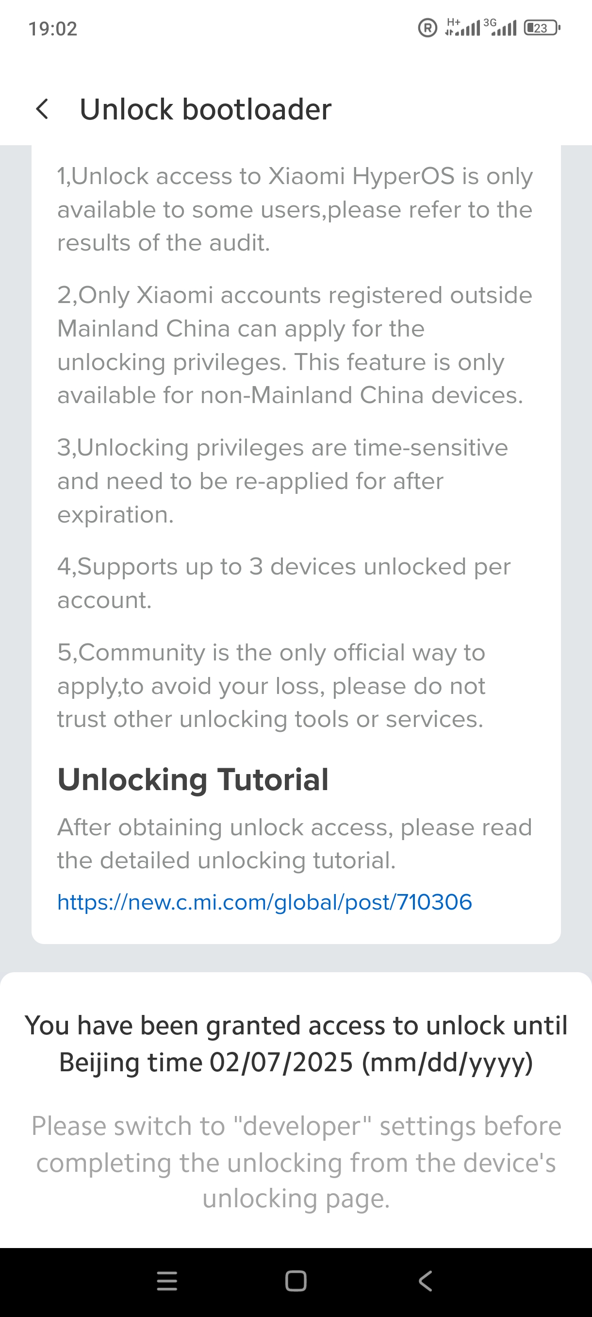

Ok, so i installed Xiaomi community and requested unlocking. I recieved the following message. What then?.

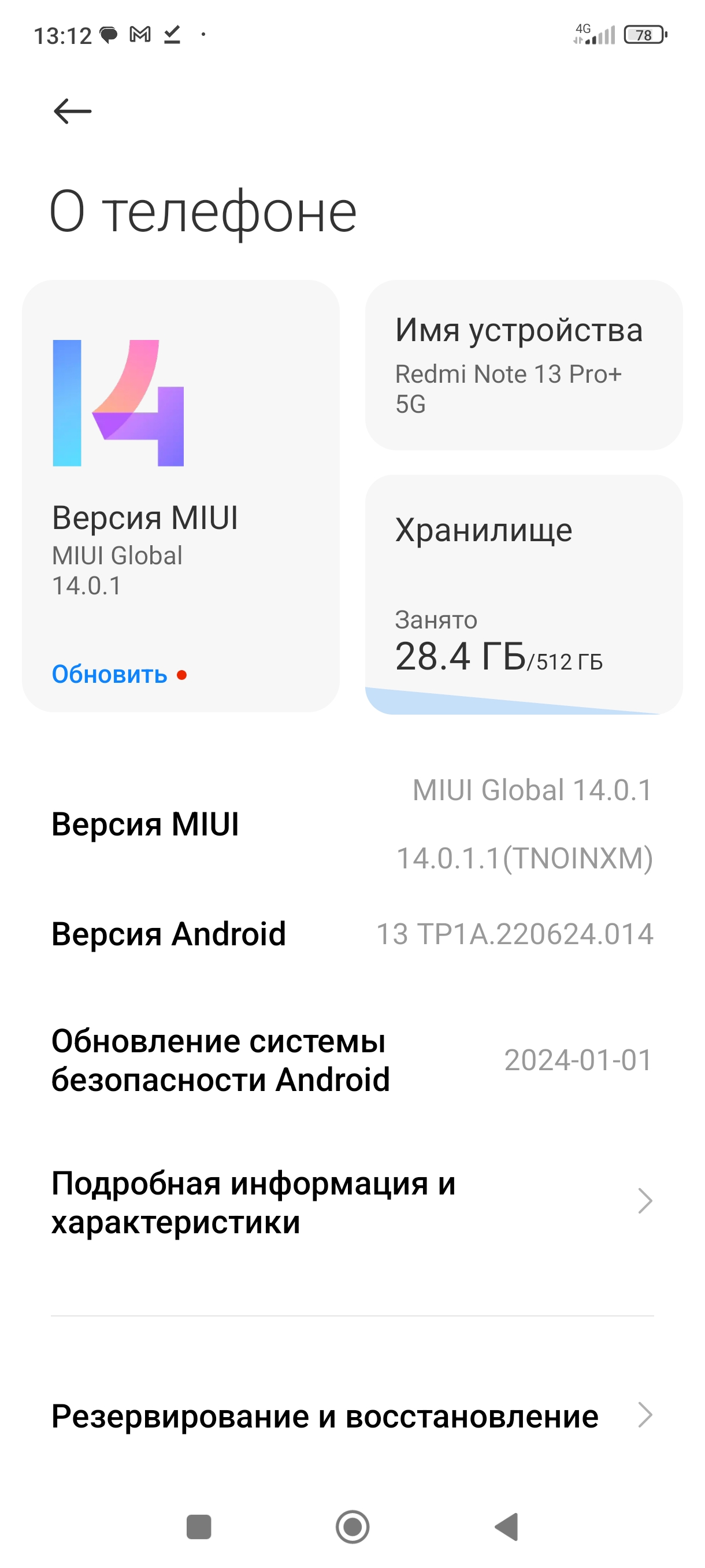

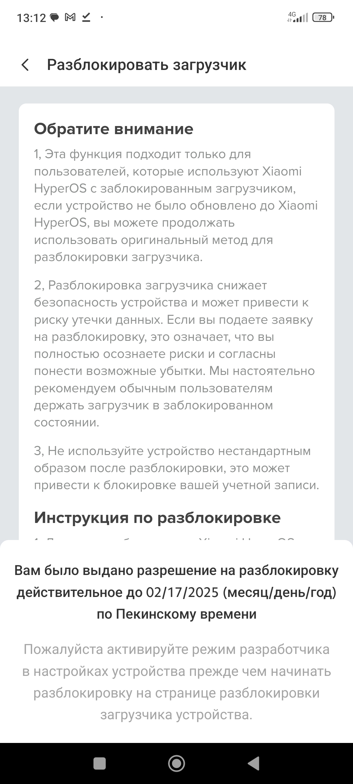

good afternoon
I have the next problem that advise
indian version
