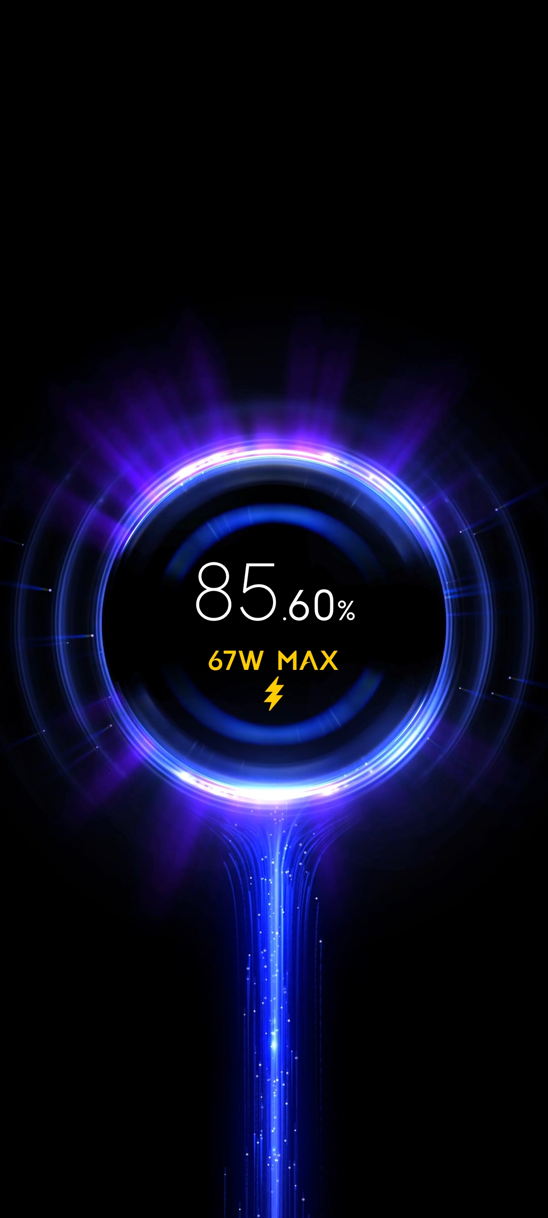

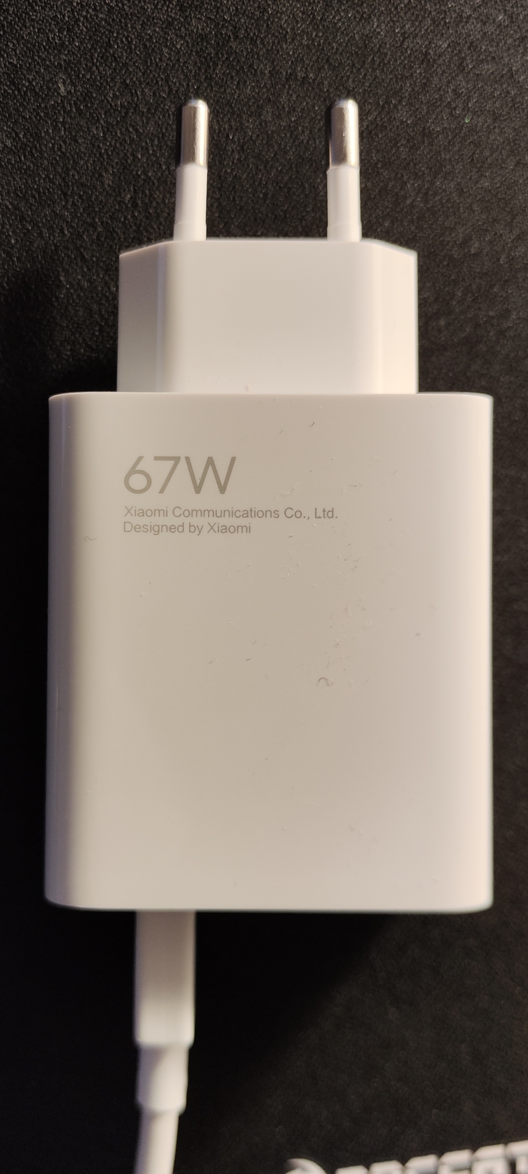

I can confirm after some long trips that using a good quality cable, the Android Auto worked without any issue.
I tested other cables, rated 5A and 6A from Xiaomi, one o them is rated to be used for Xiaomi Mi 11 series.
You can test the cable at home to see if the quick charge is enabled at full speed when it is used to charge the phone using the original Xiaomi 12 charger (67W)
