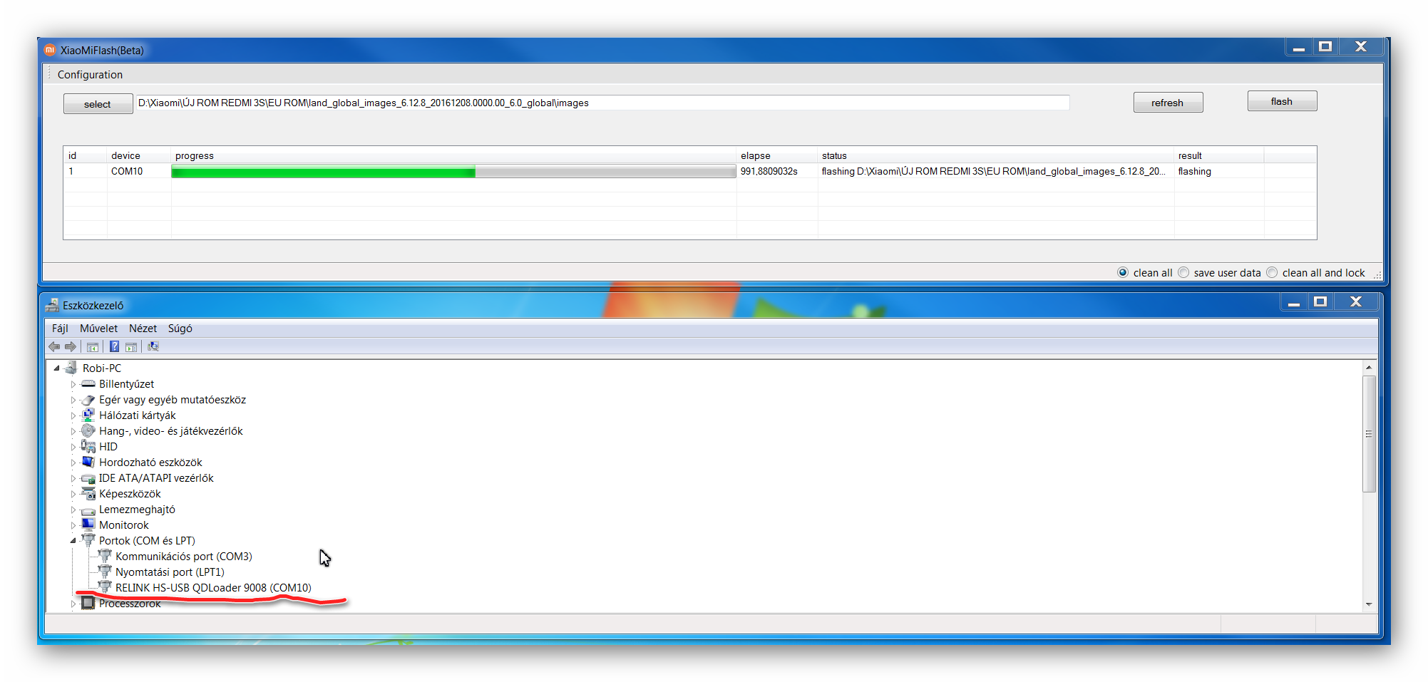

I use this simple beta version with this rom and flash is ok!But flash time is very long around 1:20h !!!!
tray to change usb port and cable!

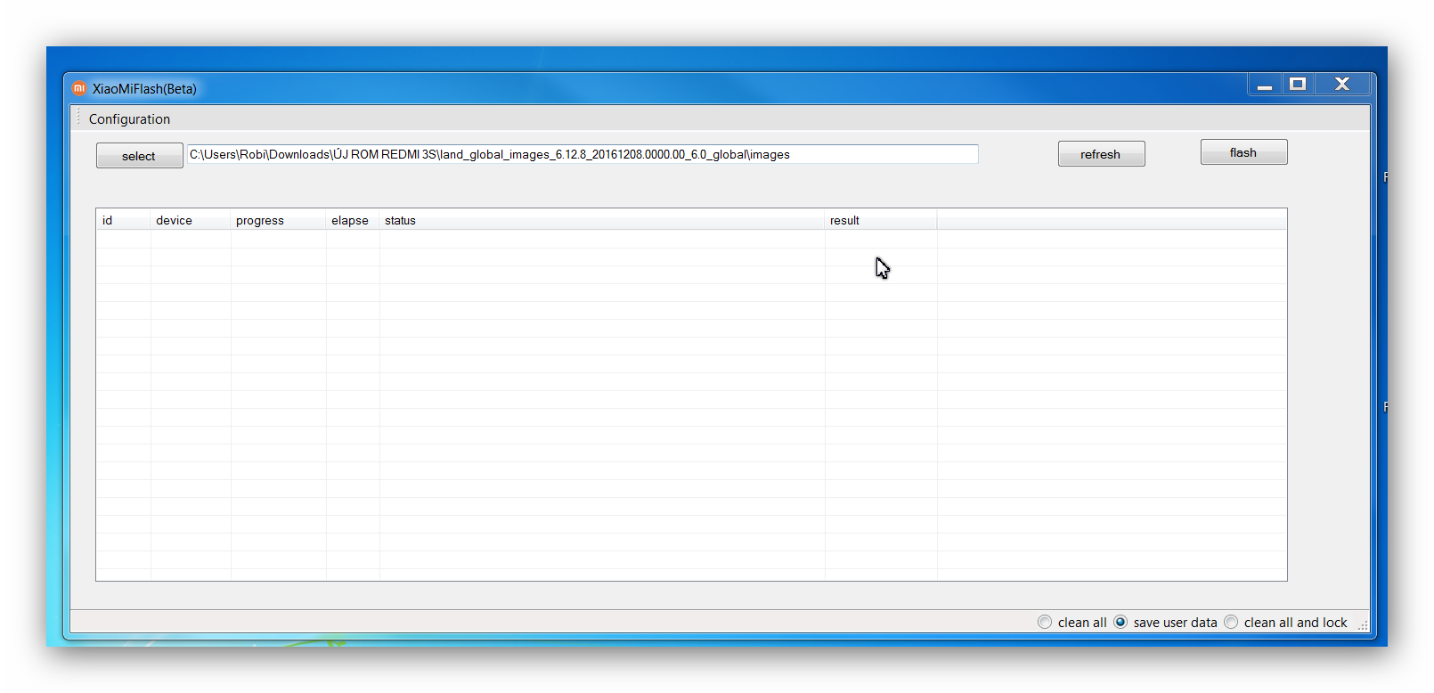

Hi Helge,
As you are in EDL mode
You need to set the device tree to the flashable image:see Fastboot.jpg
Keep device tree as short as possible, miflash does not like long devive trees.

Well, I finally managed to get my phone in qualcomm qdloader 9008 state.
Somehow that seems like a good thing. So It is now visible in miflash but when trying to flash it says: cannot receive hello packet....
I have tried several stable roms.
Any idea how I can get past this ?
OK, i think it's flashing now. What worked for me, deconnect the battery for 10 sec and then connect again. Put in the USB cable in the phone, connect the testpoints and while keeping them connected, put the usb cable in the computer. The redmi is now in qdloader 9000.
Then used my homemade deepflash cable and connect green and black. Nothing hapened with that. The use 2015 miflash and flash V8.2.4.0 MALMIDL. Miflash says device is busy (for 4097 sec now) and progress indicator is doiing nothing. I just wait and see. Looks promissing.
It is more lifely then i have seen it in a few weeks.
