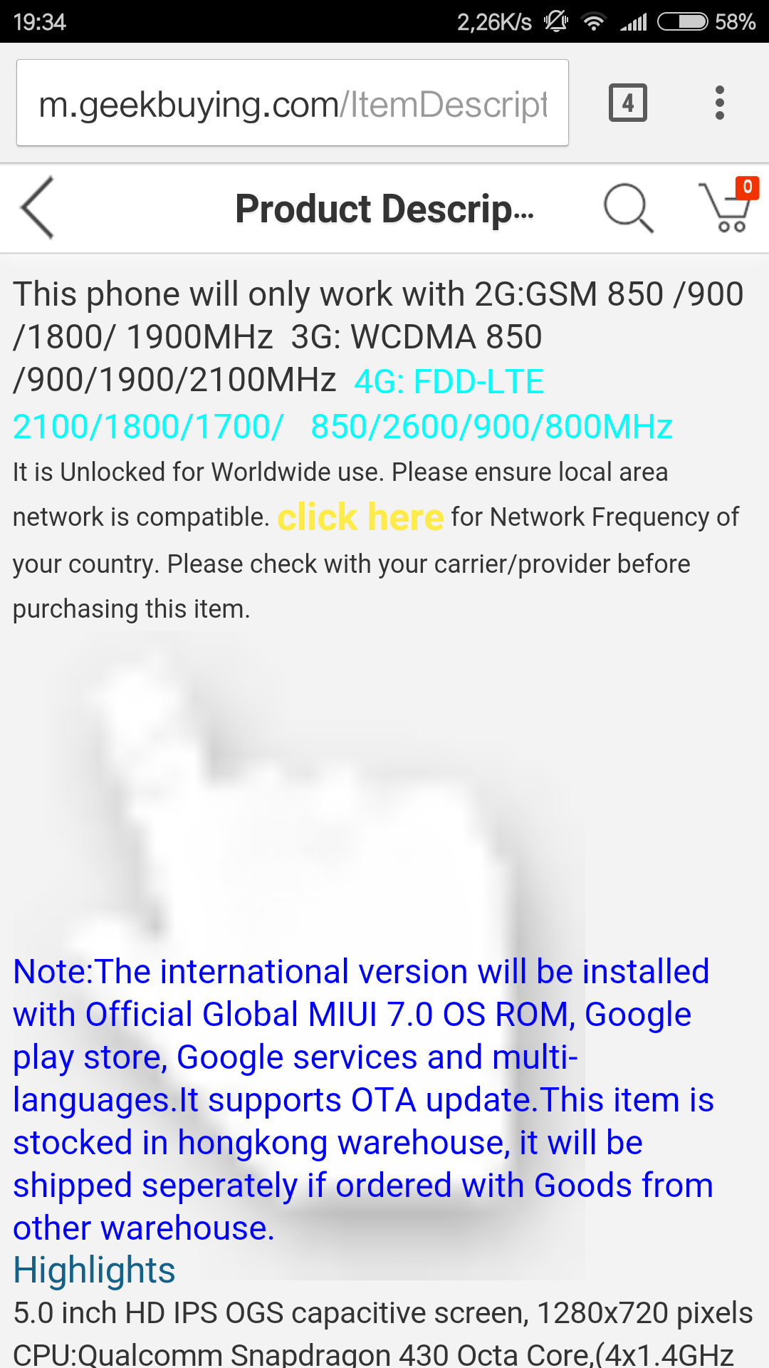

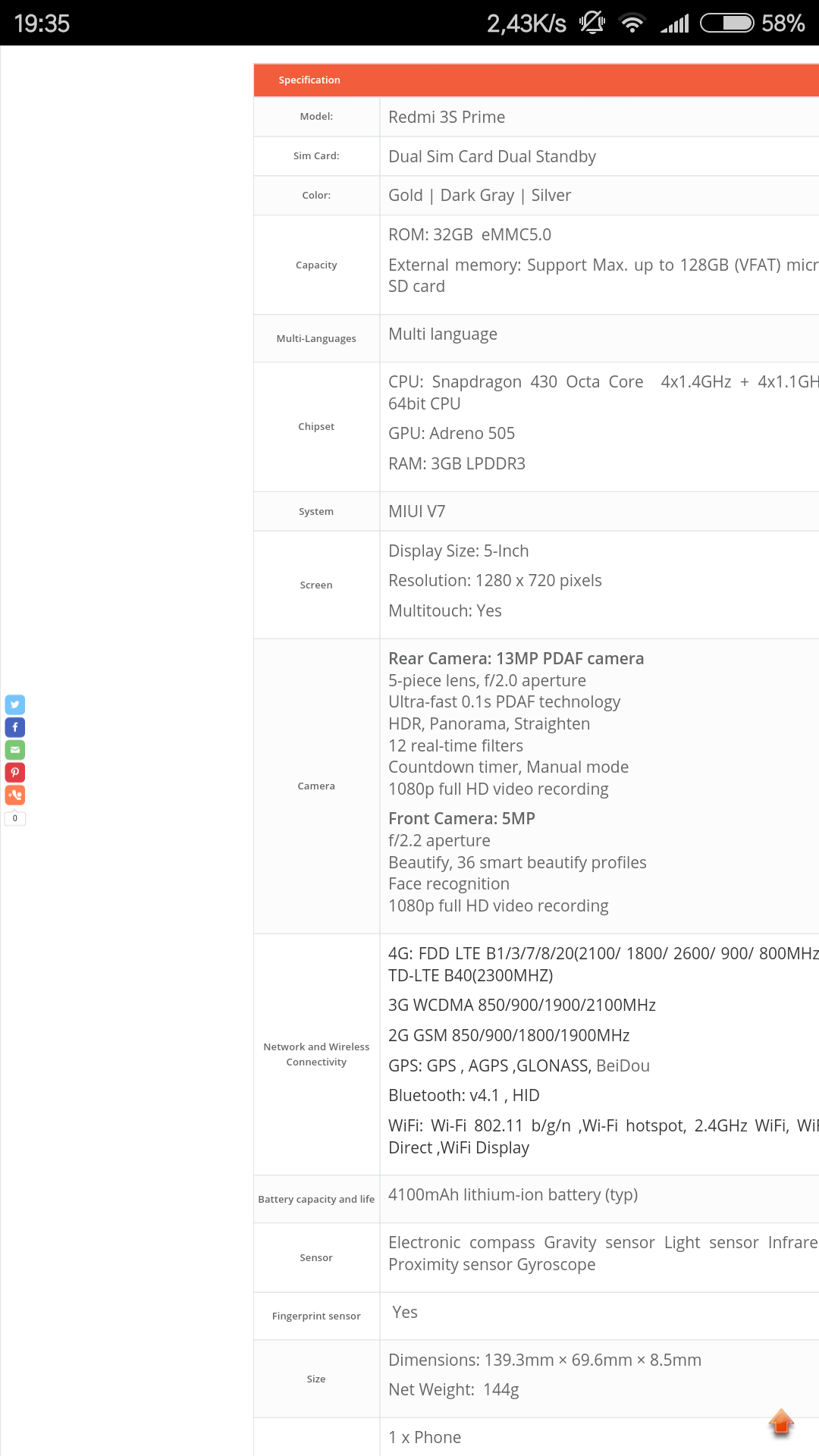

I don't know how they did it but it works. A guy in the german Chinamobile forum confirmed it with a R3s from geekbuying. The phone has an independent modelnumber and a different box.

This version of redmi 3s comes with official miui globle rom(with ota) , but there is no other device as land.

The standard 3s is 2016030 the B20 version is 2016031. This is easy to determine from the phone box. But it could be that the version is modified too.
